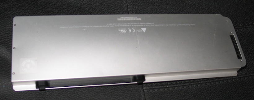

Here are pics of my own battery:
It's hard to photograph, but here is my attempt. It's relatively subtle, not one of those obviously swollen batteries we've all seen photographs of. Here it is:
Here is the battery photographed from above. Nothing unusual is apparent.
Here is the battery straight on. Notice that the bottom of the battery is up. Again nothing very unusual here.

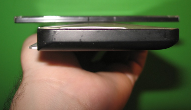

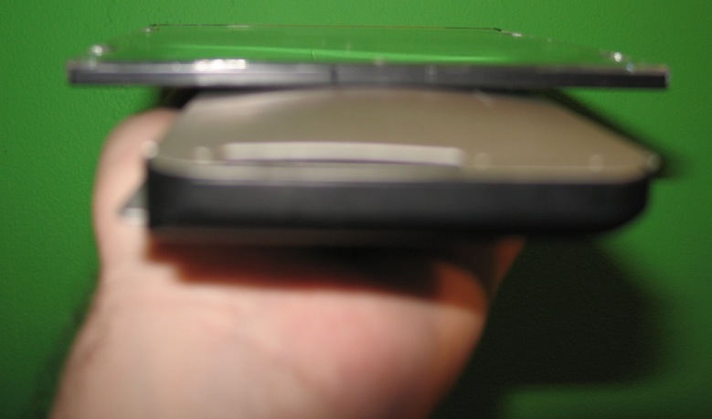

Now I attempt to photograph the battery with a flat CD case on top. Notice how it does not lie flat.
Another photo from a slightly different angle. Although it is unfocused, it is clear that the top of the battery is not flat.
