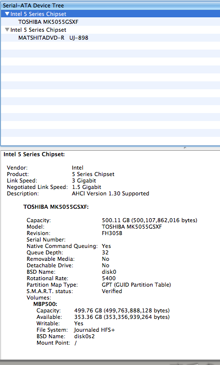

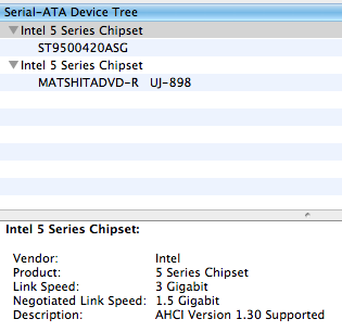

Just received my CTO 15 i7 500gb 7200rpm and guess what? Apple is still CAPPING the SATA 3Gbps chipset at 1.5?! (see pic below, notice "Negotiated Link Speed") Is this barrier removed if you put in a SSD? I'm still on the fence on placing an order for an Intel 160gb SSD...

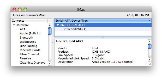

Doesn't this just mean, the interface negotiated with the HDD, that S-ATA 1.5Gbps would suffice?
My 2007 Aluminium iMac shows this:
I'm confused, but the 1.5Gbps are still more than efficient with its 148MB/s

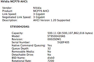

Could be as my iMac's HD is 3Gb/s but SuperDrive is 1.5Gb/s (link is 3Gb but negotiated is 1.5Gb). Both use NVidia MCP79 AHCI chip

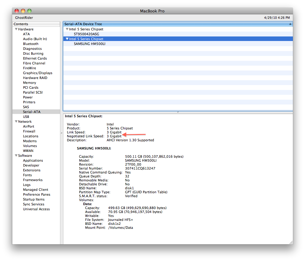

The chipset is fine - it's the drives they are shipping that negotiates the 1.5Gbps link speed. Look at mine with a Samsung 3.0Gbps drive. My Seagate 7200K 500 is only 1.5...
The 2.5" drive is not fast enough to max out the 1.5 so I'm OK with the shipping drive not being 3.0.

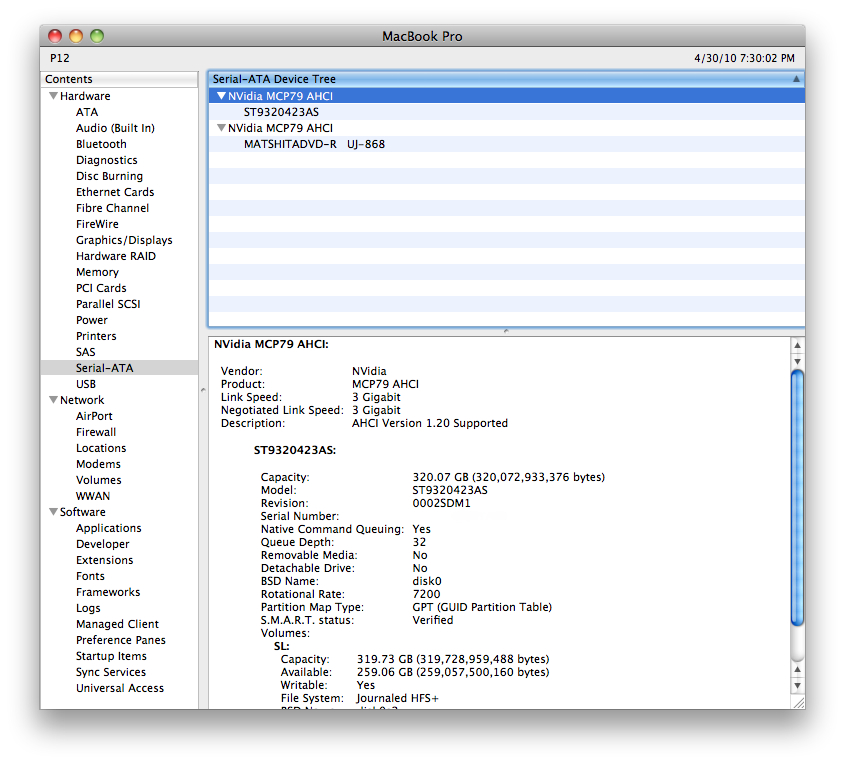

My 320GB 7.2K RPM Seagate drive shows this...granted my MBP is an early 09 model so this probably doesn't help you. Like others have said the drive will never saturate the bus so its all good anyway.

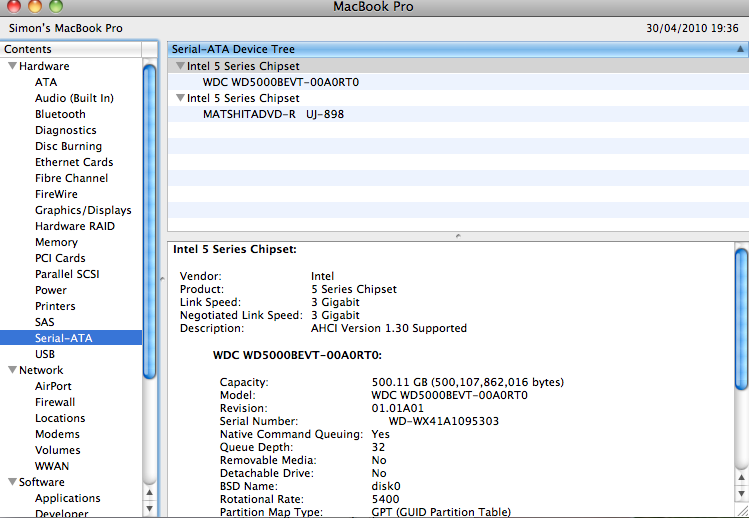

Mine is 3 gigabits negotiated on an i5 2.4 mid 2010.

What Id like to know, straight from Toshiba's website:
Further design optimizations boost the durability of the MKxx55GSX line-up, providing industry-leading robustness against shock while the drives are in operation. An operational free-fall sensor (FFS) feature further protects the drive and user data against potential damage from shock, vibration and rough handling. The MKxx55GSX products support a 3 Gb/sec data transfer rate and have passed testing by the Serial ATA International Organization (SATA-IO) for SATA interoperability.
WTF
It doesn't matter; if you're drive needs SATA 3Gb/s it will negotiate it.
Youre right it doesnt matter, but if the drive is SATA30 and the computer is, it should be so, period. Im wondering if Apple has a custom firmware on the Toshiba.

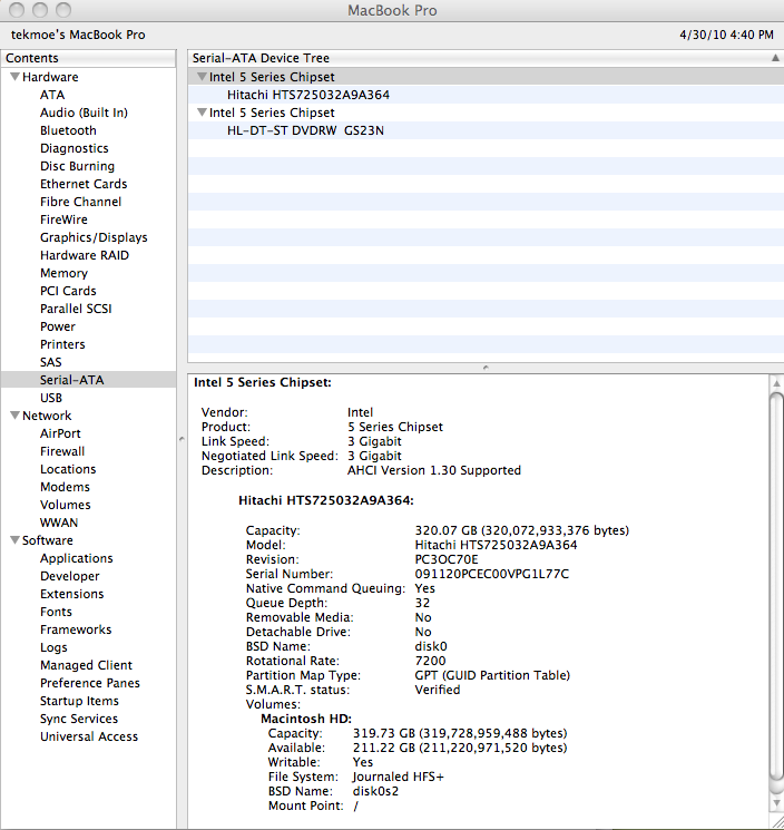

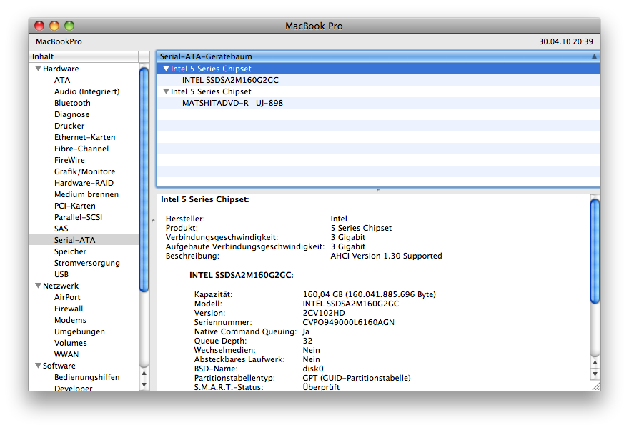

i'm showing 3.0. i swapped the stock 5400rpm drive with a new hitachi 320gb 7200rpm drive and converted the stock drive to a time machine backup disk. 😀

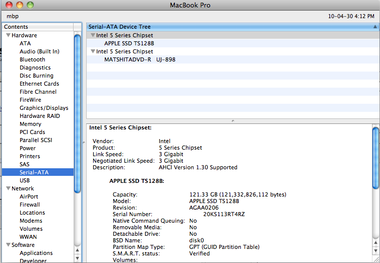

My SSD shows 3. However, the super drive is 1.5
but what ever...my superdrive will never use up that 1.5G...lol
btw...I have the 2010 MPB i7. 15"
the link speed is the bandwidth limit of the actual connection
the negotiated speed is the actual connection speed and determined by the attached drive.
Most 5400 and even some 7200 will connect at 1.5 while SSD drives will typically connect at 3.0
So to make it even more clear, if your negotiated connection says 1.5 but you later replace that drive with say an SSD that connects at 3.0 than your negotiated speed with say 3.0
So to make it even more clear, if your negotiated connection says 1.5 but you later replace that drive with say an SSD that connects at 3.0 than your negotiated speed with be 3.0
Exactly. No issues here.
/Thread

I use multiple VMs in Virtualbox and went with a ST9500420AS 7200 RPM drive and made sure it was a SATA 3 GB drive. I'm kind of shocked Apple would ship a new MBP with a 1.5 GB drive. 😱
Like I said, I'm doing multi-vms so I'm trying to push the drive as hard as I can...
