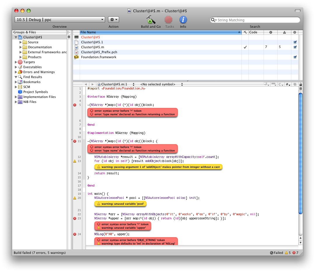

That code returns me several Syntax errors.
I've had enough of your BS.

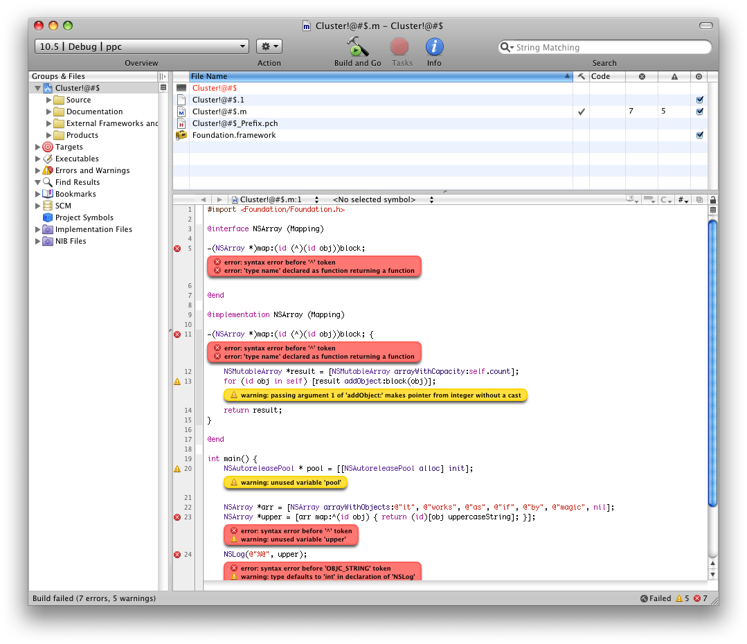

That code returns me Syntax error.
It only works on Snow Leopard. As I mentioned (and is mention in the article I referred you to) it is supported by the current version of objective C. Try compiling against 10.6.

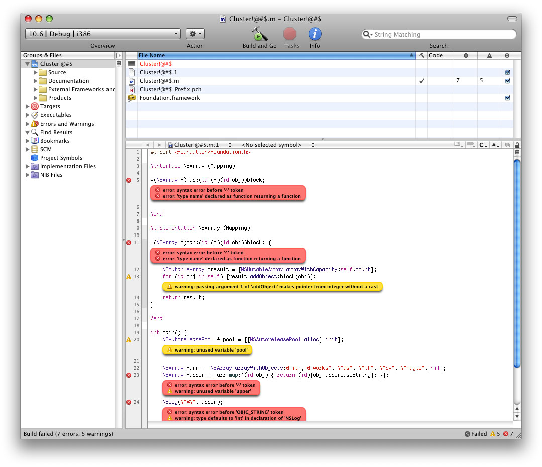

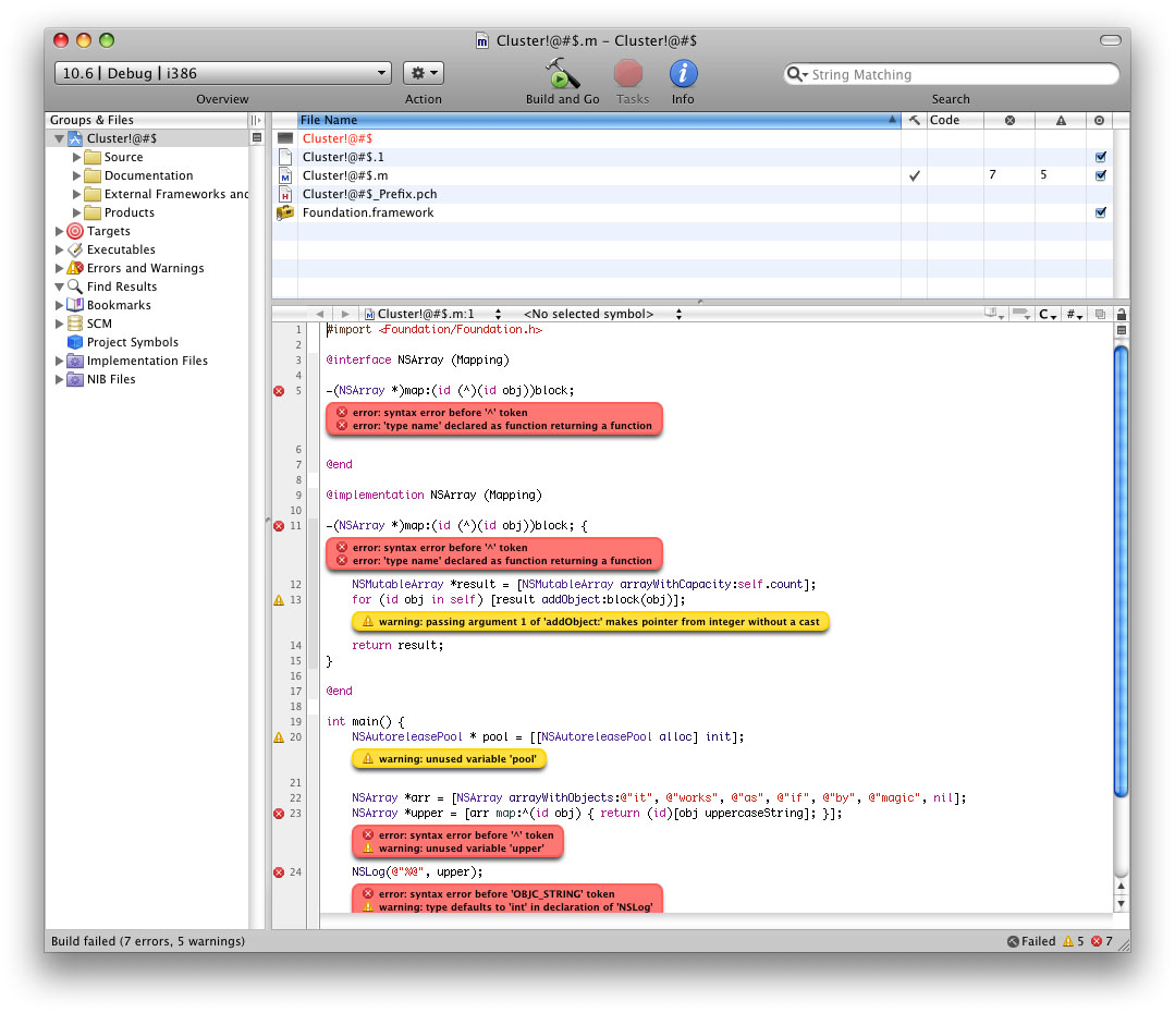

EDIT: Still errors

I'll give you that. It is actually a feature of Clang. Nevertheless, it works on Snow Leopard.

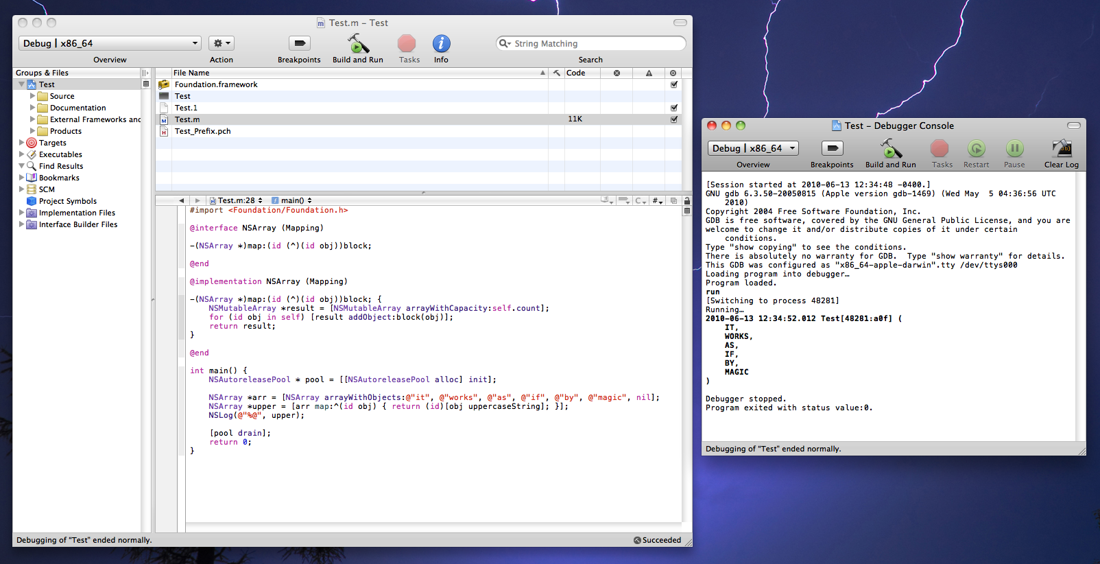

It works here against 10.6 | Debug | x86_64 on Snow Leopard
