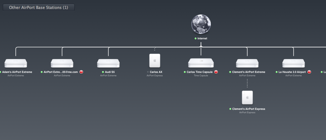

Just bought an Airport Extreme Base Station router and I LOVE IT!! But one thing....I live in a apartment. I plug my ethernet cable to the wall and when I open Airport Utility and shows every one else that have an Appple Router, I can see peoples music library in i tunes and stuff.....I don't want that. My old Cisco router didn't do that. Please Help .TY

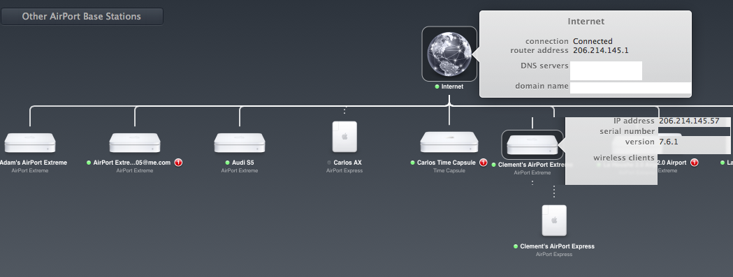

Can you tell what IP addresses are being used by your client, the private (LAN) side of your Airport and the public (WAN) side?

You left out the most important bit. The client's computer's IP.
If that is a 206.214.145.XXX address your Airport Extreme isn't routing. The clients and Airports are all getting public IP addresses.
Private IP addresses should be of the form 192.168.XXX.YYY or 10.XXX.YYY.ZZZ.

You didn't answer the question. Is the IP given to your computer from your Wireless a 206.214.145.XXX address?
You need to give us a whole lot more info.
Also if you see Off (Bridge Mode) on the network tab that means that routing is off you are in bridge mode. Not that Bridge Mode is Off. You want that to say "DHCP and NAT".

So I selected Bridge DHCP and NAT and now it seems to be good!! Is that How I should have it set up? What does the rest of the config mean? TY
