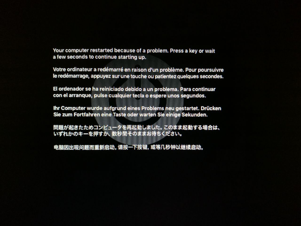

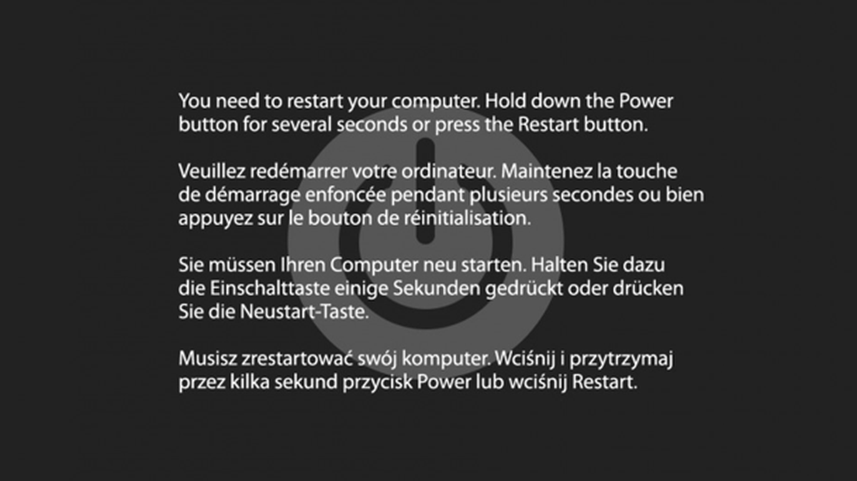

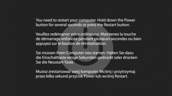

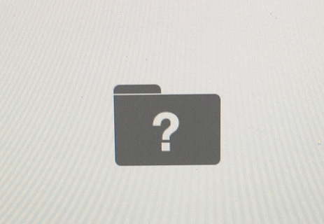

The battery on my 2015 15" MBPr was on its last leg so I took it in to get a new replacement. Whenever I disconnect the power cable and other times just randomly, my entire MBP freezes. Even the Finder. Pretty much every hour. I just leave it hanging and after about a minute it reboots itself with the all familiar messages as seen in my screenshots.
One time I had the folder with a question mark so I made sure everything was backed up once I got it into Safe Mode. I reset PRAM etc. I could reinstall the OS but that shouldn't make a difference. Either your OS is working or it's not. Either there is something wrong with the battery/disk or there isn't. I did a repair from the macOS utility but everything was fine.
I'm going to bring it in AGAIN so they can look at it, but in the meantime what do you think it is?

Damn it came back. So weird. Looks like I'm going to have to bring it back to the Apple store idiot geniuses.
The first two are a kernel panic.
The flashing question mark means: no valid OS found.
Both could be storage related.
KP in particular can be be either hardware (often RAM related), or software...third party kernel extensions.
You might try running in Safe Mode, to test. If you still see a KP in Safe Mode...could point at hardware, not software.
Yup, I know what they mean but not why they're happening.
I was in SafeMode before, but didn't find any issues. Mind you, can't stay in SafeMode for a long time.

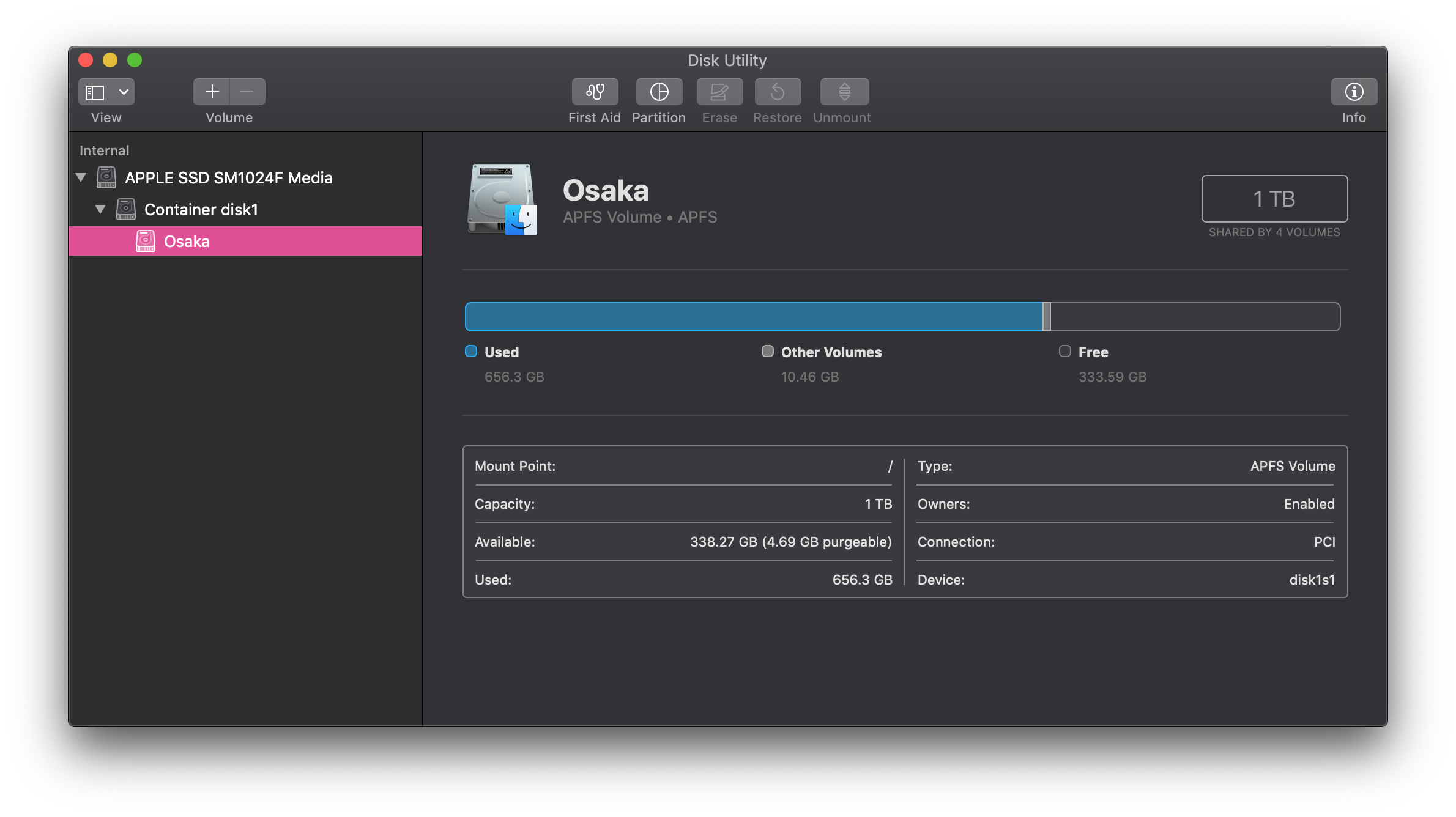

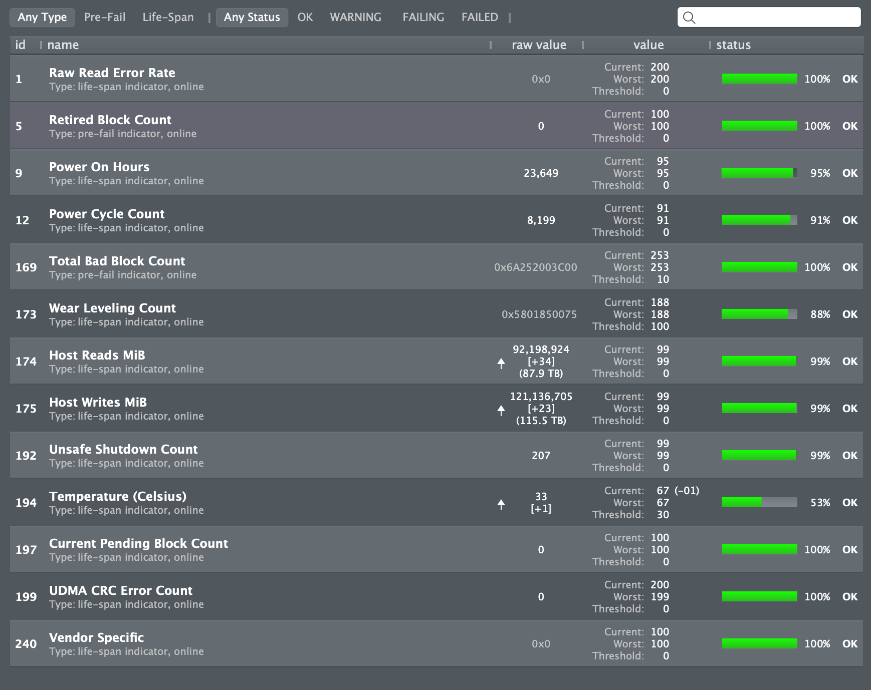

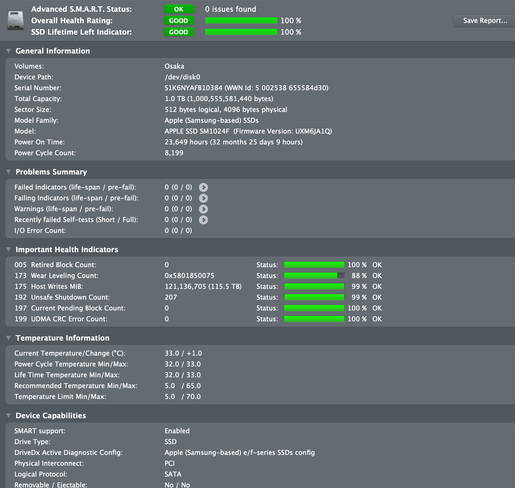

You mentioned storage issue. Why would there be a storage issue with a 2014/2015 SSD? Can you give examples of the type of issues? For me, it's not a storage issue because I have 330GB available.
It sometimes appears to happen when I unplug/plug the MBP, but now I'm not so sure.

I was doing a shake test to see if maybe they didn't set the battery or something else right when they assembled my machine. When I shake my MBP horizontally left/right something is moving inside. I can tell it's only one part moving. Considering we're talking about a MacBook which has all its parts crammed in there, it's quite noticeable. It seems to be shifting about 4mm every time I shake it. I can definitely hear it. Sometimes you can hear the keys moving a bit, but I'm not talking about the key mechanics. This is definitely a more significant part. I just don't know if that's normal. Should it be absolutely silent when you shake a MacBook? No parts moving even the slightest?
Here's a panic report.
What's weird is this line. Why would it say this? This is SSD not SATA so this line is very odd.
Root disk errors: "Could not recover SATA HDD after 5 attempts. Terminating."
It's mentioning registers. Could this be a RAM issue? But why would this start happening the day AFTER Apple replaced the battery?

Question:
What's weird is this line. Root disk errors: "Could not recover SATA HDD after 5 attempts. Terminating."
This is SSD not SATA.
Physical Drive:
Device Name: APPLE SSD SM1024F
Media Name: AppleAPFSMedia
Medium Type: SSD
It is possible the SATA cable may be damaged. You may continue to experience these symptoms such as panics, unusable, and unable to boot OS. After Apple service, you do get 90 days warranty and you may want to revisit them to tell them what you experienced after the repair.
Reactions: hobowankenobi
Ahhh really? Interesting. So they damaged it when they replaced my battery. Is the SATA cable something that would be touched during battery replacement?
It must be from their repair. There's no other explanation. It started doing this the day or the day after I brought it home.
So if I bring it back and they say I need to replace the SATA cable and they make me pay a billion dollars what can I do?
[doublepost=1557712109][/doublepost]That damaged/loose SATA cable could explain why I get KPs only when I move the MBP. It has never happened just while stationary. (I don't think.)
It would happened every time I disconnected the power cable to move it to another area of the house. But since I was moving it, maybe it was the cable moving around and maybe nothing to do with the power cable/battery after all.
And that would also explain why it doesn't go away in Safe Mode. (I'm still testing safe mode but I think it happened in Safe Mode as well.)
Yup I know about the 90 days. I planned on going back anyway because something is obviously wrong. In the meantime I wanted to get various opinions from you guys.

Maybe a clean install would be easier since I have everything backed up anyway.
But...... if I have already done diagnostics (D) and verified everything was ok via Disk Repair would there still be a possibility that the drive is corrupted?

2019-05-11 23:03:26 Kernel Panic (12 times)

So the KP occurred in Safe Mode too. And it occurred exactly when I pulled the MagSafe off and moved my MacBook to my desk. I am 90% sure it occurred at the exact moment when the MagSafe detached but I supposed it could've happened seconds after. I highly doubt it was from picking up my MacBook because it froze again when it was just sitting in one spot.
So right now I was thinking of wiping my HD and doing a clean install to test for a corrupt SSD. Do you think there is any point? I mean what are the chances of a corrupt SSD over it being a result of them replacing the battery? The problem started happening when I brought my MBP home from Apple.
So do you recommend I still test for a corrupt HD?
All sounds like hardware. Nothing for it but take it back and make your case.
They may want to wipe and install...to rule out software. Pretty standard procedure.
Bad SATA cable or SSD could cause the KPs.
Cable I can understand. SSD I cannot understand because the problem started the day I brought home my MBP from Apple Genius after they replaced my battery. Never had this issue since 2014. A little too coincidental don't you think?
I don't even think there's a point in doing a clean install because it's not the SSD. All tests I did on the drive say everything is fine with it too.
Anyway, I'll take it in tomorrow.
[doublepost=1557891095][/doublepost]Further tests going deeper with checking SMART status.

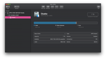

[doublepost=1557891216][/doublepost]Hey, with Disk Utility most drives have two parts on the left pane. The product name at the top and then the custom name below it.
Why does mine have the additional Container disk1?
Perhaps you misunderstand.
I worked for quite a few years as a certified Apple tech at a Authorized Apple Reseller and Service Center.
There is a process that is basically scripted for diagnosis; it is not up to individual techs to do what they think is prudent.
If they need to follow the steps and do a clean install, they will. They won't take your word for it...or any customer. They have to do the steps, in order. It is a requirement. As I have been away from that world for about 7 years, I would not be surprised if the process is more refined, and hopefully better. But there will be a process, and it will be built for customers that do not do their own diagnosis, because that is the reality for the vast majority of customers.
If they replace the SATA cable, and the issue is not resolved, they will move on to storage (likely). RAM would be the first suspect on any board with removable RAM. Next...they would swap the logic board.
Point is, all your testing, while valid and prudent...and educational, won't matter to Apple. They will follow their process regardless.
Welome to APFS. This is the new normal.
