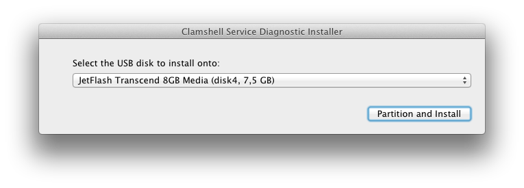

So, I've found a Clamshell Service Diagnostic (CSD) installer to help me to make a diagnostic of the problem without opening my computer. When I try to install the CSD utility into a Transcend USB key (8Gb) it seems that the process runs well BUT after it's finished the USB key is intact ! I've already tried to partition the key with MBR and GUID tables but no luck.
Here are some screenshots :
Does anyone have access to Apple Global Service Exchange (GSX) in order to search some help for me, please ?

Hi Monkeyat,
you need the following tool to check your book (the CSD-Tool is the wrong one): Apple Service Diagnostic 3s132.
I hope this helps.
