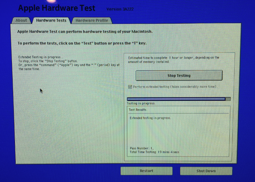

Apple Hardware Test won't complete. It seems to stop after about 20 minutes. I can still move the mouse, but it's very jerky. The time shown next to "Total Time Testing" has not updated in several hours.

I was hoping that the Apple Hardware Test would tell me the answer, but it won't finish. I've run the native test and used the Option - D to get it to download the test.

If I run AHT now I get the same results as in my OP. Hmmm.
