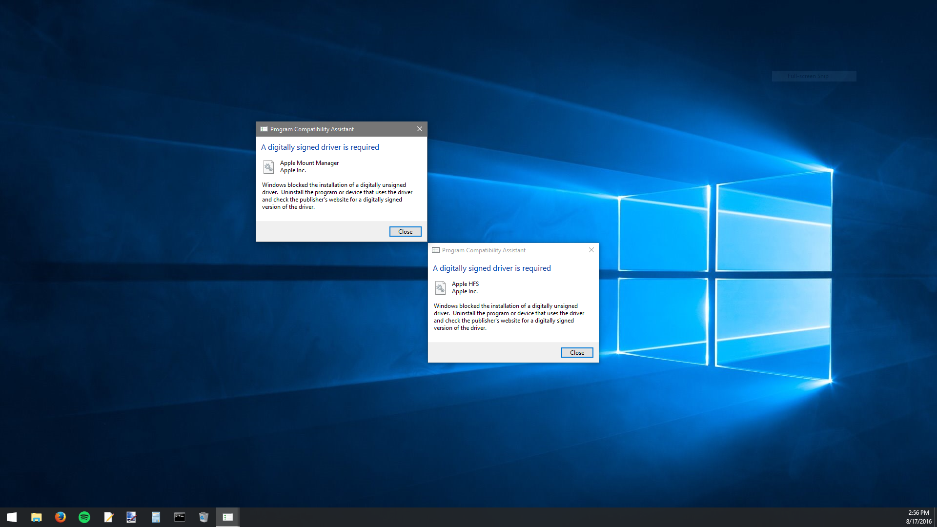

The Apple HFS+ drivers are broken on the latest public build (14393) just released.

I can confirm that the latest Windows build blocks drivers without a matching signature file (Catalog file). Apple will have to update new BootCamp installers to use a INF, CAT and DLL's for the HFS+ Drivers (instead of having the MSI copy the DLL's and registry entry's).

I can confirm, drivers no workie runing latest windows build. I dont get any PCA block though, it shows drivers are loaded in autocheck, but nothing is working. tried 4.0, 5.0, 6.0 drivers, nothing showing up. Paragon HFS+ works and macdrive works, but they are cancerous death. Always corrupting the drive somehow and you lose all your data, have to format etc. Ive learned the hard way to never trust windows with HFS write also never trust mac with NTFS write. mac will bork your NTFS drive and then you will be trying to recover and get chkdsk to run when you cant boot into windows and then you have to load a USB recovery to try to get chkdsk to run and sometimes it fails and you are done, stick a fork in you.
