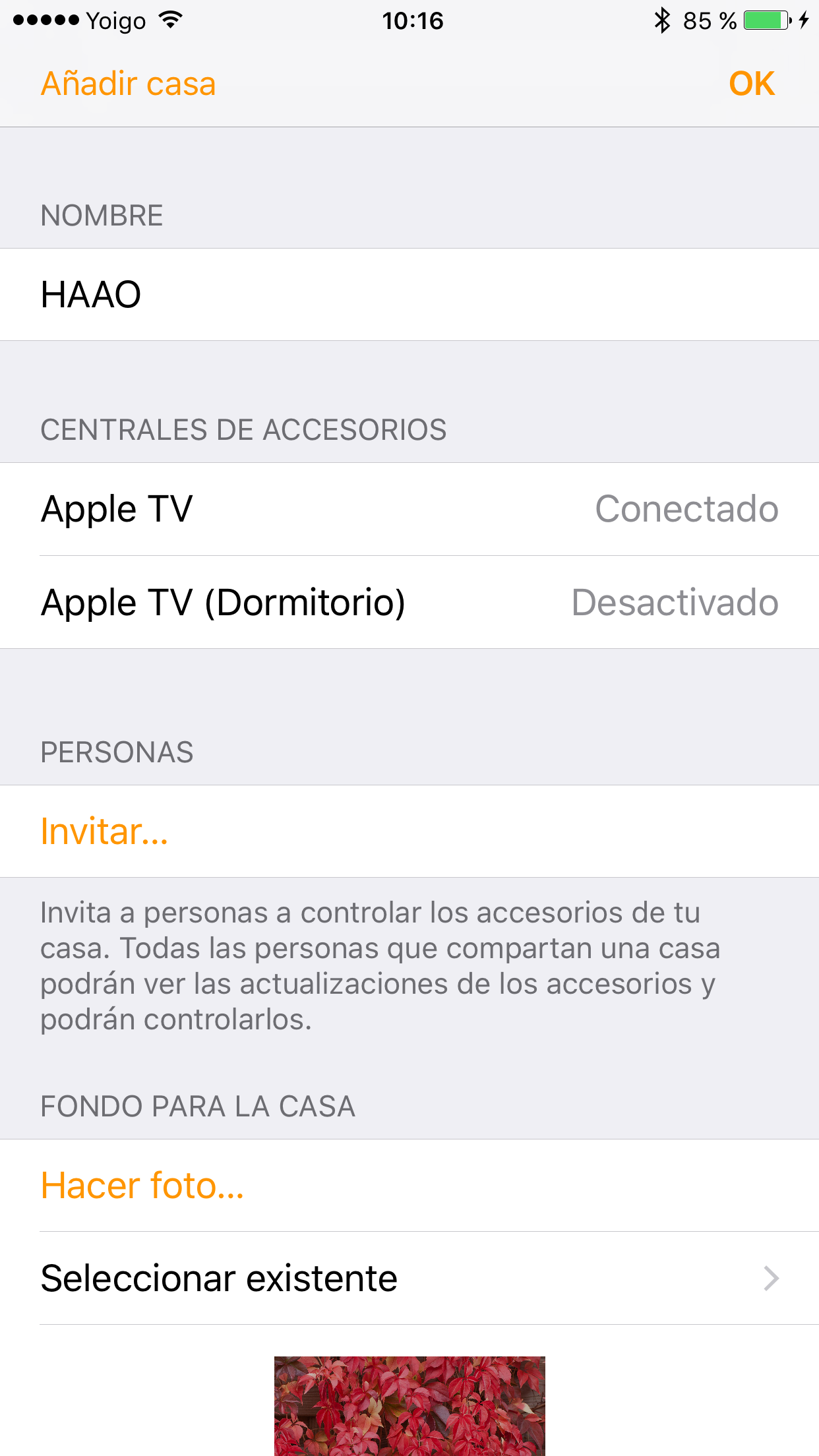

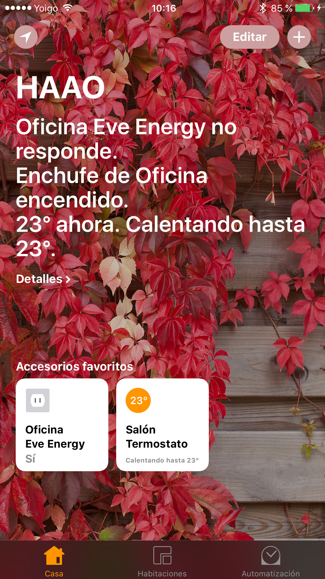

I have just installed a new Elgato Eve Energy switch to control a computer in my office. Everything is fine when I'm next to it but, it does not work when I'm away.
It is a big three flour house and the Apple TV (latest gen) is on the main floor, whereas the switch is two floors upstairs. The Apple TV is on the main floor wired connected to an also wired AirPort Extreme. On the second floor there is a wired Airport Express. And finally, on the third floor there’s a wired Time Capsule.
I also a have a third generation Apple TV on the second floor but, it appears as "not active" in the House App.
I assume the problem is produced because of the distance between the switch and the Apple TV (not within Bluetooth range), even though the Apple TV is on a wired LAN connection.
So, the question now is if there is any way to increase the coverage, so that the the Apple TV and the Eve Energy are able to connect. Would it work if I use a secondary 4th generation Apple TV on the second floor?
Is there anyway way to solve this problem?.
Can you please help me?
Thanks.
Hugo
PS: I include two screenshots (in Spanish, sorry) of the Home App

I've got a secondary ATV but it appears as "deactivated" on the Home APP. Do yo know how to activate it?
Is your secondary Apple TV a 4th gen? My spare 3rd gens used to be listed but since the latest iOS, they don't work anymore. I believe only the 4th gen models work now.
Have you made sure that your other Apple TV is signed into your iCloud account? Somewhere under Accounts on the Apple TV you can see whether Homekit is enabled. Can't remember exactly where though.
You can only have a single ATV active as a hub. You can't activate a second.

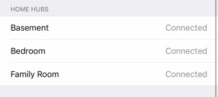

All 3 of my 4th gen Apple TVs show up as connected:

Thanks. I was wrong 🙁 on using multiple ATV's. My ATV3 shows as disabled. I don't think I have two-factor enabled on it. I'll check. The ATV4 shows connected - and works fine with the BT devices - middle floor of a three floor house. There are some BT repeaters coming out - one form Elgatao / Eve and one from ConnectSense. I will be adding BT water sensors in multiple locations - a repeater might help ensure solid communication with them.

I read on apple's support page that while the 3rd gen is usable for a hub, once a 4th gen is added, the 3rd gen can no longer be used.
https://support.apple.com/en-ca/HT207057
"If you add an Apple TV (4th generation) to a home that has an Apple TV (3rd generation) set up, the Apple TV (3rd generation) will stop being used for HomeKit remote access."
Reactions: HMonivar
Thanks - my ATV3 shows disabled - that explains it.
it sounds like "profets" has three connected ATV's - all ATV4's??
