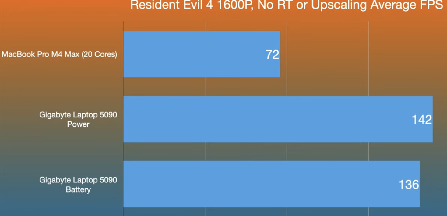

When the M1 Max launched, Apple said that it rivaled the flagship NVIDIA GPU at the time, the RTX 3080.
However, in 2025, when comparing the M4 Max MacBook Pro to PC laptops equipped with the flagship NVIDIA GPU, the RTX 5090, which costs the same as a M4 Max MacBook Pro, the MacBook Pro gets destroyed, it is not even close.
And this is true even on battery power.

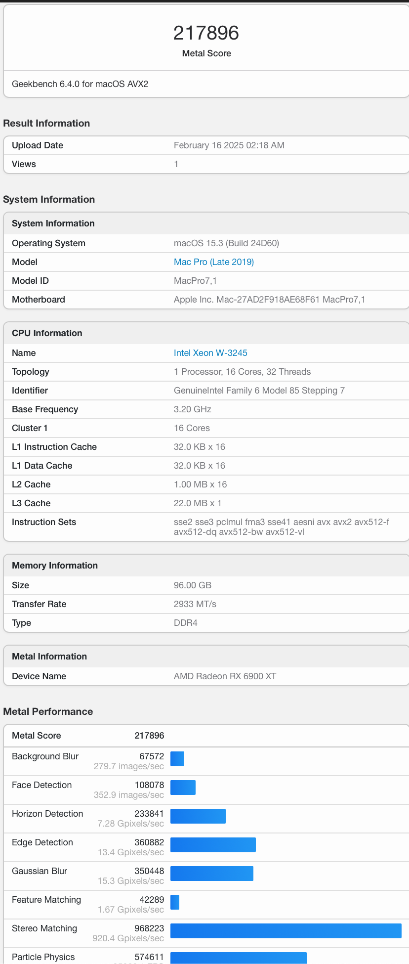

I'm late to the discussion and I'm sure it's already been said but I'll post my results anyway.
