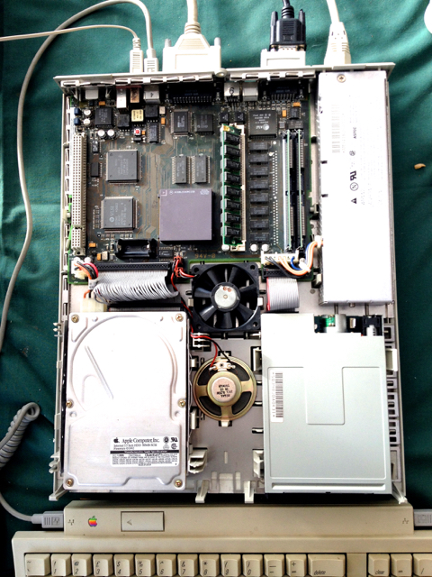

I got the usual start up Bong followed by two sets of tones.
I have been there with PRAM Batteries on other macs before so I removed the battery and left it out overnight - I didnt short it out yet! I ordered a ne battery from Amazon uk.
Tried again this morning and with the same result..(BONG diddle diddlle diddle up and diddle diddle down again tones!) except this time I did the old engineers test (stick- one end to ear and other end to HDD) and nothing seems to be moving in there.
My first attention to the problem was following trying to link the LC475 to an Apple Multi Scan 15 Display (previously found to (sort of) work to my old PB 1400c). The Screen stayed black, the orange light showed and nothing showed on screen - the little green lights inder the front cover were seen to be illuminating consecutivel. I have acquired the right cables and had an adaptor.
I have concluded the PRAM Battery needed replacing and that until I have the new one in and can try another reboot the screen problem may be casued by the lack of working PRAM.
Q1. Could the PRAM battery effect the HDD startup? Is there any other way of testing the HDD
Q2. I tried a floppy in the drive - nothing happened - paperclipped it out again.
Q3. Recapping: the MacCap guy has a very effective operation going in the US but how can you see if the caps are defective have 'leaked' and is there anyone offering a similar service in UK?
Q4. Where does anyone get old computer bits in UK? Bay is not surely the only source?
Sorry for the extended questions but I have found several 'Pals' who have or had similar problems with LC475s in several different sites and no one seems to have pulled them together yet...unless you know better in which case please share!?

I got the usual start up Bong followed by two sets of tones....
I suspect you have TWO problems there.
First the odd chimes are actually a POST error chime.

It's usually (on a working machine) a memory error. If any extra memory is installed (72Pin SIMM), remove it and try again. If that doesn't work there are a few caps near the SIMM socket that can leak and corrode/etch tracks completely through.
As for how to spot them, hold the board in a good light and move it around to reflect light around the capacitors. if you can see a wet/glossy area around them, that's the leaked electrolyte. The other clue is that the solder joins look black and/or some of the tracks have black areas or spots on them.
Second, the hard drive. It's probably suffering from a phenomena called Stiction. The original lubricant on the metal platters allows the heads to slip on the surface as the drive tries to initially spin up. (Once the platters are up to speed, the airflow over the heads makes them skate mere microns above the platters). Replacement is probably the only option - this is getting difficult and in some cases expensive. There are a few threads here about 'stiction', a quick search with that keyword in the Collectors sub-forum might help a little.
Can the battery stop the HD spin-up ? No. To be certain, unplug the 50pin data/interface cable leaving the 4pin power cable attached and power the computer on. It should spin up by itself, so long as +12volt and +5v are getting to the drive. (red wire +5v, yellow wire +12v). A multimeter helps here.

First the odd chimes - exactly right! The second (didle idle) is that one chime. So that narrows down the problem but doesnt the absence of a working PRAM battery create that set of sounds anyway? If we set that aside first... wont it make the cause of any others easier to isolate....?
I have no PRAM battery in and the screen is no longer connected (nor the SCSI ext HDD, nor the speaker, keyboard etc.) and I still get the same sounds. (after the attached photo!)
The two banks of SIMMs were added and worked fine until we put it away.... n years back... but I will remove them and try again... after the new battery arrives? Same for the VRAM, do you suggest?
So far as the Caps are concerned I have our US MI friends chart and none seem to have leakages or fluid around their bases and all look fine. (photo supports?) I have a long handled paintbrush with long staple hairs and dusting around their bases the dust comes away and all is dry. Is this a fair test? I have not yet dared to remove the MB and assume thats the only way to look for tracking or blackened solder joins....
On the HDD point... if it is stuck.... it is obviously not going to help and I will remove it and start to warm it, ready with the heavy handled screew driver as you suggest ;-) later.
I dont want to spend £s on a new Disk until I know the LC475 is going to work!
My aim is to get it to a point where it can act as my Desktop (replacing a PISMO). If it will cope I will look to up the processor and the VRAM and RAM. I may also need to find a more recent screen - the old white domed iMac (still in the garage) would have been ideal but Im not sure its practical....
Thanks for your expert advice!
The whole sequence of chimes (in he link) is the error chime. You may hear the startup chime and THEN the error chime.
Removing the PRAM battery will not affect the machine, except for the realtime clock and some settings (cursor blink rate, highlight colour etc). The machine will happily power up and boot the OS without a PRAM Battery. And yes, Remove the RAM (there is 4MB onboard) but leave the VRAM - sadly, it needs TWO VRAM SIMMs at a time.
The black spots would be visible from the top, so there isn't really a need to remove the board. I'd be surprised if the caps weren't bad/leaking - BUT if they're not, it's a great opportunity to replace them BEFORE they leak. I can't tell from the photo you attached. Need some good (in focus) close-ups. 🙂
EDIT to add - if they're NOT leaking yet, try heating the caps with a hairdryer for a minute or two, then turn the machine on. When these caps begin to fail, warming them makes them work again. It's the old Sony Service, Camcorder diagnosis trick.

I can see you've read up on stiction. As for your other comments above, the LC475 is many many processors/MacOS versions behind. The Pismo and iMac G4 (the 'iLamp') would probably serve you better - depending on what you expect to do. It's like a PC-XT with Windows 3.11 to a Pentium3 running Win95-WinXP (or thereabouts). The Pismo still has a floppy drive and will run OS 9.0 thru 10.4 (with upgrades). Of course, you'd need to workout what works and what doesn't - again, it's down to what you expect to do with your 'restored' Mac.
Hi again Mactech,
Yes, I read before I asked and saw some of your earlier advice, followed some too! ;-)
PROGRESS today: I removed the HDD and stuffed the System 7 HDD floppy disk Uno in the drive and lo and behold we had a boot up!
Not only a boot up (single tone!) but my MS 15 Display screen came alive too!
So I turned everything off, put the least used up PRAM Battery back in, connected up an external SCSI HDD, changed its ID to 0 (hoping the Mac would recognise it) and started it, followed by rebooting from the floppy..... I had hoped I could install OS on the Ext HDD but sadly it was not visible amongst the onscreen options.
So I have put the lid back on and put the screen back on top.
Now the switch is playing me up again!
Anyway I know the screen works, the battery is probably only just alive so a new one ought to give us a regular boot up and with luck, warmth and a heavy ha... er ... screwdriver we might be in business.
Your thoughts?
Just so you are aware - I have never had or had to use a PC...of any kind! I bought my A][ Europlus in 1977 and have had 15 since! I now have a Mac Book Pro 15 with R/D and I love it but there are times and reasons why I would like to have a reliable Desktop again. I mentioned I have a number of Macs of various ages all put in to storage in our Garage or in the loft in 2000 when we moved in. So I have a modern tool and I love it (I love 10.10 tooas does my wife who has an iMac upstairs! My reasons for trying to get the older uns working is using the grey matteras well as flexibility. I am not really looking to sell any of them but if I was to no one would be interested if tey were noit working. I also read that HDDs and Memory as well as processor upgrades have been effected that were unconceivable when the Apples or Macs were out and in use first, so it would be nice to see what we can do with some of the older machines to bring them a bit more up to date than a few weeks ago I realised was possible.... the problem is that in UK, I dont know how it is in Oz, there are no really reasonable sources for the bits we might want - in US it sounds like there is a Mac recycling store on every corner... I never see them when I am there :-(
So thanks to you, some progress made today. I reverse the system and try the HDD back in the Mac with power only at first in the morning.
...unless you have any other thoughts!?
