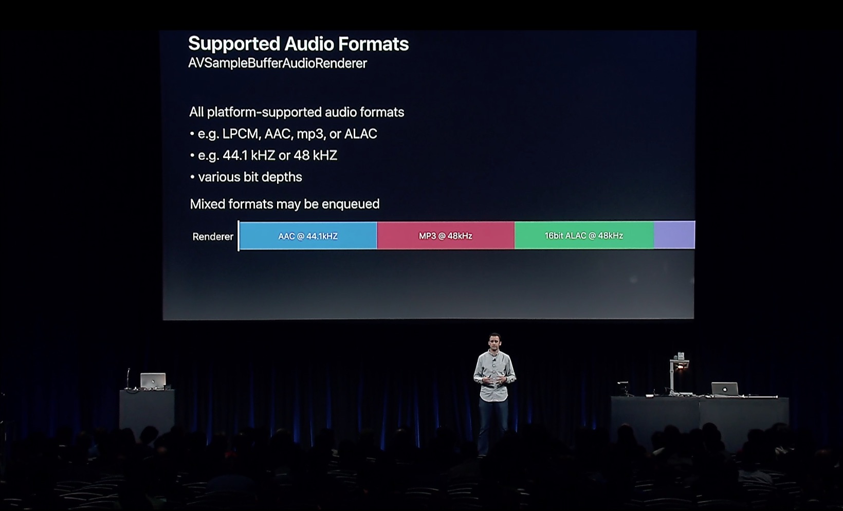

Slightly off topic but it’s inexcusable that AirPlay can’t even stream 48 KHz which is the standard frequency for TV/Cinema. It sends 44.1 kHz instead, the standard for audio CDs and music. Some will argue there’s no way you can tell the slight reduction but I argue there’s no reason they can’t send it in its native encoding quality! It’s a pretty minor increase in bit rate and still well within spec, even for slow Wi-Fi!
Can anyone confirm this is still the case with AirPlay 2?
You are mistaken. Airplay has always streamed ALAC in both 44.1kHz and 48kHz depending on the source and destination. Any source sent to the Apple TV via Airplay, has always been 48kHz ALAC, even if it is 44.1kHz mp3 audio, it is upsampled to lossless 48Khz for the TV. And YES, this is still the case in Airplay 2, with even more capability rolled in. I've attached a screenshot of an Airplay 2 queue, buffering multiple minutes of mixed source material into a single upsampled playback stream. There's a lot of cool new magic in Airplay 2. Your comment is wrong about both versions of Airplay however.
I should clarify. AirPlay probably does stream 48 kHz to Apple TV with HDMI. This I didn’t check since I don’t have or use Apple TV. But it doesn’t to AirPort Express.
I trust my DAC which tells me what it’s receicving from AirPort Express via optical digital when I’m playing 48 kHz movies or audio files, or for that matter even higher frequencies.
I can attach proof of this as can others who have similar equipment. This is first-hand observation. So I’m not completely mistaken but should’ve explained it better.
And yes, I still think this limitation is kind of stupid and dumb.
Since you were talking about TV/Cinema audio, I was speaking to that use case - which is the Apple TV. 48kHz is the only option for ATV Airplay. For other devices like the Airport Express, 44.1kHz is the default because it’s made for music applications, not video.
In any case, 44.1 isn’t a limitation of Airplay, it’s a hardware setting. There is always the possibility that Apple will include both 44.1/48kHz capabilities in the forthcoming firmware updates for Airport devices as Airplay 2 rolls out, but hardware may be a limiting factor - particularly for the older plug models, which some speculate may not be able to be updated for AP2.
