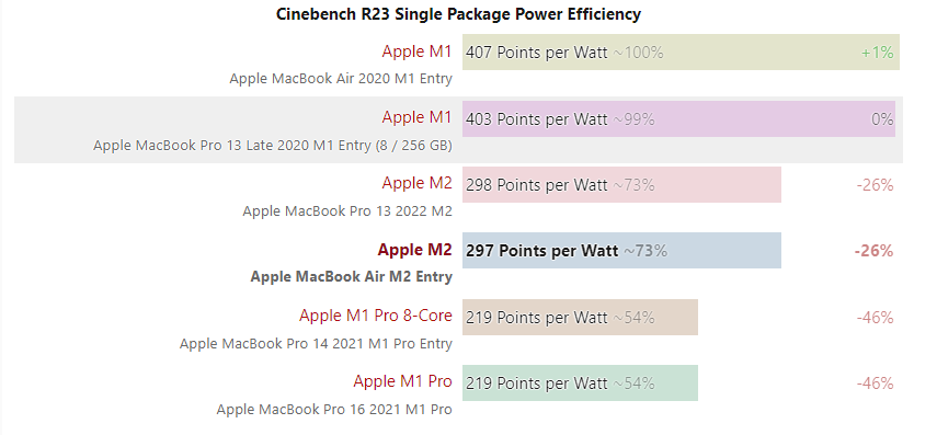

It seems, you didn't read and/or understand the Article at all.
26% worse is NOT the difference in raw power consumption, but the graphic below, "Points per Watt".
The chips are not equal. You cannot claim the M2 is less efficient simply because it consumes more power.
When doing the exact same Task, you 100% can. That's even the definition of efficiency. Performance per Power consumed.

You can measure power efficiency pretty easily, and Notebookcheck did it. Comparing 2 numbers really isn't difficult and doesn't leave any room for argumentation.
297 points per Watt is less than 407 points per Watt.

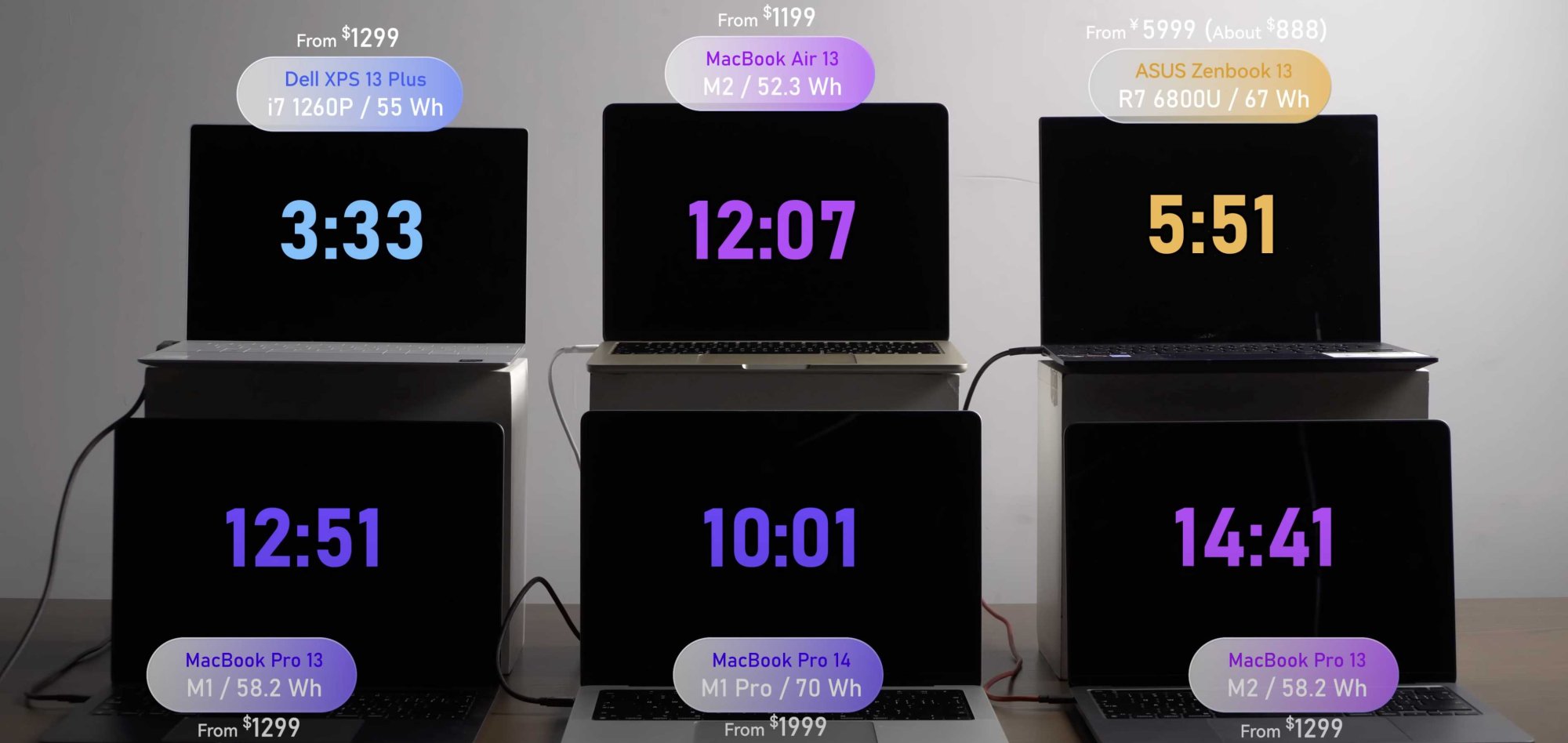

Geekerwan also compared the M1 and M2 to other Windows based systems and shows that the M2 MacBook Pro actually achieves higher battery life than the M1 MacBook Pro on their script based battery life test. Their battery test is based on 1 hour cycle that streams music constantly, 10 minutes each to Microsoft Office (Excel, PowerPoint and Word), 10 minutes web browsning, 10 minutes online video streaming in 4K and 10 minutes of instant messaging.

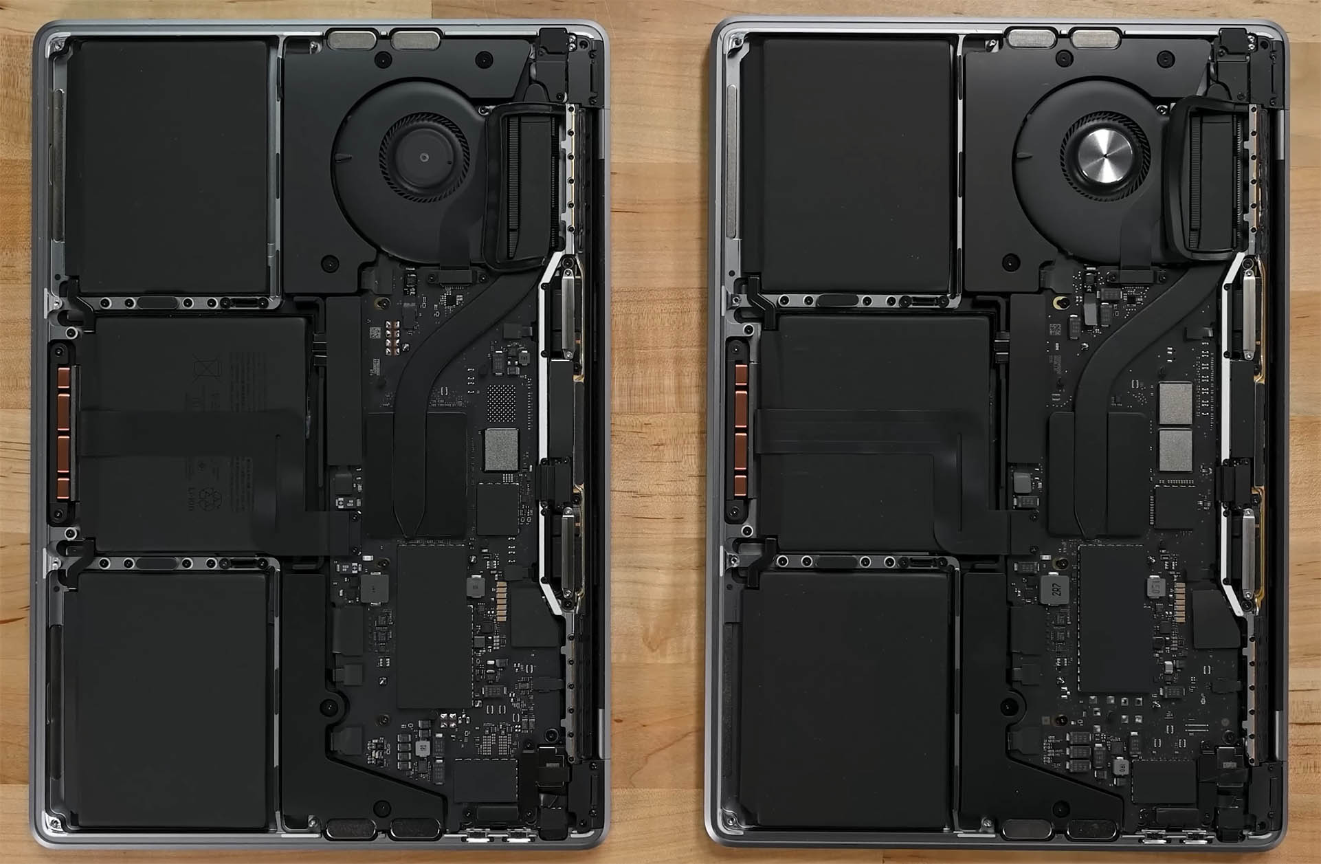

Do the M1 13" MacBook Pro and M2 13" MacBook Pro use the same battery? Are they interchangeable?
They pretty much use all the same parts, which is why comparing the M1 and M2 in MacBook Pro 13" should give us the best picture on whether it really is a regression with regards to power efficiency.

It seems you didn't read the article at all. The article makes its actual claim based solely on the power used and pretends like the M1 and M2 are identical. You might as well say the M1 Pro is "worse" than the the M1 too, since it uses more power. The article is idiotic.
No, they make the claim based on power used and performance delivered using that power. What's the confusion?
It's not less efficient. It does more. If the M1 and M2 had the exact same performance characteristics, then you could make this claim.
I think your understanding of what constitutes efficiency might be quite different from its common definition. Efficiency = work done per unit of energy, so claims of M2 being less CPU-efficient than M1 on CB23 are absolutely correct. It's entirely different issue that these comparisons bear very little useful information.
