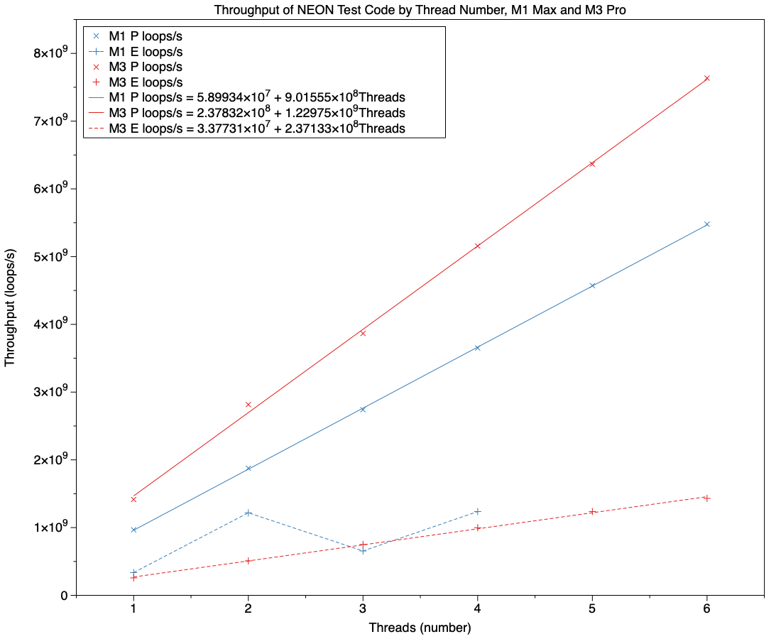

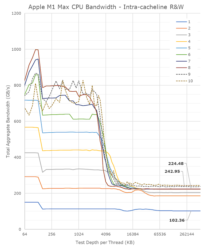

What you need depends on what you do. I dug into this because I do astrophysical simulations on very long timescales. I repeat the same simple calculations on a large amount of numbers a lot of times. Which means the most time the CPU spends is waiting for RAM. For me RAM speed is king. For you, it could be completely irrelevant. For most people it's not really relevant, that's why the get away with pushing people who need it to more expensive products (or a PC).
It's a bit unclear if you're talking about the NE, the GPU, or the CPU. The bandwidth impact on the CPU p-cores between 200 GiB/s and 150 is minor, and likely zero between 400 and 300.
While this is with the M1 Max, it's unlikely to have changed that much for the M3 Max:
As you can see, aggregate used bandwidth quickly drops off after more than two cores, and never exceeds 250 GiB/s. Maybe that has been pushed to close to 300 GiB/s, but I doubt it.
Now, if you're talking about code running on the GPU or the NE, that's a different story.
A little of both. My work is confined to the CPU because that's what other members of the group can work. But the thread is about AI, and how Apple deliberately started to cut back their cheaper hardware's performance years before AI became hyped up.

Doesn’t matter, the M3 Pro is often faster than the M1 Max. The bandwidth reduction everyone whines about doesn’t really seem to be an issue at all.
Go to EclecticLight.co and read the articles there - this is just one of many -
This article only uses the CPU. The memory bandwith is shared between the CPU, GPU and NPU.
Yes, that's the point. The high memory bandwidth is mostly useful for the GPU cores, not the CPU cores. The decreased memory bandwidth and p-core count has a negligible impact on CPU performance.
I'll say one last time: this thread is about ai performance, which utilises the gpu too. A mid level pc has around a 100 for the cpu and 300+ for the gpu. Yes, they have to copy between system ram and vram, which is a drawback compared to apple silicon, but that's mostly affects startup time. Because of unified memory, adding vram in a mac was ridiculously cheap compared to standalone gpus, even with these abhorrent upgrade prices. Cutting the bandwith is just about milking more money from people who'd use their mac for ai without increasing further the ram upgrade prices, they've simply forced them to skip the pro and go for the max.
