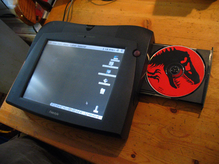

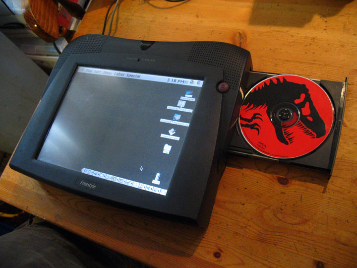

I got this in a trade from a friend. I didn't think it would work, but I was able to get it to boot up! 🙂 It's running Mac OS System 7.6. It's a Macintosh clone tablet made by Assistive Technology.
Basically it seems to be a PowerBook 5300 with a touch screen, no floppy drive, and some other ports. These ports look like they are audio jacks, but they seem to be a way to input buttons.

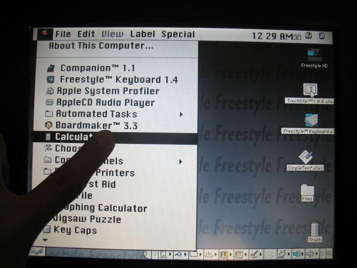

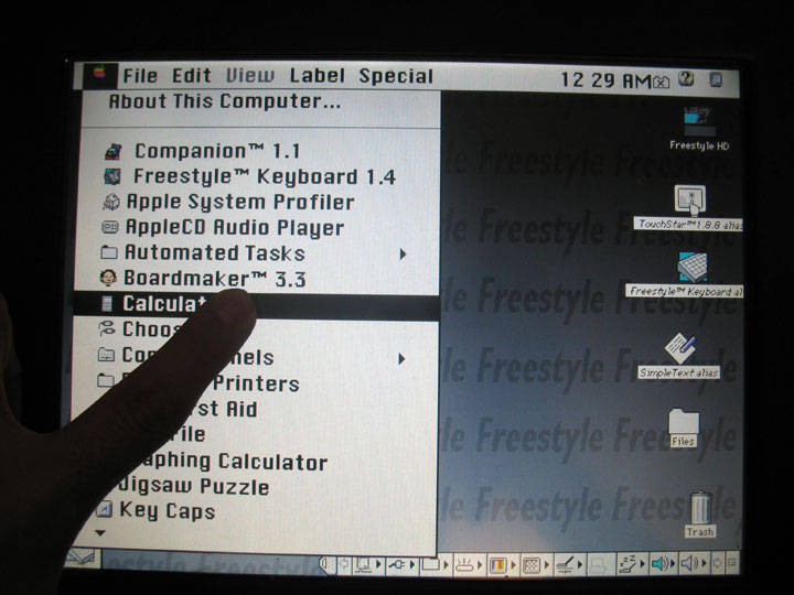

The Mac OS seems modified to accept a touch screen. First thing you'll notice is the top menu bar is much larger. Also the Control Strip is on the right corner, this allows the On-Screen keyboard (when minimized) to sit on the lower left corner.
Here's a YouTube video to show the on-screen keyboard. Also attached is a photo. I'll be taking more photos later. The only place I could find information about this was at Everymac.com - here's a link to their article. 🙂

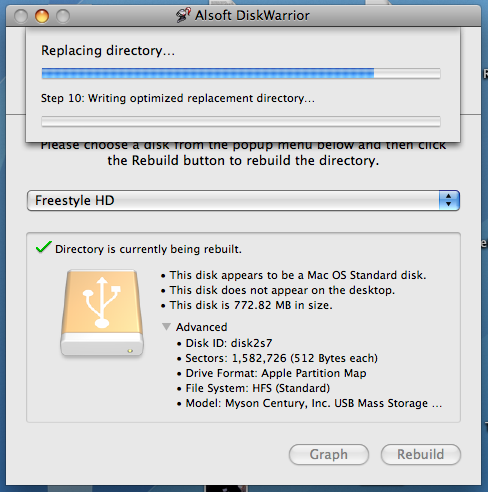

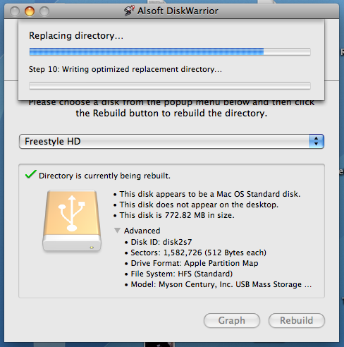

Ugh! I opened it up and connected the drive. Mac OS X locked up and Disk Utility crashed. When I put the drive back in the tablet it wouldn't boot up, if I boot from a System 7 CD it thinks it's blank. Disk First Aid says there are problems but, it can't repair it. Grrr...😡
Oh no!
Have you had any luck yet? Now you're really going to need that disc from that seller.
Disk Warrior looked like it was doing fine, but now it's replacing the directory and the application looks like it's frozen. I'll leave it and hope for the best. 🙁
