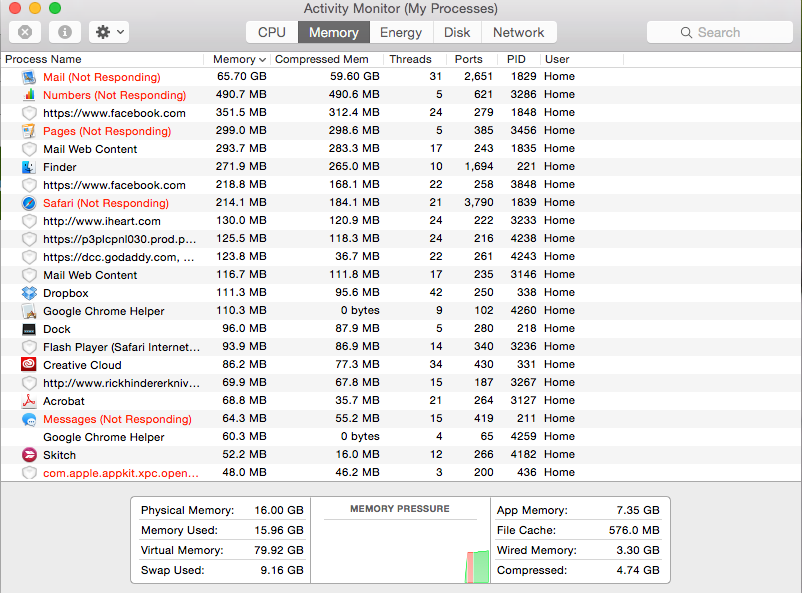

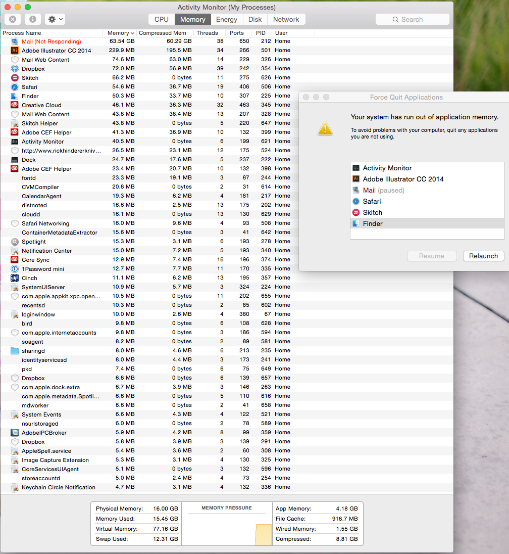

A little background:
I have the latest 15" rMBP - 2.6 GHz Intel Core i7 w/ 16 GB ram and 1TB SSD. I've never run into this issue before installing Yosemite. However, I have been having the issue since I first installed the Beta.
When the final public release came out, I did a complete clean install (hoping to fix the issue) and I'm still having it.
Basically after ~20-30 min I receive the "Your system has run out of memory" error. When checking the Activity Monitor, my memory pressure is in the red and the Mail app shows it's using ~60GB (yes GB) of memory.
I've attached two screen grabs from two separate days/occasions. On one of them you can see I only have a few apps open.
I've posted this issue both here and in Apple's support forum. It's very frustrating to have to restart my rMBP every 30 minutes or so. Hopefully someone can help.
Cheers, Rick

I started the other thread, since it didn't have any replies, figured I would add the information to this thread in hopes that someone can help.
Cheers, Rick
Cheers, Rick
