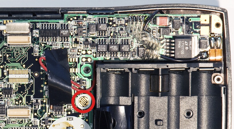

Since the reset button appears to be a carbon pad type, it's possible the reset isn't functioning (think of all those remote controls with hard to work buttons). There is a rubber button with the carbon pad at one end that covers the contacts. You should be able to clean both the contacts and the pad on the end of the rubber button with a little bit of isopropyl alcohol.
Also, since there is a "Power Manager Reset", I'd be removing all batteries overnight, re-installing them in the morning, waiting a minute or two, then pressing the reset and then power on. Is the 2032 coin battery new?
