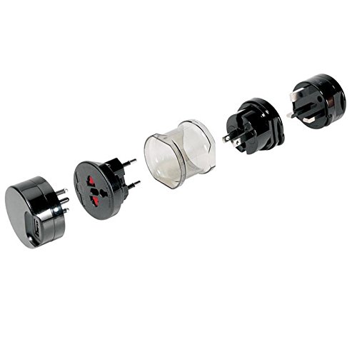

I think Apple failed in this "update." This design could hardly be clunkier. When traveling through Europe or Asia (where it's normal to run into three different jacks) this Apple's "solution" is cumbersome...so many little parts to carry around. All-in-one adaptors have been around for a while...and they're great!
well i cant say i know much about the outlets in asia. i must say i prefer apples solution (not saying it couldnt be more compact). once on a vacation to new york i dropped a similar one you show and it totally shattered and since it relies on springs and stuff its ruined
then i bought one of these and while its volume might be a bit bigger i would argue its more resistant and durable since there is no internal mechanism to break.
Considering everything Apple can do, I figure they could manage something durable and springless---it might even be sexy.

The two adaptors with round pins (at 12:00 and 4:00 on the box) look very much like the ones that Verizon ships with their international rental phones. The latter have the correct pin diameter and pitch for the very common German Schuko socket, but the angular "ears" beside the pins prevent the plug from entering the socket. I do hope Apple has actually tried their adaptors in a Schuko socket!
There is a standard plug which the Apple one might fit into (see http://en.wikipedia.org/wiki/IEC_60906-1 ) but it was not common when I visited in the summer of 2014.
Out of curiosity, did you try both of the similar-looking adaptors? One is a Europlug, and one is Schuko. Although they're practically identical, the dimensions are different. In particular, the Schuko's pins are larger and therefore it's less universal than the Europlug.
That's the model I've got, but without the USB section. I've only used the European sockets (I'm British) but I do find them very loose and wobbly compared to UK ones, and due to the cables coming straight out instead of down they're much easier to trip on.
