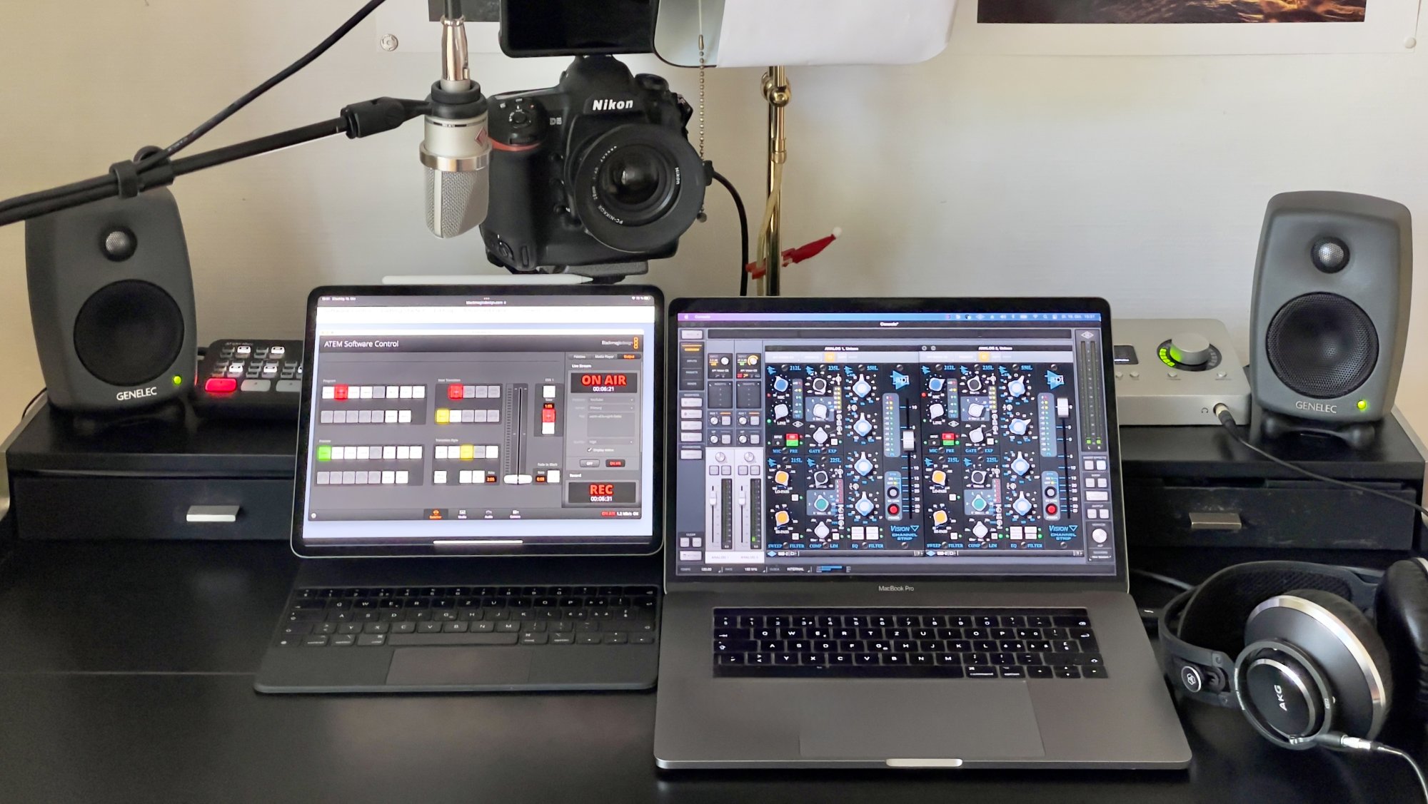

The majority of microphones I have observed also feature a male 3.5mm adapter, necessitating a female-to-female adapter. Nevertheless, there is no reason why not to use a female-to-female adapter. I am also using an ADC for video conferences, but my ADC is slightly more sophisticated.
