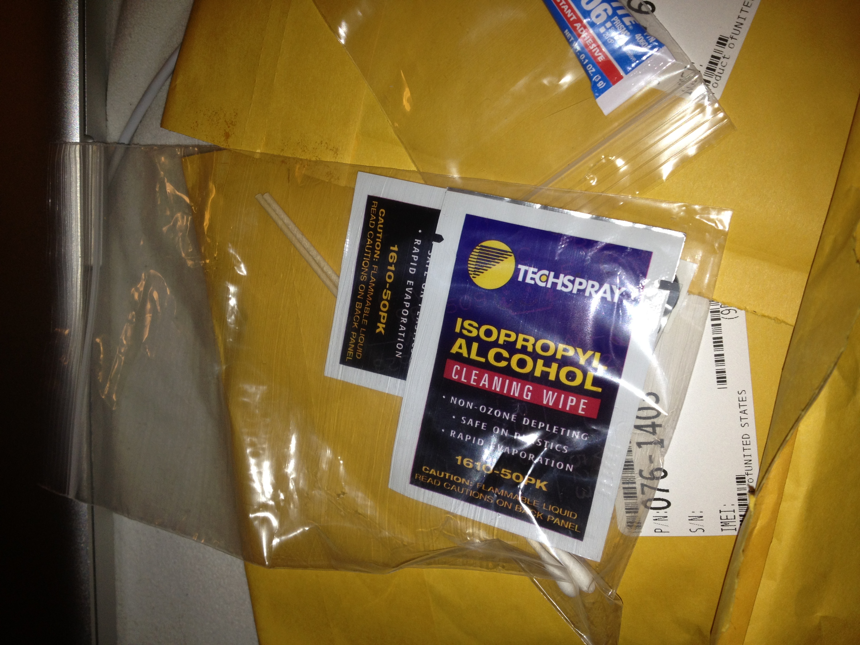

So, 1 of my foot pads went bad and I took it into the Apple store in March of this year. I was told that I would have to buy a new bottom case because it's not a warranty part (I have Applecare which expires next year). Total cost - somewhere in the $150 range.
Several months later, another foot pad fell off. I called Applecare. They said I can send it in or do it myself. I opted for doing it myself. They transferred me to the DIY department. They asked me how many I needed. I said might as well replace all of them - 4.
The call was quick. They were very apologetic. Actual words "this is not how the macbook pro should function, and I hope this resolves your concerns."

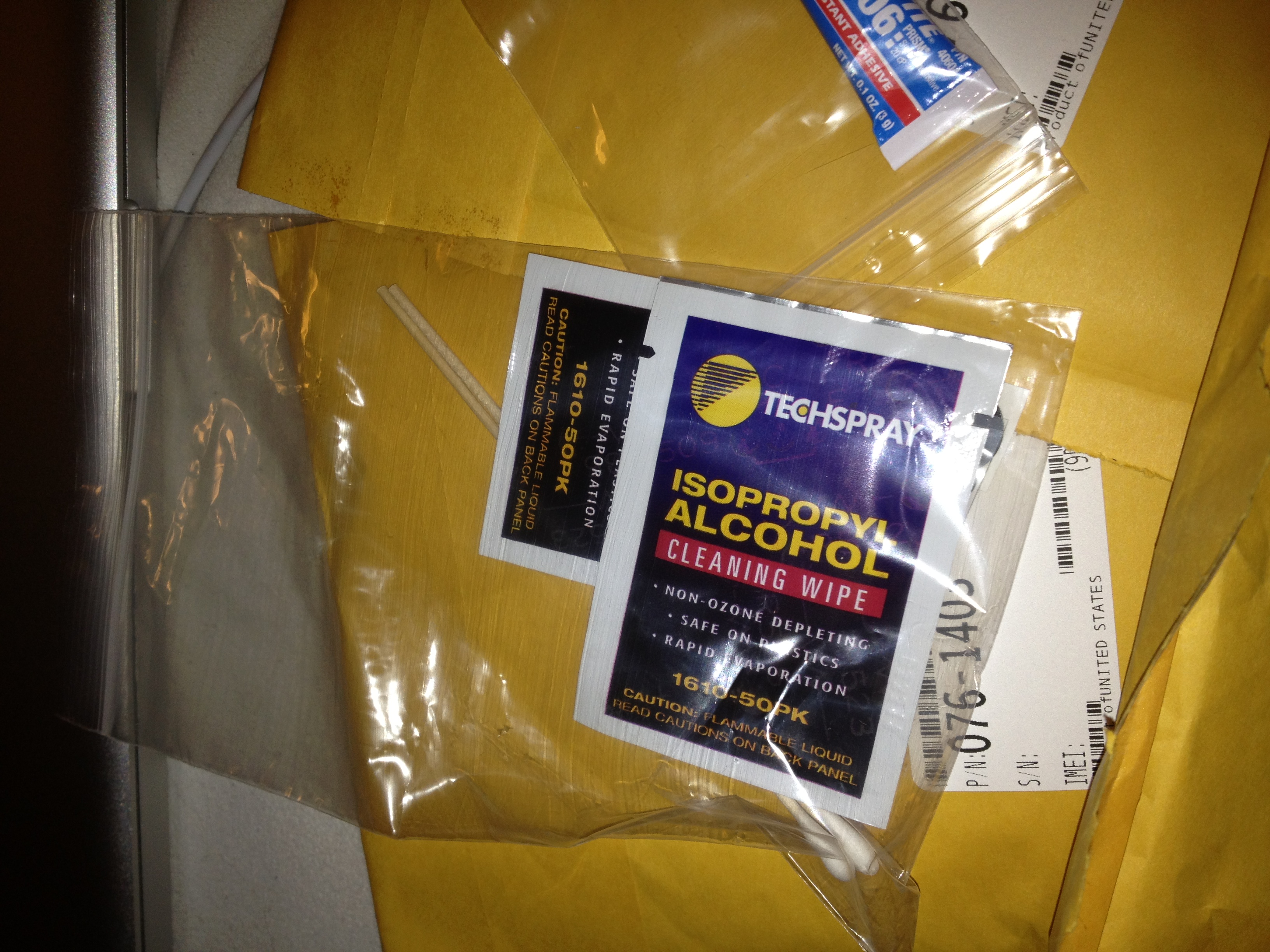

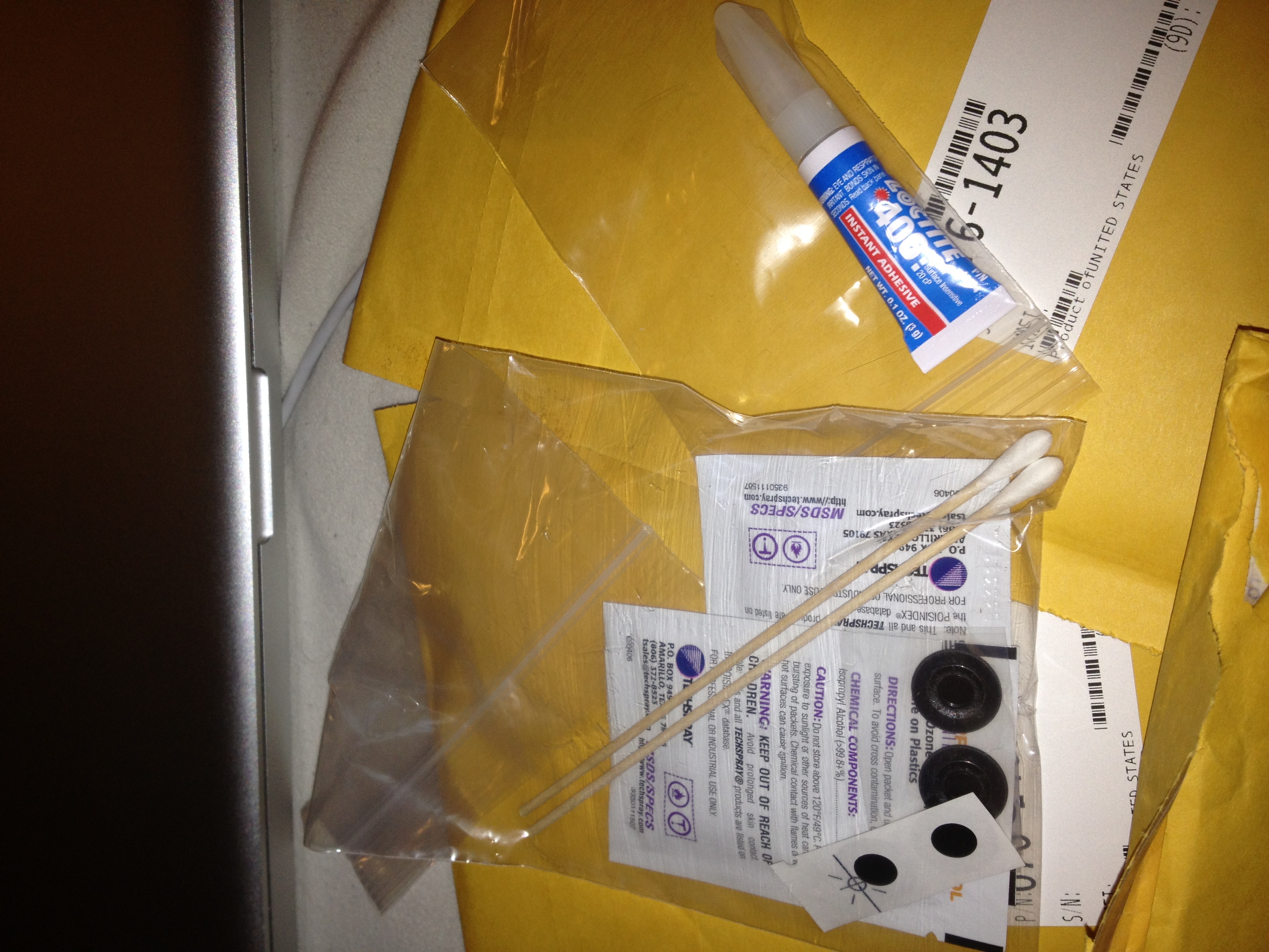

Two days later. These came in the mail. Four DIY kits. Each containing 2 foot replacements.
Process takes about 70 minutes (10 of actual work), 60 minutes for everything to dry before placing the cover back on.
Hope this helps someone out there who needs replacement pads. Don't crazy glue target/Home Depot or whatever other replacement pad onto your laptop (suggestion's I've seen). Give Apple a call.

If you plan and calling Apple and getting the DIY kit, I hope you can get the glue residue off the aluminum bottom so you can get a nice seal with the new feet.
The install wasn't messy at all - but I wasn't liberal with the included glue. I used maybe 2 drops on each foot.
