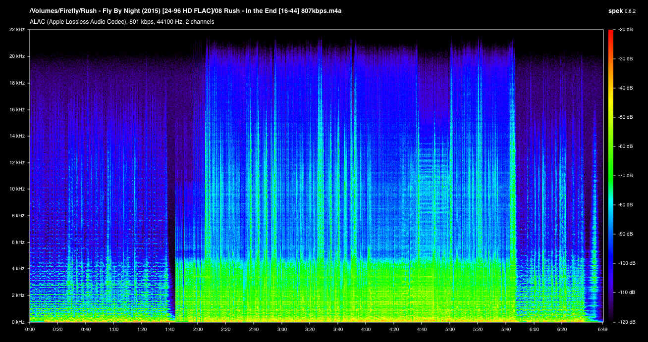

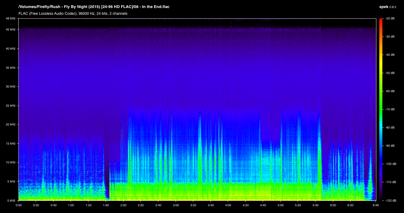

For all of you who think CD quality is worthless over an iTunes download here is a visual comparison which clearly shows clipping (loss of data) on a 256 file, and how the CD quality version does not experience this. For contrast I have included the original FLAC spectrum analysis.
To start, the lossless, 24bit 96Khz FLAC track.
Followed by the 16bit 44.1Khz
And last but (very much so) the least [i don't know how many bits] 48Khz, 256kbps track.
As compression increases (file size and bit rate
reduction) as does the loss of data, this corresponds to clippings of upper and lower ends of the audible spectrum leaving you with a tinny sound as the extra data isn't being filled in. At the top of the spectrum on the 256 file you see a clear line where there is no more audio output, it simply stops. This also increases overall volume of the track and just simply makes it louder, but at the end of the day more vacuous.
Maybe I'm not preaching entirely correctly and someone with a bit more knowledge will back me up, but the spectrums speak for themselves, 256 is inadequate, 320 is tolerable, CD quality is what we should be asking for and wanting.
Clipping generally refers to exceeding the allowable amplitude range of the signal beyond the restrictions of the encoding format. This causes bad distortions. But that's not what your graphs show.
BTW, perceptual audio compression on its own does not cause clipping.
As compression increases (file size and bit rate reduction) as does the loss of data
Perceptual audio compression of course means "loss of data", that's the whole point. The question is if the loss is audible or not. Fancy graphs will not answer that question.
Of course it stops, it's a band-limited signal. But you're talking about >20KHz frequencies, which are not audible.
No, it doesn't. You are confusing clipping and band-limiting.

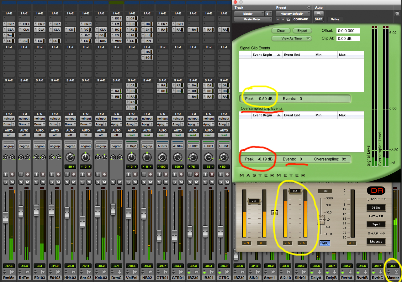

File Under: Audio Engineering -So here's something kinda goofy that I'd like to share: When we (audio production) are providing masters or stems for CD or digital delivery, we have to put a special meter on the master bus and watch out for inter-sample clipping. Even though you may set your bus limiter for a ceiling of -0.5dBFS, there are inter-sample peaks that can still get through and clip the master, but won't show on the master fader: It's just another little annoyance that I have to monitor, but paying attention to this stuff on my end will make for better-sounding stuff on the listener's end. Note in the image that my true peak is -0.19dBFS. The session is 24/44.1
Yellow = Bus setting. Red = Inter-sample peak level.
Thus, the idea that lossy compression is INAUDIBLE remains intact in my mind.
Whoa be careful there! Lossy compression most definitely CAN be audible, it just depends on how far you go..... some more pretty graphs even though I don't really agree with their use. Audio files here. Short and simple I can't tell the difference between FLAC and 320kbps, but can between flac and 32kbps (and yes I did some quick and dirty rounds with an ABX tester). So where is the crossover between audible and inaudible? That's the difficult question.

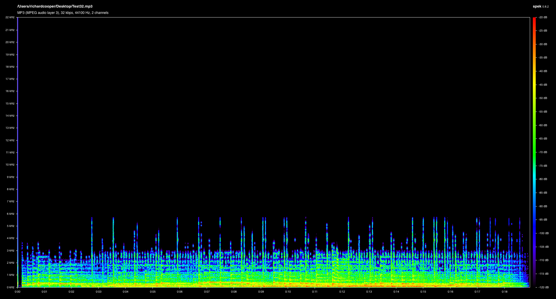

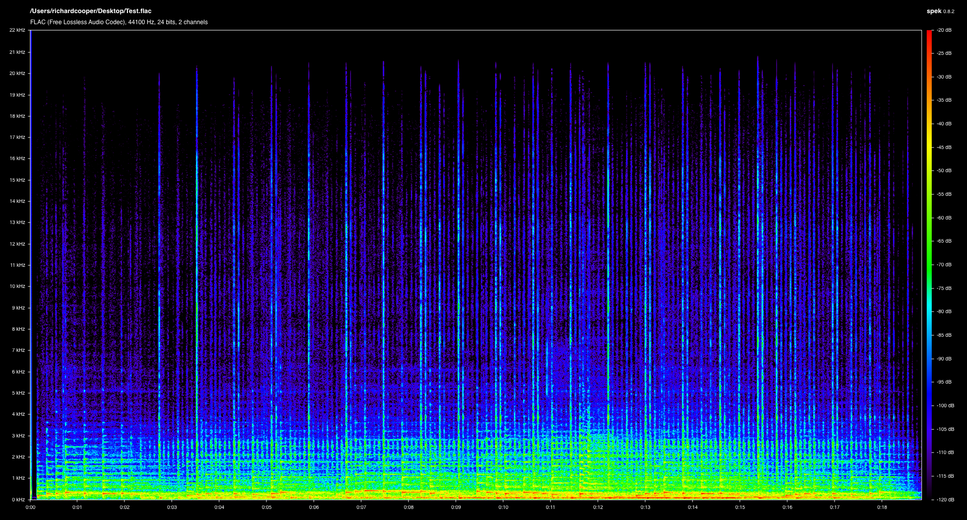

Sample music FLAC of original
320kbps MP3
32kbps MP3
I meant the goal of lossy compression is/was to be inaudible at a reasonable setting (obviously everything has its limits). Here I was specifically referring to the 256kbps example, which for AAC should be transparent (MP3 is more like 320kbps as it is less efficient). I doubt you could easily tell if there's an audible difference from a spectrograph, but you can tell some things about some data that is visible (like that so-called "clipping" artifact that was shown that isn't clipping at all).
