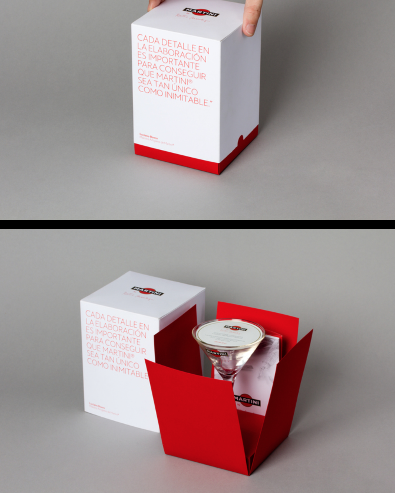

Here's the exact type of thing I"m going for. The outside or white shell keeps everything together, then when removed, the interior box folds out to reveal the contents. I think custom made/bought will in the end be the better option as I also want embossing.

The one you are showing in your attachment is actually a simple box to make. The hardest part to it, would be figuring out the die to cut it properly. It would have to be embossed and printed first though before being die-cut. It would be printed on a cover weight stock approximately 10 - 24 points thick and coated 2 sides.
It would be cheaper for you to try to find one already made, as to produce just 1 would be ridiculously expensive. I have been a printing pressman for 39 years so know first hand how much this would cost.

As I'm looking for just one, when you say die-cut, could I not just use a sharp stanley (x acto) knife to cut it myself? (As an ex-Architect student I'm use to model making etc. but I appreciate how much cleaner a die cut or similar machine would be)
