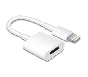

Does anyone know of any third party adapters that would allow me to charge the Pencil without sticking it into the Pro? I get nervous that it's going to break, and I would like to have other options...
Posted on another thread:
You can get an adapter from amazon so you can plug in your Apple Pencil to the iPad Pro and not have to worry about the pencil snapping.
http://www.amazon.com/Charging-Adap...sr=8-1&keywords=apple+pencil+charging+adapter

I would still like to know if these adapters pass through all 9 connectors, or only the power connectors.
