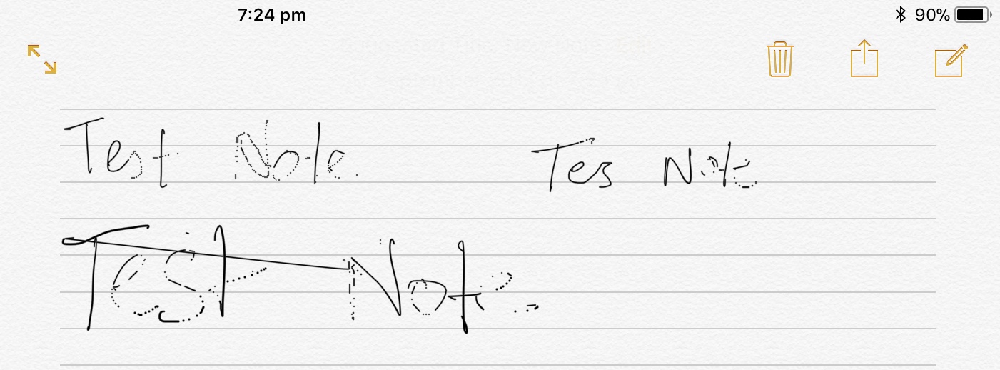

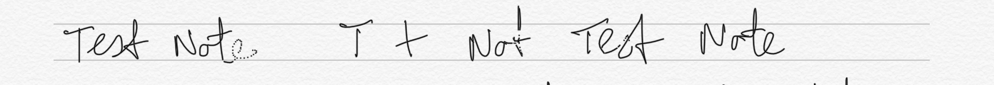

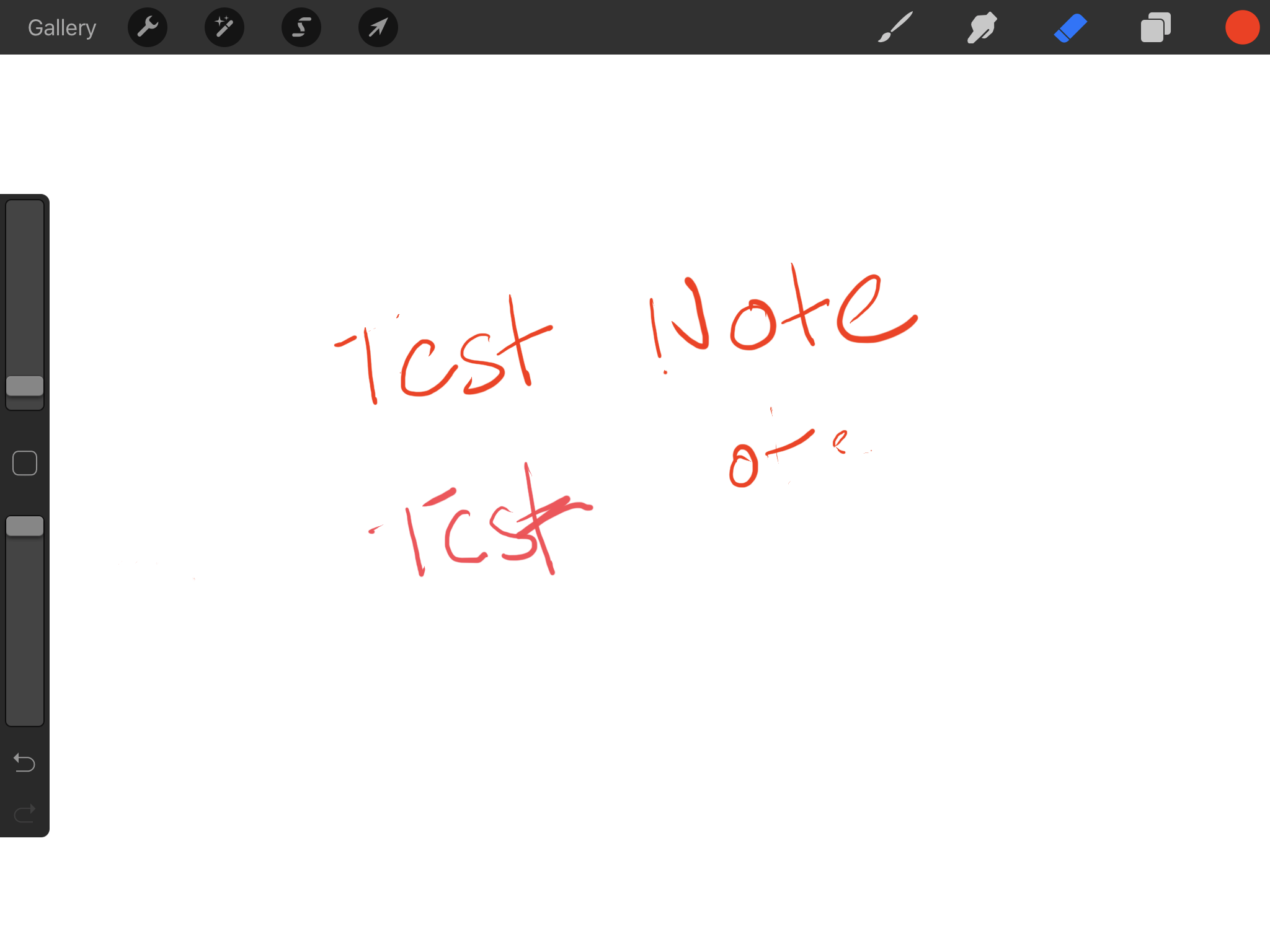

I don’t use my Apple Pencil all that much but I intend to use it much more with iOS 11. Anyway I went to try it out again on the latest beta and found it to be totally useless. I will be writing something and it lags (never did this with iOS 9 or 10) and then letters will randomly but very frequently disappear after writing them and some letters come out as dotted lines and in slow motion. It almost seems like the pencil momentarily loses connection over and over again. I thought it was a bug with notes app so I tried procreate app and it is the same problem. It appears to be an issue with finger/palm rejection but in settings I have it set to use Pencil only. It is totally unusable even to write a short sentence. The lag has been there since start of beta but I have not had the others problems until now.
This is the best I could get out of it (sometimes requiring multiple takes to get single letters)
And yes palm rejection is on, Pencil tip is screwed in correctly, the battery is 90% and my handwriting is not that atrocious! 😉

Thanks for the reply. Unfortunetly replacing the pencil tip did not help. I wonder if the problem is related to finger / palm rejection because I will be writing and whole letter or parts of words will disappear after showing on screen as I continue to write. If I place my hand anywhere on iPad the pencil input goes feral with dotted lines and randomly missed input.
