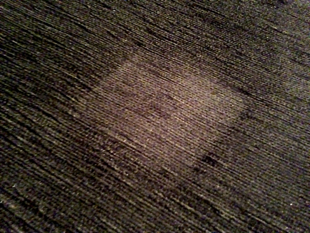

Normally, I'd agree with you, but my recent own experience with Apple power adapters leaves me questioning it more than usual.
My own experience is with my MacBook Pro and the Magsafe adapter. Let me preface this by saying that I have been using Apple computers and mobile devices over the past 10 years, and whilst I'm no electrical engineer, I know the basics of safe use.
Back in February, my MagSafe was connected to my MacBook Pro, which was 100% charged, and I started running the computer off power. It was sitting on a portable laptop table and the adapter sitting on a firm sofa in a normal temperature room, completely unexposed. I proceeded to change position on the sofa, and picked up the adapter to move it to the floor. Instantly, a reflex was triggered causing me to drop the adapter because it was dangerously hot. It had been connected to power for less than 10 minutes and I was only reading some articles in Safari. Moreover, it had caused damage to my property, which was visibly burned by the adapter (see picture).
I subsequently contacted Apple to report this and the matter was referred to executive relations. I the gave them 5 months to examine the faulty adapter, whilst being very patient in the process and going long periods without any updates. Apple finally got back to me a couple of weeks ago to state the adapter is working normally and they won't be held responsible for the potential threat to myself nor the actual damage to my property. I am currently exploring legal options to dispute this under consumer law.
Long story short - don't trust these power adapters and never leave them unattended whilst in use. Not that I ever have, but I would never dream of leaving any of my Apple (or non-Apple) devices connected to power overnight.
So, I can empathise with this woman and don't automatically think Apple are infallible just because I like their products.
