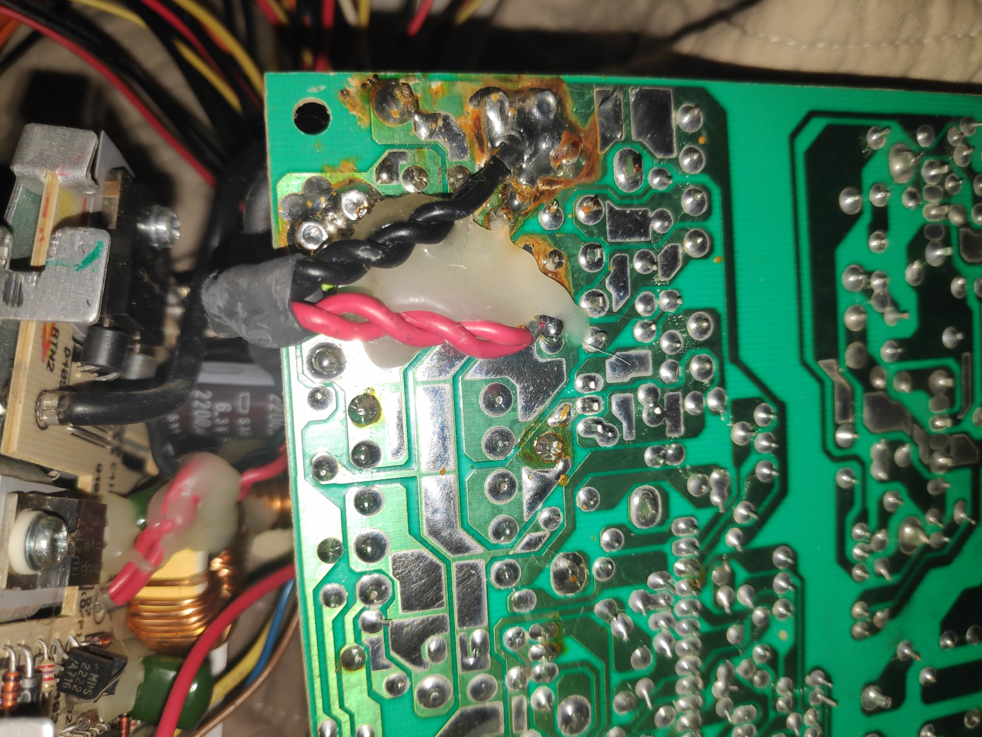

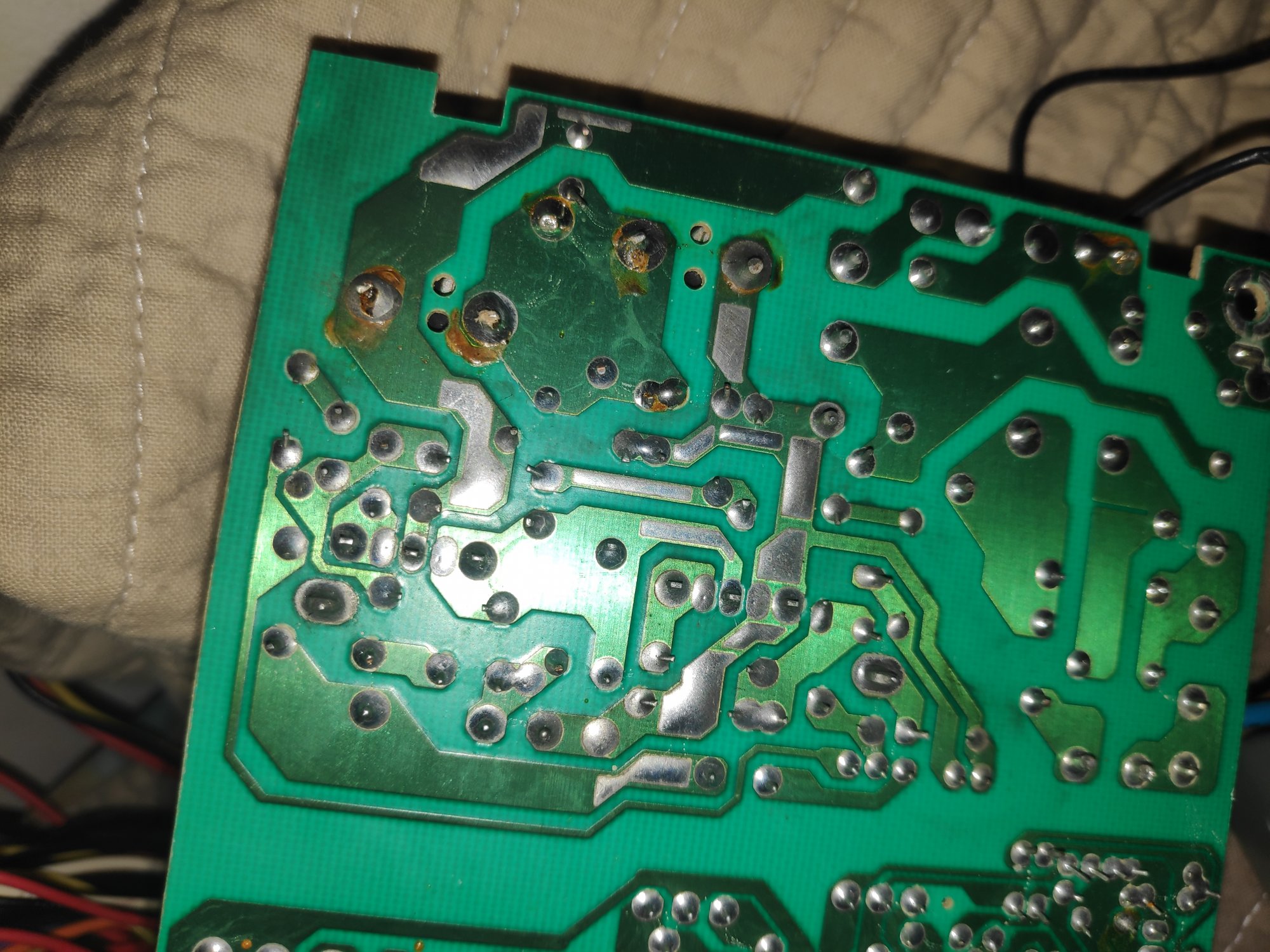

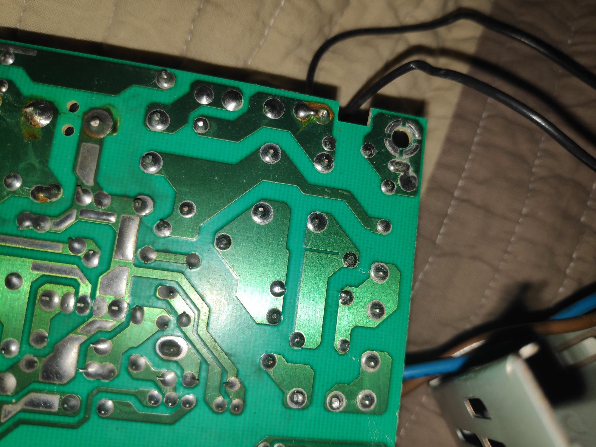

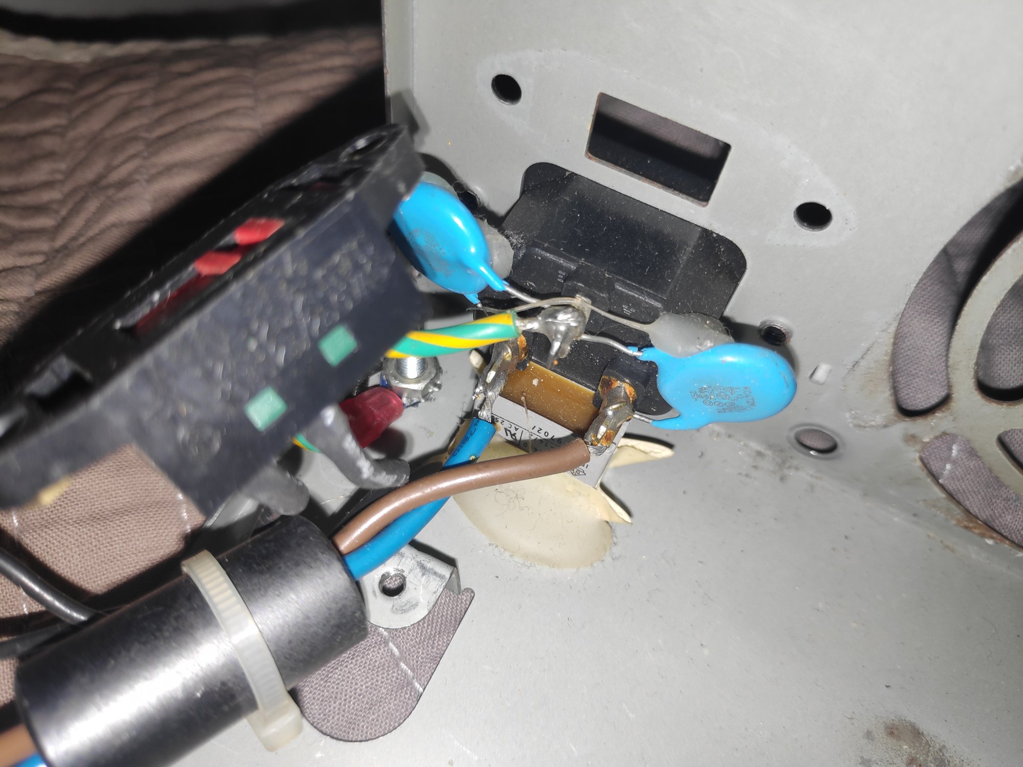

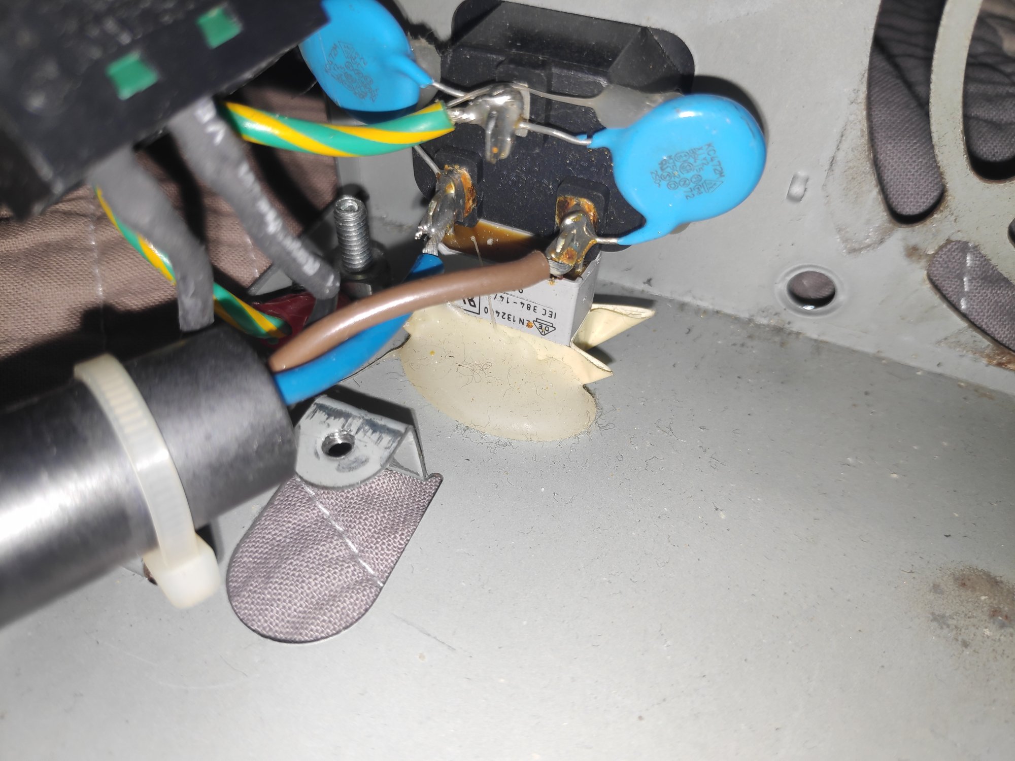

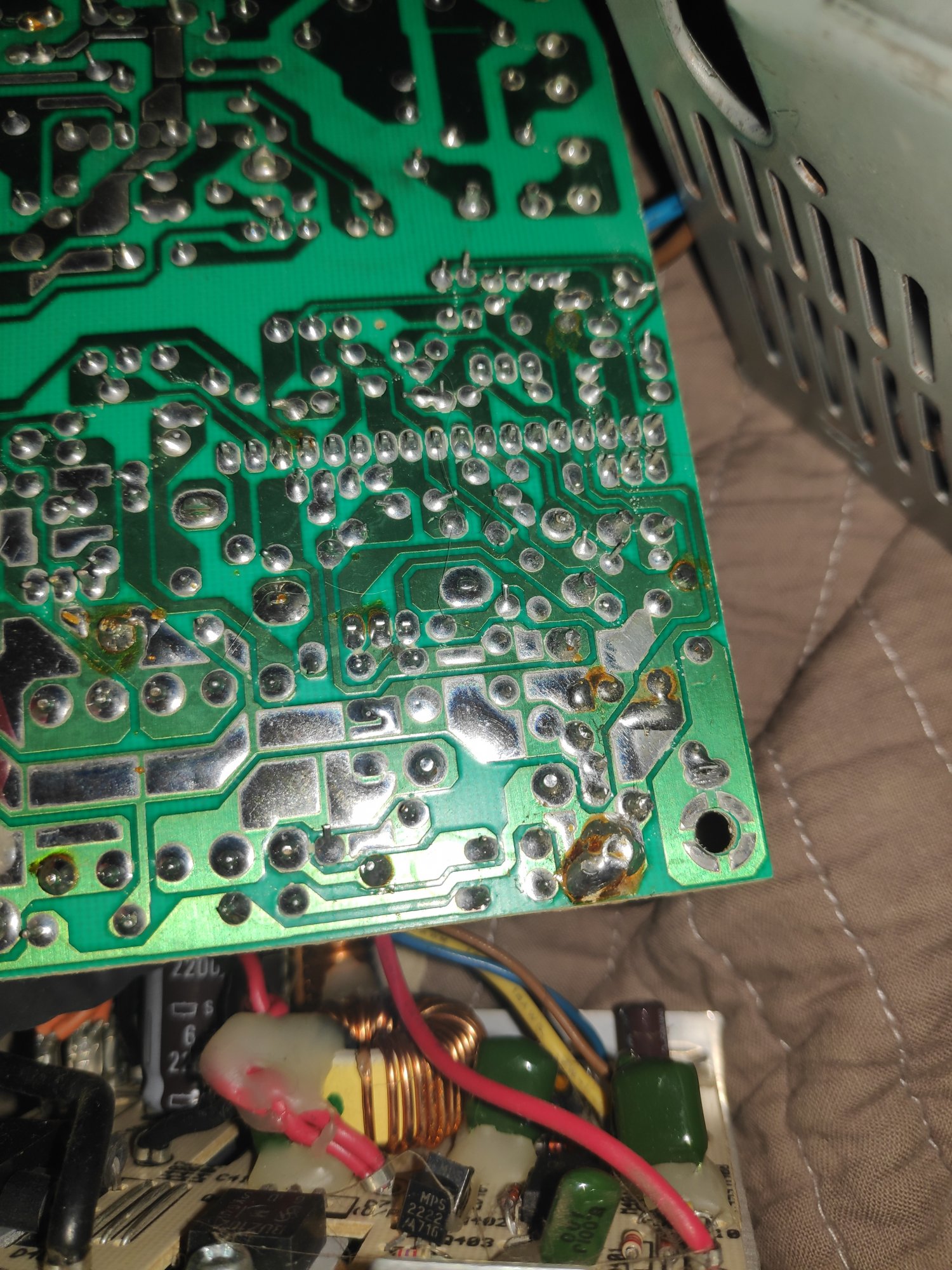

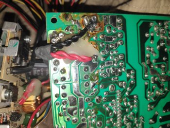

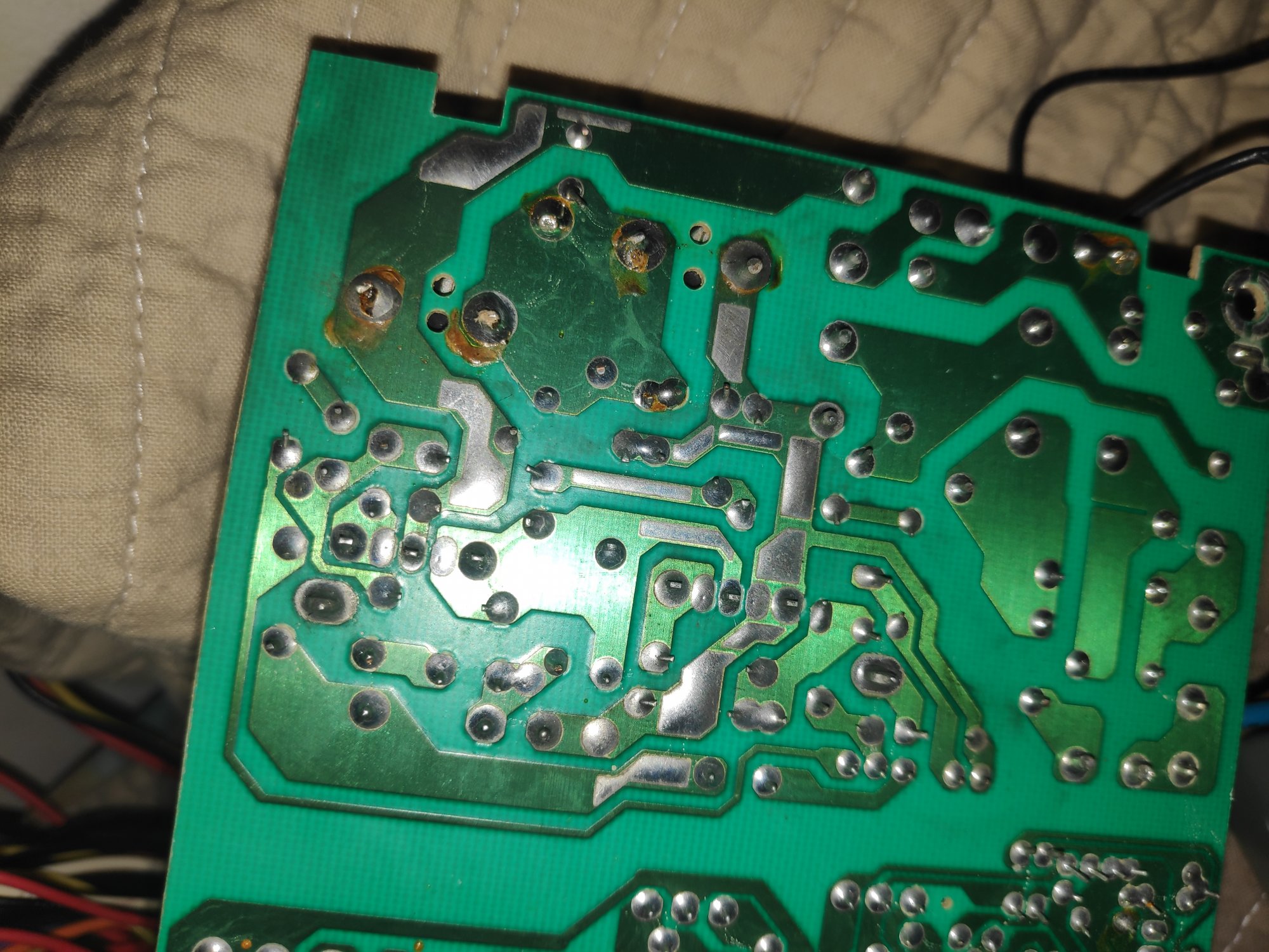

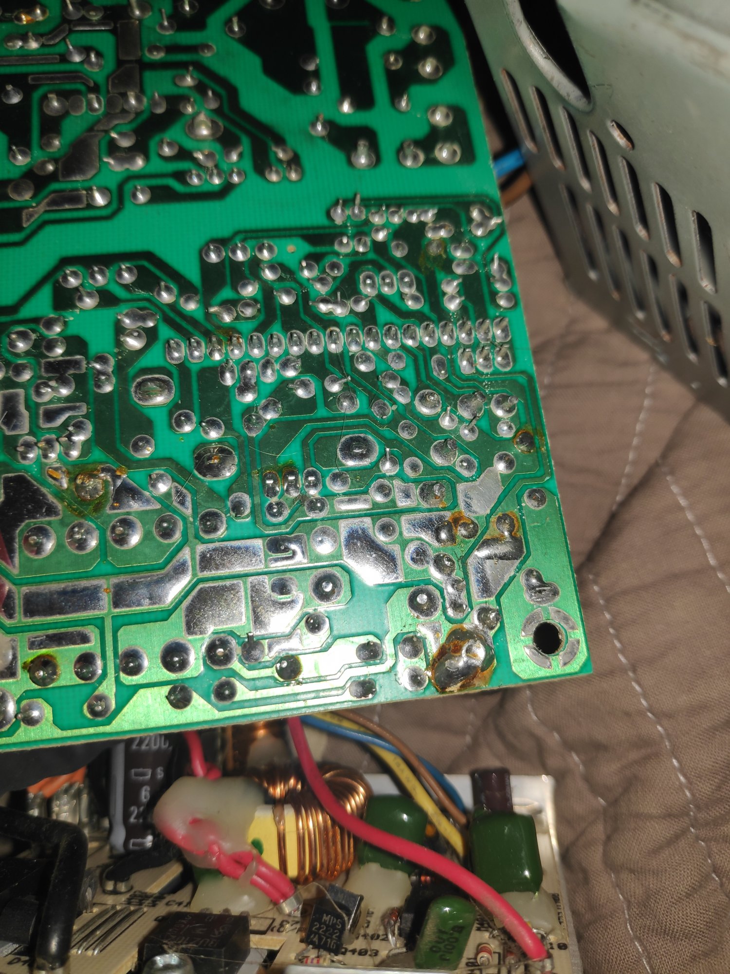

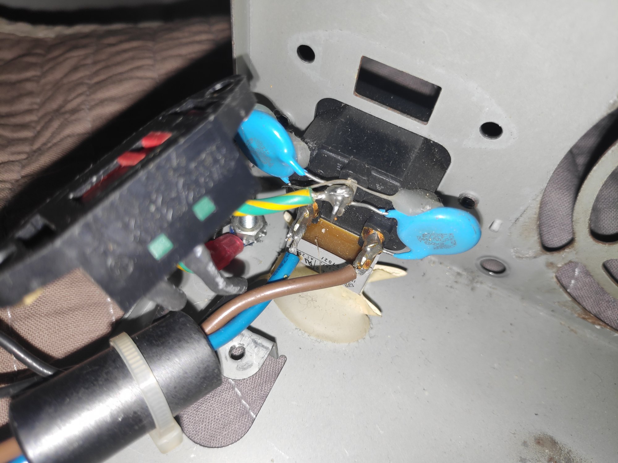

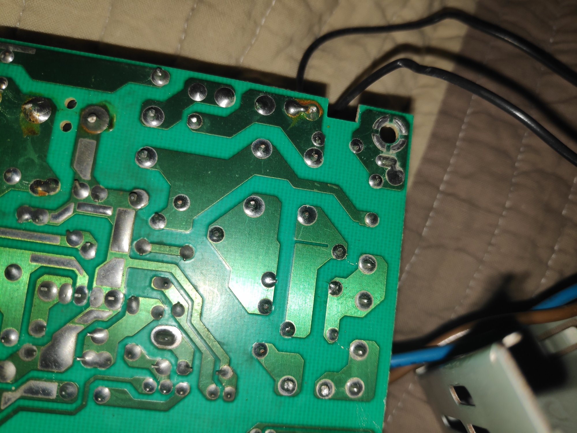

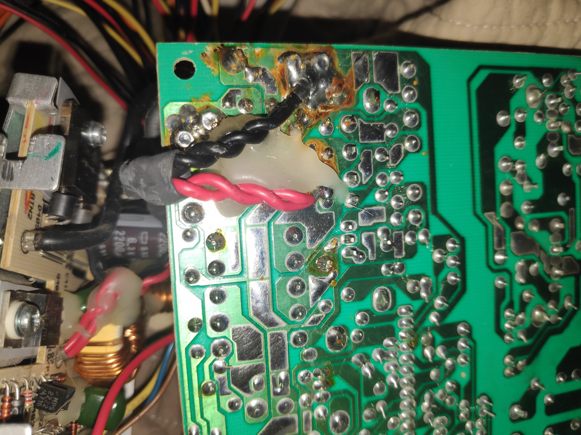

EDIT: I must have messed something up when I first put it together, but now it doesn't trip the breaker. And the clicking is back. Anyway I turned the PCB around and saw something that looked like decades-old flux residue or corrosion. I'm attaching some pictures of the PCB itself IMG_20191127_170946.jpgIMG_20191127_170950.jpgIMG_20191127_170954.jpgIMG_20191127_170958.jpgIMG_20191127_171007.jpgIMG_20191127_171021.jpg
