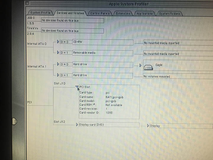

Hey Delta Mac,
It worked on the Eagle disk.

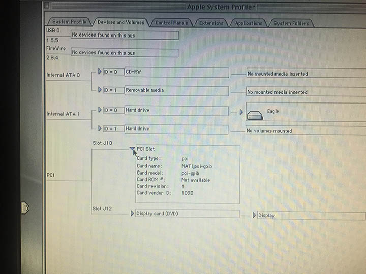

I went to system profiler and in the Devices and Volume tab I have the following.
That's good news!
If you didn't try yet, be sure to reinstall that GPIB driver software while you are booted to your present OS 9 system.
Does the software that is actually supposed to use that card work, too?
Just an old Mac lesson to learn here. The hardware doesn't necessarily cooperate with the software. Particularly, OS X systems don't always know what to do with OS 9 hardware, when it needs full hardware access. Better to boot to the native system for that hardware. Sometimes it all works together - and other times. you have to know how to "diddle" with the alternate OS.
SOMETIMES, when you reinstall from OS 9, then restart into OS X, then try Classic - that the hardware still knows what to do, because the driver is installed where it is needed for Classic, and not just OS X. Don't expect that to happen. You may just need to remember that you have to boot to OS 9 if you want to use the scanner, etc.

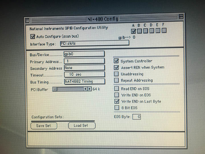

Cool thanks alot for the help. Right now I am not connected to the scanner because it is at my business location. I have the apple connected to a Dell 333 s/l controller unit. The dell boots up with the ColorGetter Software on a 3.5" disk inside the floppy drive.
Right now when I try to run my ColorGetter 5.2 software I get the message" Can't find Cologetter Software." which I was getting before. But right now, I don't have the apple connected to the scanner this is why I am still getting it. I hope so.
I am going to go try it tomorrow and keep you posted.
Now since I changed the boot sequence I have to run this old version all the time or should I start the startup in OSX when I install the driver you told me about right now? I think I might be ok. Here is the setup. The auto configuration box states slot one, but I have the GPIB card in the middle pci slot which I believe is slot 3. I don't know if this makes a difference or not.
As a matter of fact since the NI-488 config file is running I don't think I need to install any other driver?

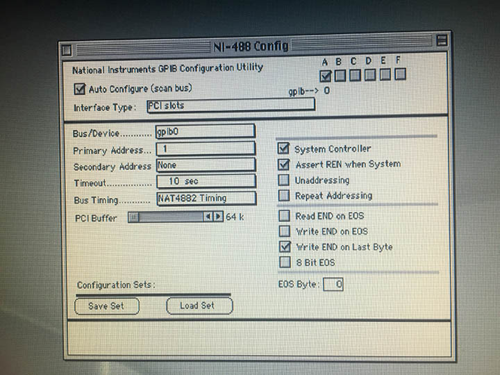

Here is a pic.

Cool! You MAY not need other software installed, I don't know...
All you can do now is try it.
I am pretty sure that if you install software again, it should be installed while you are booted to the system that you should use with the card, which will be OS 9, not OS X.

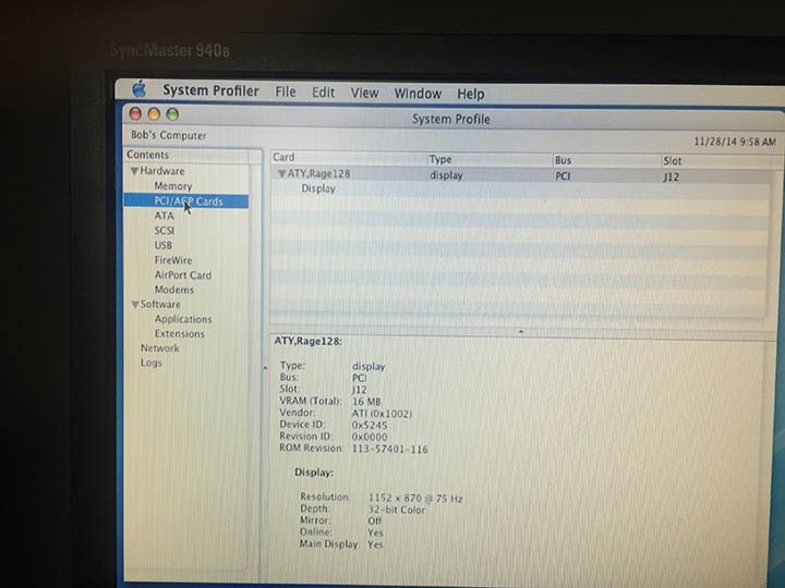

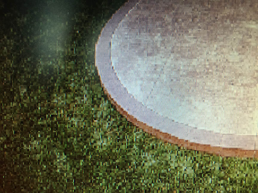

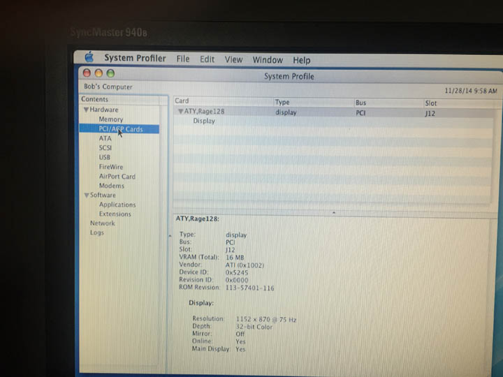

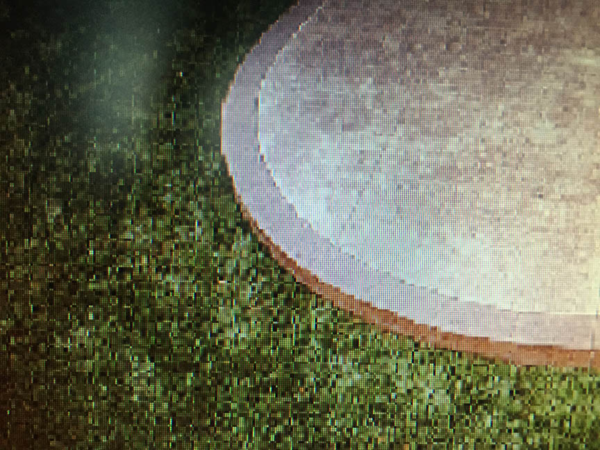

It is the original ATI 128. Here is what is happening when I view the image in OS 9.2 Delta Mac helped me out on the drivers for the GPIB card but they didn't work. I just thought he might have know of something else. He told me that it will probably have to run in 9.2. I like the way OSX is laid out better, but if I have to stay with 9.2 to run the scanner I will be happy with that, at least my scanner is running now.
Here is a pic for the ATI card and a sample of what the image looks like while being scanned. I transferred the image to my computer that has PhotoShop on it and preview at 100% the scans are clean. This is why I am assuming it's the Apple.
The Rage 128 is not exactly a great performing video card. It was okay for its time, but is definitely showing its age.
It would be nice if you could move up to G4 with an AGP slot, as there are a lot of cards available for that range of systems.
I'd suggest looking for a Mac-edition PCI Radeon 9200. This won't come cheaply, but it's one of the best performing video cards you can get for your computer without flashing a Windows card. Just be sure that you are in fact getting the Mac edition, or be prepared to learn how to flash it with the Mac ROM.
