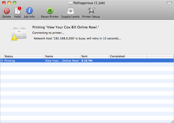

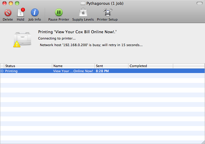

I don't know if this will help, but here's the error message I get from the printer when I try to print. If there is no way to get this to work, I'll buy another printer. However, I don't want to toss it in the trash before I try everything first--it has worked well for me up until my upgrade to Snow Leopard!

Use the Terminal command:
telnet {IP of Laserwriter}
It will offer you some simple menu commands like ? for help.
Read this if there's a password required:
http://forums.macosxhints.com/archive/index.php/t-20846.html
more info:
http://www.omnigroup.com/mailman/archive/macosx-talk/1997-September/002507.html
If you plan to use the IP protocol "LPD," it's important that you enter the printer's queue name (sometimes called port name) into the Add printer dialog in Print & Fax. Get the queue name from the printer's config page or printer's telnet "show config" command.

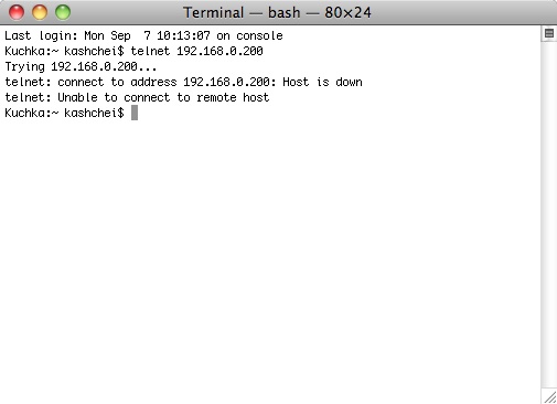

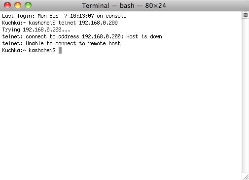

When I tried to telnet my laserwriter, I was told that the host was down and that I was unable to connect to the printer (I have attached the terminal screen below). If you have any other suggestions, I'm all ears! Thank you again for your help!

Please tell us what the local IP address of your Mac is - and some details of your local network, too - router IP, subnet mask, etc.
I don't have that printer - do you have the manual? Do you have the config switch instructions? Do you have it connected directly to ethernet and NOT through a localtalk bridge like Farallon or Asante?

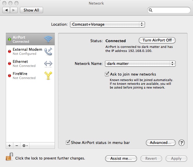

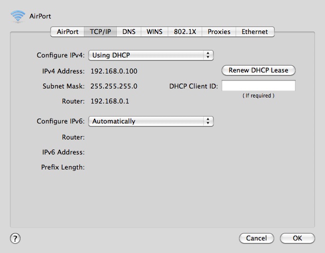

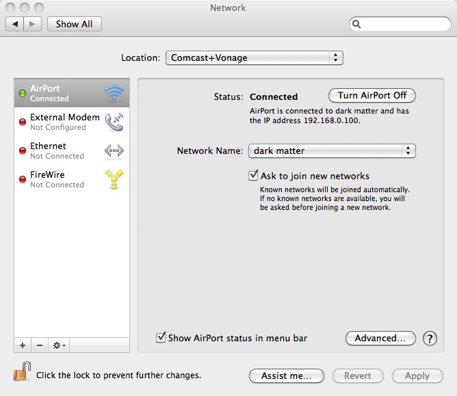

My IP address is 24.98.228.240 and my network info is attached below. Thank you so much for your help!

Ya, I meant the stuff on the right side, not your internet address.

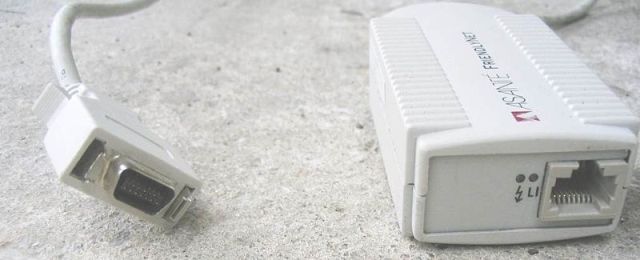

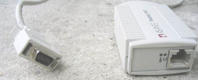

I'm not quite sure what you mean by a localtalk bridge. My printer is attached to my network by way of an Asante Friendlynet, which allows me to plug it into my router. I hope this helps and isn't TMI!
I think we're getting somewhere... I don't have Asante Friendlynet - is it a small ethernet port receptacle with a couple of lights, and a short cable that goes to a 3/4 inch D-shape connector on the printer - and NOT a small round Apple localtalk connector?

Here's a picture of a Friendlynet. I think you described it quite well.

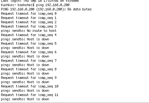

I don't know if this is going to help the diagnostic process or not, but after the update to 10.6.1 there's a change in results when I ping the printer's IP address. In the posts above, I was told immediately that the host was down. Now, the results are a bit different.
If this helps anybody to sort out this problem, I will be eternally in your debt!

Sorry - it still means that there isn't anything with the address 192.168.0.200.
