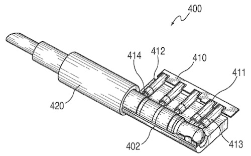

A newly-published patent application from Apple is generating some interest today for its description of a means to reduce the size of headphone jacks by using pogo pins instead of the traditional cantilevered metal strips for mediating electrical contacts with headphone plugs.

Apple points to the current "cantilever beam" design for headphone jack contacts as requiring significant space in two dimensions to accommodate the contacts while also requiring sufficient length to ensure the necessary leverage to maintain contact with the headphone plug.
Cross-section of headphone jack showing pogo pin contacts
Switching from the cantilever beam to a series of spring-loaded pogo pins lined up along the side of the headphone jack could allow the jack to essentially require space in only a single dimension, allowing for thinner device designs.
The pogo pins can be positioned in the audio jack using any suitable orientation. In some embodiments, the pogo pins can be positioned in substantially a single plane such that the pogo pins require space in a single dimension of the audio jack assembly. The pogo pins can be oriented substantially orthogonal to the audio jack cavity (e.g., such that the deflectable tips extend orthogonally into the cavity), or at an angle relative to the cavity walls.

I don't get how this is smaller is that not a standard 3.5mm headphone wire in the picture?
It has to do with how small a form factor you can get with the jack when installing it in a component like an iPod. Pretty much all current headphone jacks rely on bent pieces of metal that act like springs to press against the contacts. That bent metal spring requires a decent amount of space. By switching from that to pins backed by springs you can shrink the overall size of the jack. This will let them manufacture jacks that are just a hairs breadth thicker than the 3.5mm headphone plug itself.

Right, the confusion is coming from the article saying this will allow for thinner devices, when really it's just allowing the headphone module to be no deeper and barely any wider than the headphone port itself, saving internal volume. The diameter of the headphone jack is still going to be a limiting factor on the thinness of the device.

If you look closely inside the the headphone jack of the iPhone 4 the top the pins are already using this technology. The top one is very obvious...you can see the little ball that looks like the tip of a ballpoint pen sticking out inside the jack.
