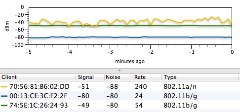

Oh man, 5 Ghz is now all over the place. My MBA is a few cm away from my TC and rate (from 300 to 180) and signal (from -25 to -51) drop quite a lot, not much, but it was completely stable before the update. Also I have more noise on 2.4 GHz now (-80 instead of -88), what the heck.
