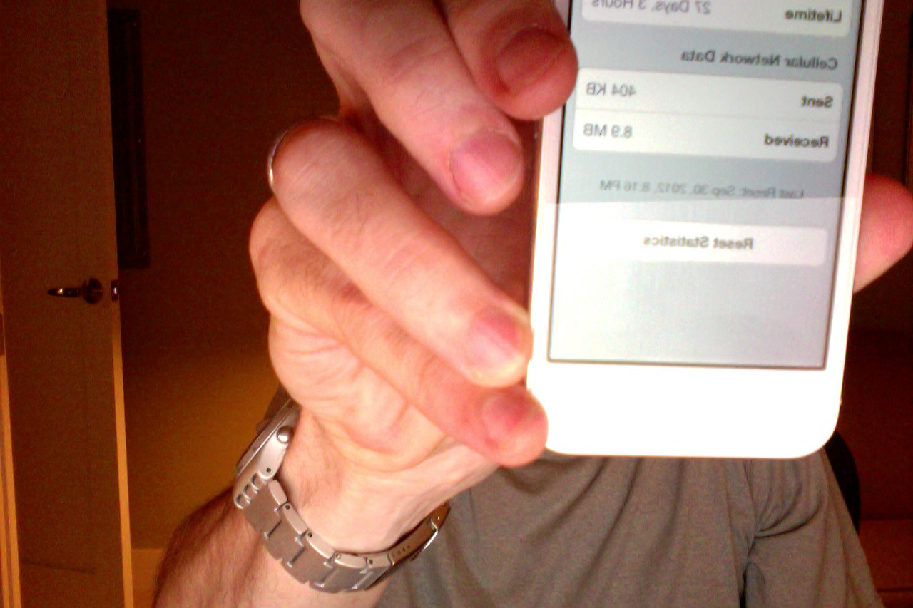

Massive data per web page on Verizon iPhone 5
I, too, have used an exorbitant amount of data (> 2 GB in less than a week, NEVER exceeded 2.4 GB in a month previously) while using LTE. However, I noticed that the data per web page seems incredibly excessive. Here is a photo of a single loading of a NYTimes web page (9MB!)--I zeroed out the data prior to this image. It often ranges 12-20 MB per web page. Of course, the normal content is about 300-1200 KB. Anyone else experience this? Verizon and Apple seem flummoxed by this . . .

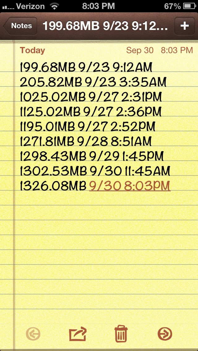

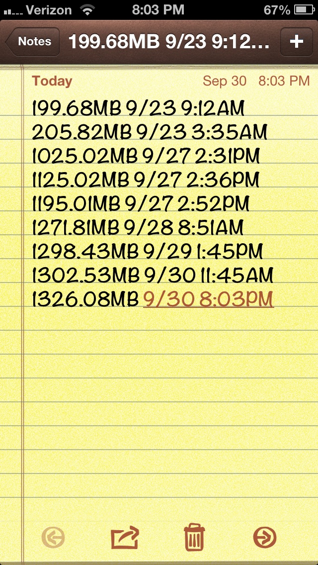

Yeah, very happy about this. My data usage was sucking. 95% on wifi! One night I fell asleep to several Netflix shows and woke up to 800 mb increase. Did one Siri search on wifi and gained and extra 100mb. I didn't record four day cause I had forgotten to but the 1000mb was at ~200-300 the night before.
