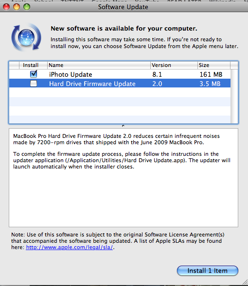

This update only applies if you BTO'd your MacBook Pro with a Seagate 500GB 7200RPM drive and only that drive. If you replaced the HD yourself, then it's an aftermarket drive and Apple does nothing for that.
That is incorrect. The 320GB 7200RPM BTO drive has the same problem. This update will show up in Software Update if you have the 7200RPM 320GB drive, and it definitely updates the firmware for it.
This appears for a 2009 MBP with the 7200rpm drive, but not for one with the stock drive.
Note Apple makes no claims about freezing, either the momentary one associated with the clickbeep issue, or the longer near 30 second ones. It only talks about "reducing certain noises".
Even better, "infrequent" noises. Even though my 2 drives (original one which failed all S.M.A.R.T. tests, short and long, and AppleCare replacement) click+beeped only a few times per day, those youtube videos clearly showed some seagates clicking and beeping pretty regularly... PR department working overtime at Apple anymore.

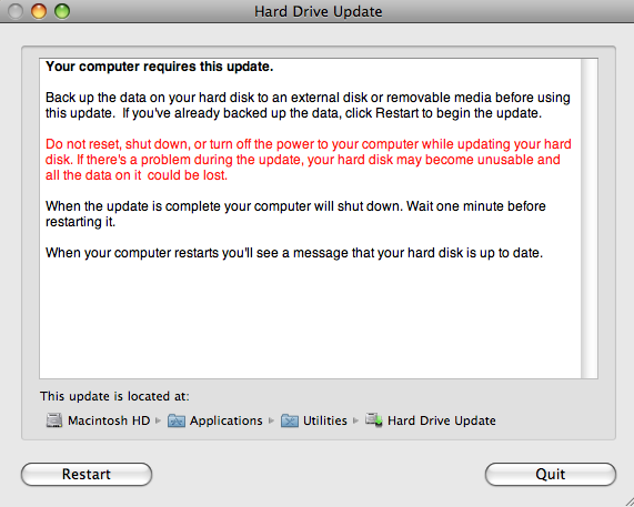

BACK UP
Your computer requires this update.
Backup the data on your hard disk to an external disk or removable media before using this update. If you're already backed up the data, click Restart to begin the update.
Do not reset, shut down, or turn off the power to your computer while updating your hard disk. If there's a problem during the update, your hard disk may become unusable and all the data on it could be lost.
When the update is complete, your computer will shut down. Wait one minute before restarting it.
When your computer restarts you'll see a message that your hard disk is up to date.

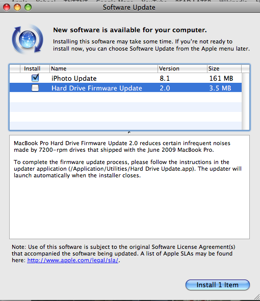

Both? You mean you don't have iLife '09 (assuming that you are talking about the screen shot posted by t0mat0 / #32).
No - I'm pretty sure there was an earlier update to this hard drive issue and that this is version 2.0 of the update. Not talking about the screenshot.
