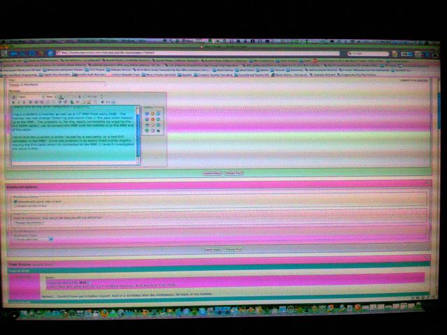

I have a HANNS-G monitor as well as a 17" MBP from early 2008. The monitor has had strange flickering and weird lines in the past when hooked up to the MBP. The problem is, for me, easily correctable by wiggling the DVI-HDMI cable I use to connect the MBP with the HANNS-G at the MBP end of the cable
I think that the problem is either caused by a bad cable, or a bad DVI connector in the MBP. Since the problem is so easily fixed just by slightly moving the DVI cable when it's connected to the MBP, I haven't investigated the issue further.
I have attached two JPG images of what it looks like. The one with the pinkish lines is exactly the distortion and fuzziness that occurs with my MBP when the connection is not good. The other is when it looks ok. Keep in mind that the shaded horizontal lines are just because of screen refreshing being captured by the iPhone's camera and are not something that I normally see.
Of course, my situation is not the only situation out there, but hopefully this information will help.
