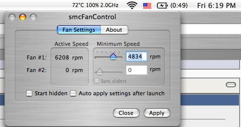

Good: Notebook is only 30° C
Bad: Fan blasting @ 6KRPM (really unnecessary, can't even use this in class without disturbing the rest of the people in there)
HOw do you know your fan speed? I wanna see those too...
See below. And no, I didn't use smcFanControl to set it to 6K. Can't even use it to lower the speed.

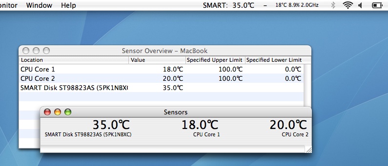

I'm pretty sure readings of 15C-19C are incorrect. I've NEVER seen or heard of modern laptop/desktop CPUs running that cool.
I'm sure you're correct but I'm confused as to what results to believe.
I'm now using istat Pro, Temperature Monitor and Core2Duotemp. All are saying the same thing.
See the screen grab below.
If I put the machine under stress it does go up to 50 or 60 degrees but generally, it's saying around 21 when idle.
Mine used to get stuck at low temperatures like that. It's a glitch in the CPU's measuring stuff.
Download the latest version of smcFanControl. It has a temperature reading, but uses a sensor on the logic board rather than the one on/in the CPU. I get a more accurate temperature now. With my minimum fan speed at 2500rpm, I get idle of around 46ºC. and gets up to about 77/78ºC when pushed, but of the course the fan kicks in then and keeps it in check.

Reset PRAM, apparently that broke CoreDuoTemp sensor because mine is reading 12°C, iStatPro is reading 12° C as well, but smcFanControl is reading 72° C. Week 27 MacBook by the way. So my suggestion is, if your MacBook has no issues or you are fine with how it is running right now, DO NOT UPGRADE THE FIRMWARE.
