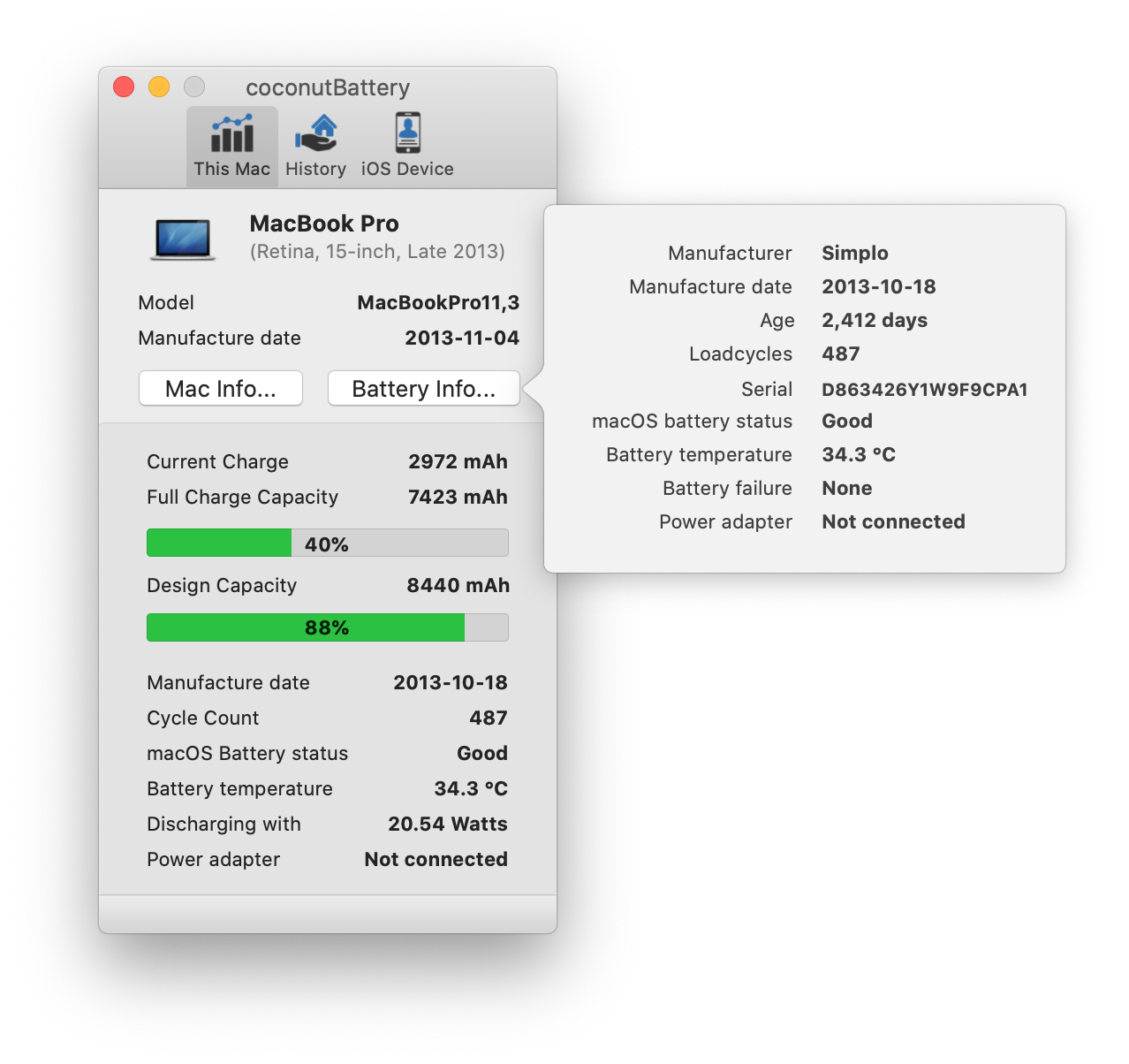

Do I really need this battery option enabled? I feel like I have been doing just fine before any kind of Apple optimization of my battery. Just don't trust them after the iOS fiasco with "optimization".
Battery degradation is not a linear process. Just because it degraded 12% in 7 years doesn’t mean it will take another 7 to degrade a further 12%.

Battery degradation is not a linear process. Just because it lasted 7 years doesn’t mean it will last another 7.
(Sorry if I’m not donating my time even further by spending time searching for “the science” to link, as some posters here appear to demand; if perchance you’re one of those, we can discuss my going rates for consulting, and if you’re not, just pretend I never said anything.)
