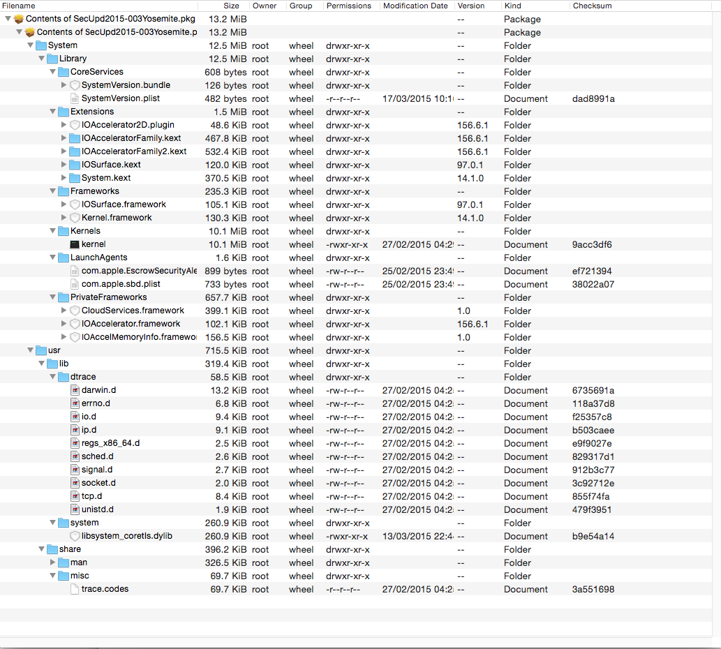

Maybe not but this is inside the Security Update:
Edit: System version of this update is 14C1514

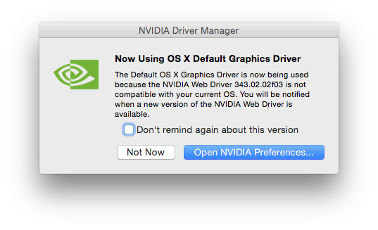

Screwed me big time.
I just installed Yosemite specifically so I could drop a GTX970 in.
I've got a GTX285 official mac card, a flashed GTX 680 4GB card (which has been giving me problems, locking up during renders) so thus the GTX970.
Prior to getting the card I updated to Yosemite tonight.
Bad Idea Jeans.
To cover all the bases I downloaded:
343.01.01f03 for 10.10.0
343.02.01f01 for 10.10.1
343.02.02f03 for 10.10.2
Because I have next to zero net here (on a wifi hotspot) I pulled down the Yosemite installer from work, put it on a USB flash drive and dropped it on my boot to install. Install was fine on the flashed 680, had boot screen, no issues etc.
Went to install the drivers in prep for swapping out to the 970 and that's where the problems started.
NONE of the installers would run.
OK, fine, following the lead of other folks on the forum I got pacifist and had IT install the one for 10.10.2.
While it'll boot the screen updates are abysmally slow.
Pref pane won't run. At all. Says to go to the website and get a new installer. Tried that. No joy.
Ok fine, pull the 680 and put the 285 back in. Same deal. Ok fine, pull the 285 and put the stock 120 in. Same deal. In fact on login it repaints the screen from bottom to top about 10 times, taking 6-8 seconds per sweep up the screen. Windows tops are painting funny and the whole box is just sluggish as hell (MP 5.1 DP Xeon 8 Core).
Ok fine, dug into the pref pane, manually fired up the uninstaller (which did work) however on reboot after that I'm still at the same place with a more or less utterly unusable machine.
No clue what to do now.
Prior to this had 10.9.whatever installed, with the CUDA driver for the 680 4GB card and it was working fine. Now nothing works.
I picked the wrong day to install 10.10. Now thanks to Apple's fine insistence on installing the latest and greatest the second you install, I'm utterly dead in the water.

You'll need to wait until nvidia updates their drivers. For some reason the drivers look for a specific OS build number and refuse to work properly if it changes (which the last 2 Yosemite security updates have done).
Check out www.xlr8yourmac.com for updates, the owner of that site is very good with updates on nvidia driver releases.
Never got my 970 to work with the Nvidia drivers so send it back. It worked, but at slower then 680 speeds so didn't see the point. Shame, would have loved me some smooth 4K editing.

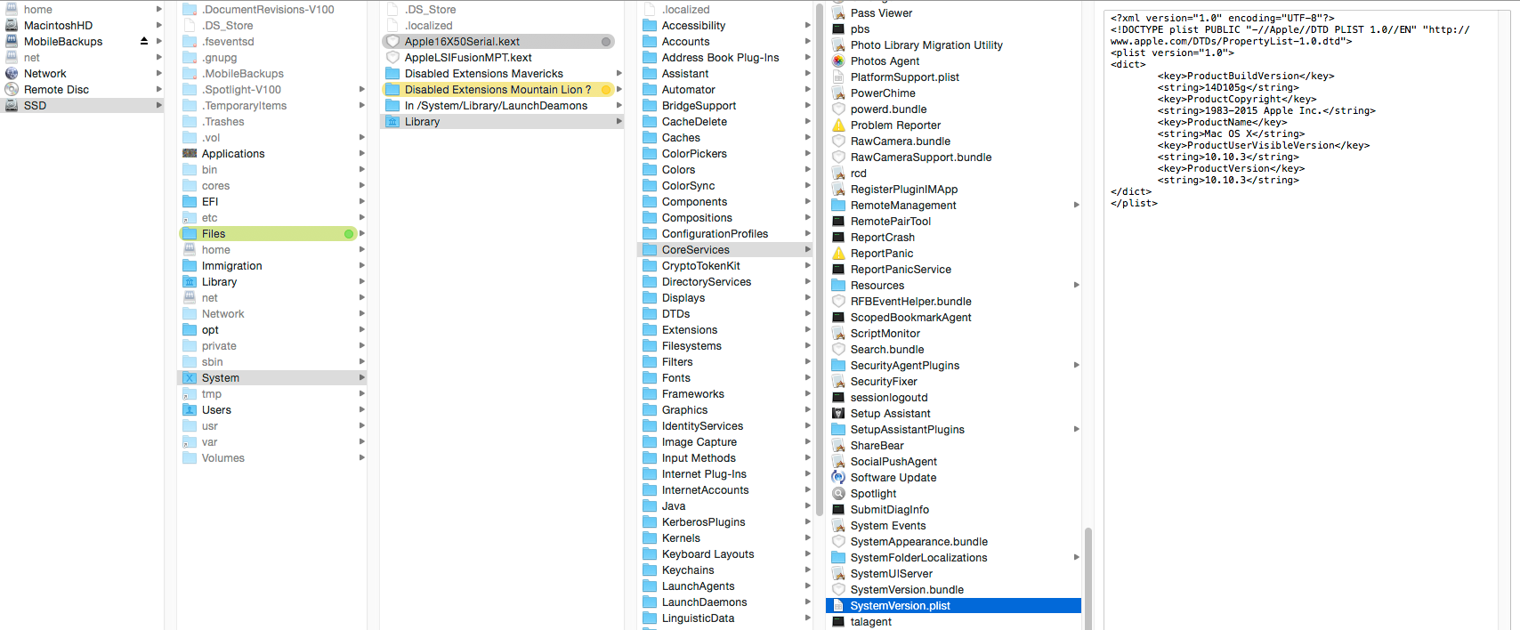

It might help to change the Systemversion.plist to the earlier one, or just edit it to reflect an earlier supported System.
But, you'll need to do this as root.
Edit: The screenshot below is of a newer 10.10.3 System, just wanted to show where the file resides on the disk.
Thankee, will give that a go.
