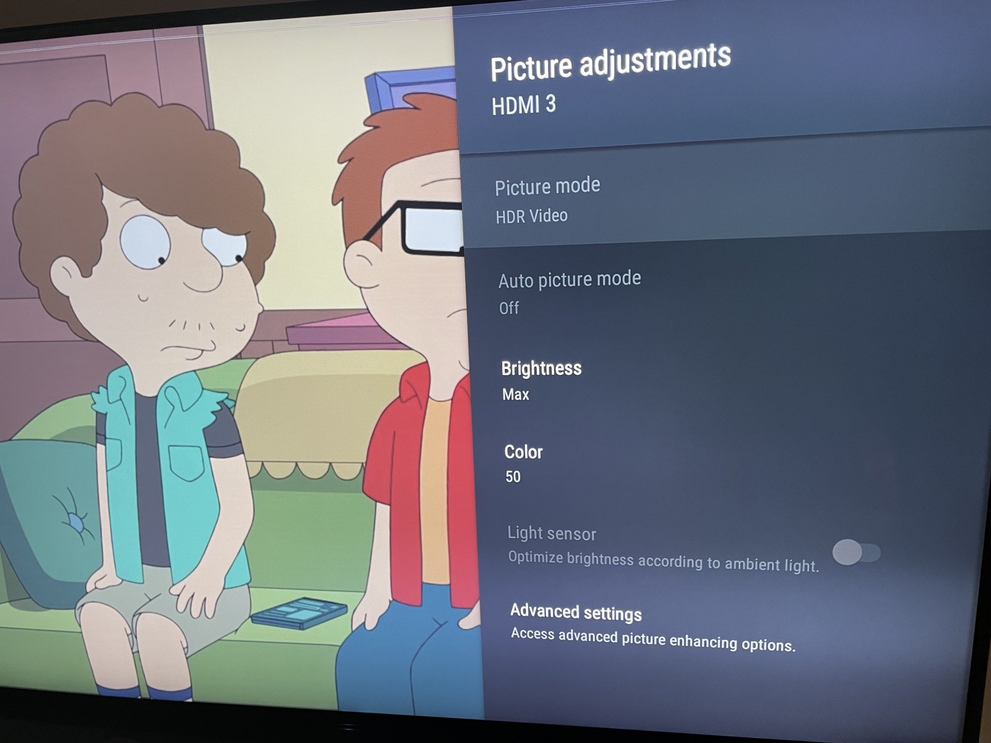

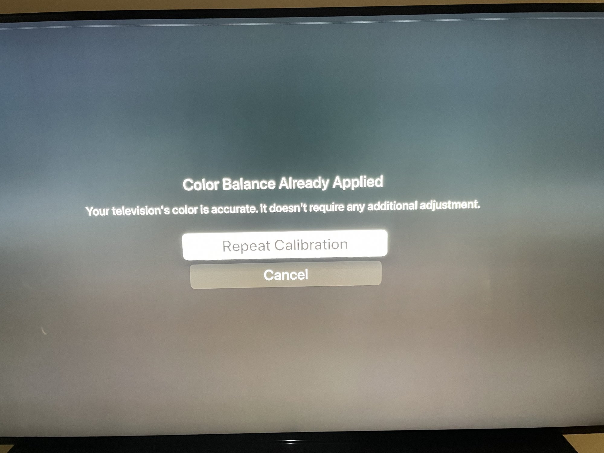

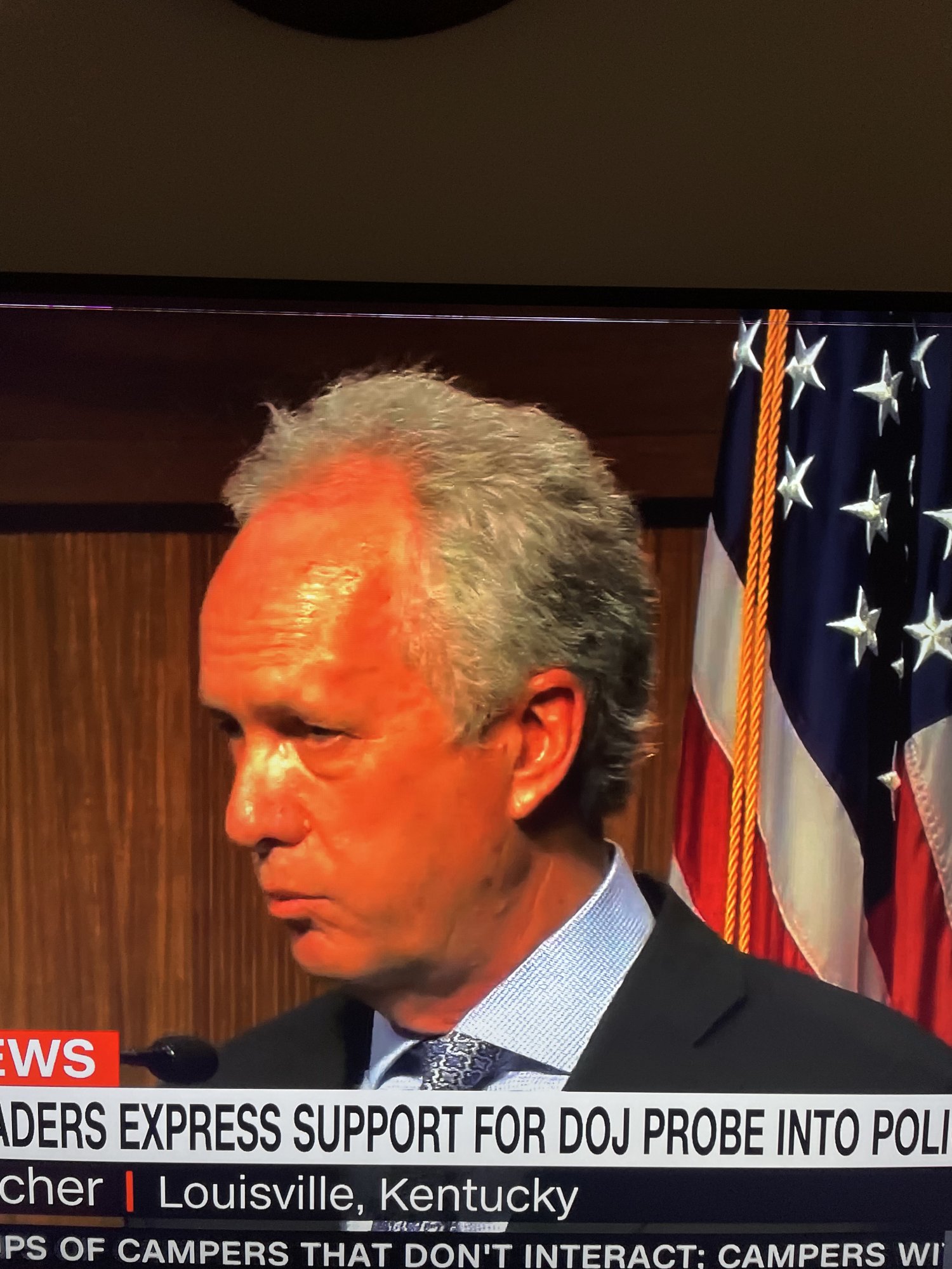

Hmm so color balance didn’t fix the long known issue of android Sony TV.
when HDR is enabled in Apple TV, Sony Android TV forces hdr mode on everything, the result everything is reddish and the brightness is low.
Balance mode didn’t see an issue but I will leave you to judge. (I know HDR must be matched with hdr content but match feature should disable it when the content isn’t supported)
back to disable hdr like I’ve been doing for years
Clarify please. Are you watching content via the ATV or are you watching content via the Android TV built into your Sony’s firmware? The ATV calibration will only affect what you watch via the ATV. It will not change the colors for content viewed via Android TV, Fire TV, Roku, OTA TV, etc.
After rereading your comment it looks like you are watching content via the ATV, but if you set it to use HDR all the time, it messes up. If so, as you said, turn off the forced HDR. I have a Sony Bravia XBR49X800H and I set my ATV 4K to use the Format option of 4K HDR, but I set the Match Content options to Match Dynamic Range and Match Frame Rate. With these settings my TV doesn’t mess up the colors like your seems to do. It could be the difference of the two TVs though.
This is interesting, it’s ether you’ve able to fix this issue or you got used to bad color experience.
I only use Apple TV, my Sony tv (XBR-55X930D) which has android firmware (8.0) controls input and pictureforces picture mode to HDR all the time when hdr enabled on Apple TV even if match option is activated.
to test it you got used to bad colors, switch to sdr and change your tv picture back to standard and see if you the picture is much better, you might be shocked

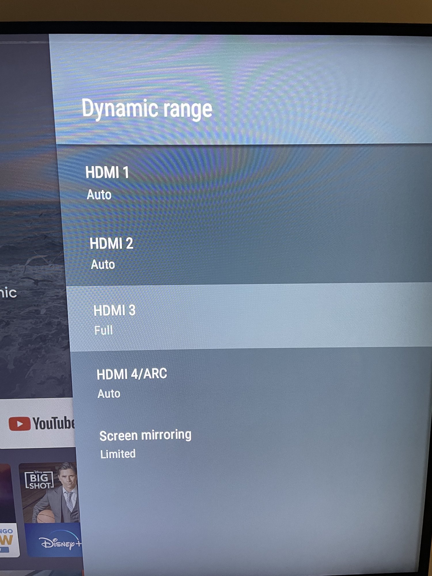

more on it here

I just ran the new iOS 14.5 / tvOS 14.5 color calibration on my Sony Bravia XBR49X800H 2020 4K TV.
I used the Cinema color setting option because most experts say that is the option which Sony claims is the closest to the best out of the box calibration. In other words, it is supposed to be the most color accurate. The ATV color calibration feature appears to have made a very slight change by making the picture a tiny bit warmer. Other than that I cannot see any obvious changes. However, the Sony Bravia TVs do have a reputation for really accurate color calibration out of the box. It will be interesting to see if this makes a big difference with a TV that has poor color calibration.
BTW, the ATV color calibration showed me the attached beach scene to illustrate the before and after differences. However, that is perhaps the absolute worst scene to use as the sandy beach has almost no frigging color in it! Apple really needs to think through what they are doing. I snapped the attached photo of my TV using my iPad Air 2020 and made no color adjustments to it. Comparing the photo to my TV set after the color calibration it does appear that the sand on the left is slightly warmer in color. Apple really should use a better image though that will well illustrate any changes.
I’m happy with the colors on my TV after the calibration, but they are nearly the same as prior to it so the improvement was very slight in my case. Hopefully it can really improve those TVs that need a lot of adjustment. Second attached photo is a better view of my colors after calibrartion, taken with my iPad Air 2020.
You have Apple TV HDR enabled and the Sony system allows you to use other display options other than HDR??
When ATV HDR is enabled, Sony forced HDR and grays out the option to change it.

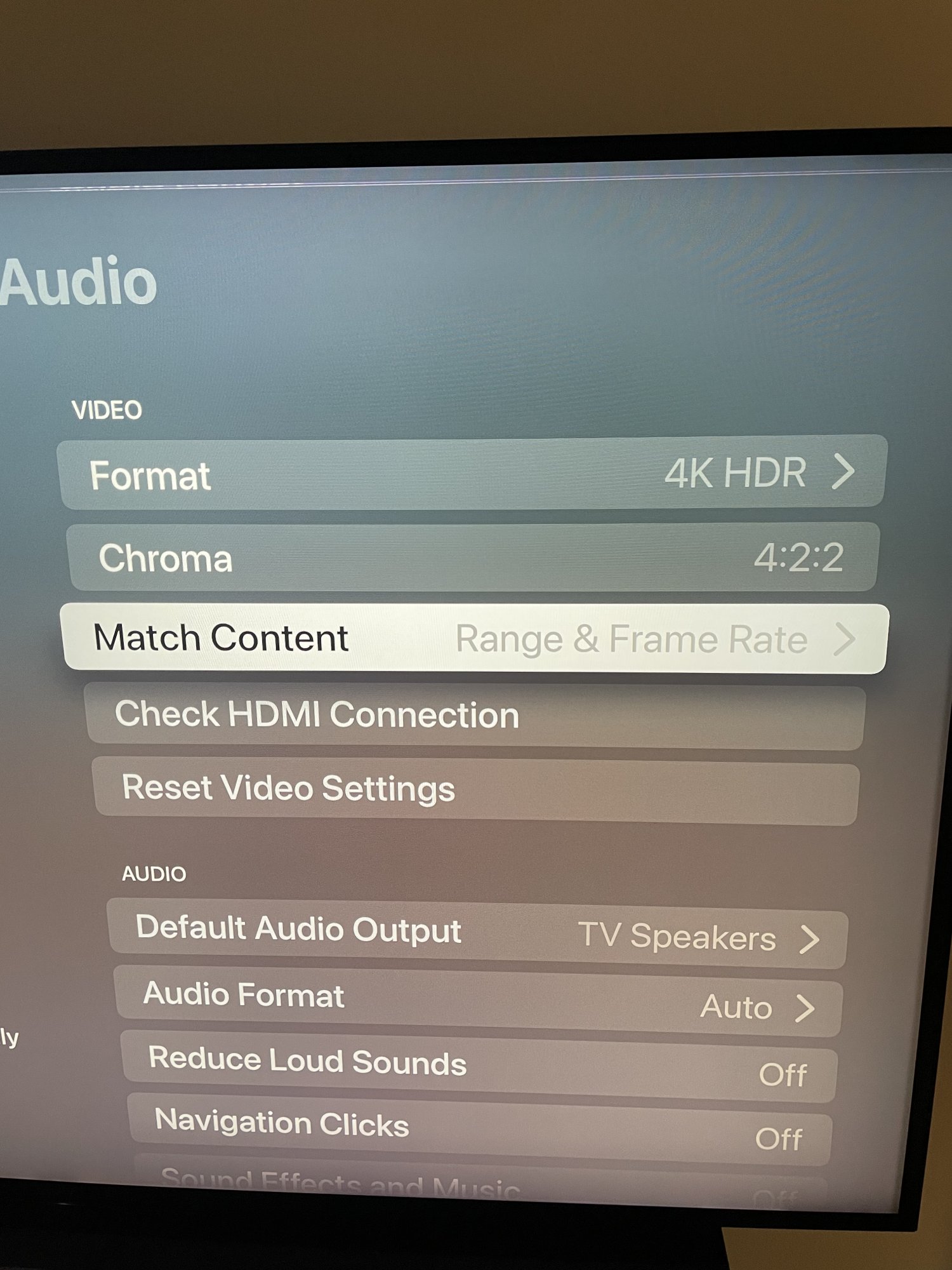

I’ve never encountered the issues you are having. Again, it could be the difference in our TV models. I have format on ATV to use 4K HDR, but I also set the Match Content options to Match Dynamic Range and Match Frame Rate. See the attached image. Setting it to 4K HDR is different from setting it to 4K Dolby Video. I do not have Dolby Vision enabled. Doing so would force DV and HDR for everything. I leave it turned off. If a show is using DV, then it will be applied, but not for all shows.
I also set the Sony’s Android TV HDMI 1 port which my ATV plugs into to use use enhanced signal format. I don’t know if that matters for this though.
I've never seen this issue either and I have an XBR-55X900E. My ATV is set to output 4K SDR by default, but with HDR enabled and "Match Content" on.
more on it here
This might be the reason I’m not having the issue: Your TV is running Android TV version 8 and mine is running version 9.

So just to be clear, even if you have match content on, theres a potential hiccup that is probably still blocking people from using this feature. When you set your default screen resolution, if you pick the obvious top choice, it is 4K HDR (or something like that). What this does, is make the Apple TV menu display using dolby vision, but your content still matches it's intended source. You actually want to make your default 4K SDR, which will then make your menu SDR, and consequently allow you to use the color calibration tool for non dolby vision content. (I'll preface all that with a strong 'I thinkkkk?').

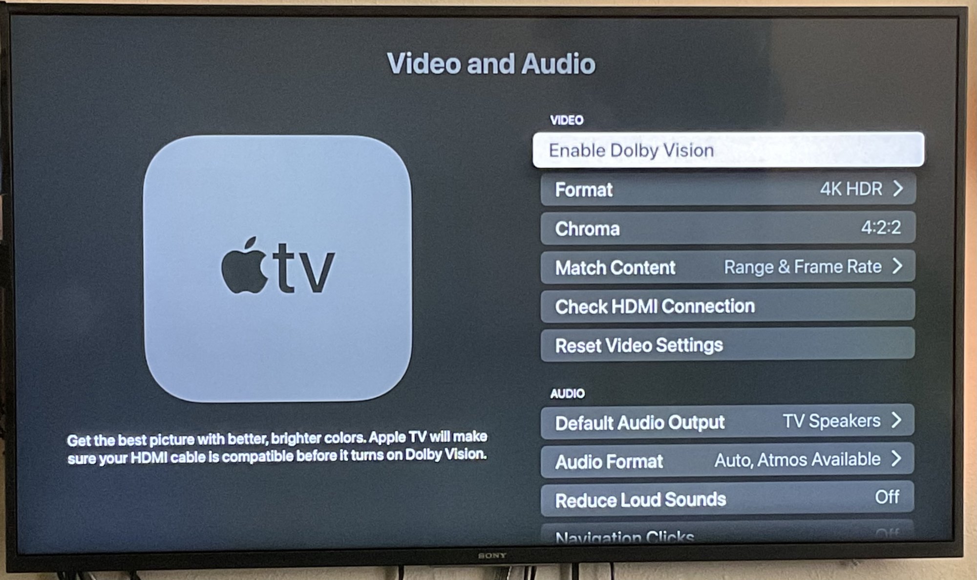

That is incorrect. There is a Format option named 4K Dolby Vision and a different option named 4K HDR. Both can be selected at various frame rates. The Format option named 4K Dolby Vision is not he same as selecting the video option at the top of the menu that is named Enable Dolby Vision. If you select the Enable Dolby Vision then you will force all video into Dolby Video. I’m using the Format option of 4K HDR and I’ve got Match Content set to match dynamic range and frame rate. It does NOT force everything into Dolby Video with those set. Obviously Apple made the menus confusing!
The attached image illustrates my settings. With these settings I am able to run the calibration without issue.
