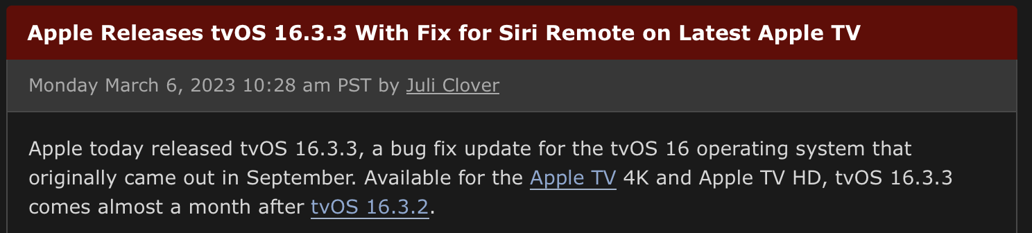

Which model of Apple TV do you have? I'm starting to suspect this was only released for the newer 4K models (5th gen and/or 6th gen only).
Article says "Note that this update is only for the third-generation Apple TV 4K."
I wouldn't bother trying to update older ATVs. The update is only to fix Siri remote connectivity issues on the latest model. Older ATVs don't have this issue and so don't need the update.
My remote has randomly disconnected a few times, but after the first time I discovered by pushing the back and volume + button at the same time (this is what you typically do to pair a siri remote) connectivity would be restored. Hopefully this update take cares of the issue completely though.
Aha… yeah I went back to using the original Siri remote - the one people apparently hate - but it Just Works™ I had also tried the new Siri Remote when it came out on the 2nd Gen. 4K Apple TV - it too would disconnect often and stop working. The new Siri remote looks like it's built like a tank but it's been so dang flakey! I still like the old flat black Siri remotes. 🤷‍♂️
Article also says it's "available for the Apple TV 4K and Apple TV HD."
I accept that it is confusing. It is contradictory and if Macrumors did less copy and paste from old articles, there might be fewer contradictions.
I have both 3rd gen ATV 4K and ATV HD. I got the update for 3rd gen ATV 4K but not ATV HD. When checking the ATV HD for updates it will just say "Your Apple TV is up to date" and that is with tvOS 16.3.2 installed.
Now go to the source of the information directly at apple: https://support.apple.com/en-us/HT207936
This may also add to the confusion because near the top it says: "Discover the latest features of tvOS available on Apple TV 4K and Apple TV HD."
Then it says
"What's new in tvOS 16.3.3​
This update fixes an issue where the Siri Remote can become unresponsive on Apple TV 4K (3rd generation)."
This means tvOS 16.3.3 is only available for the 3rd gen ATV 4K, not ATV HD.
