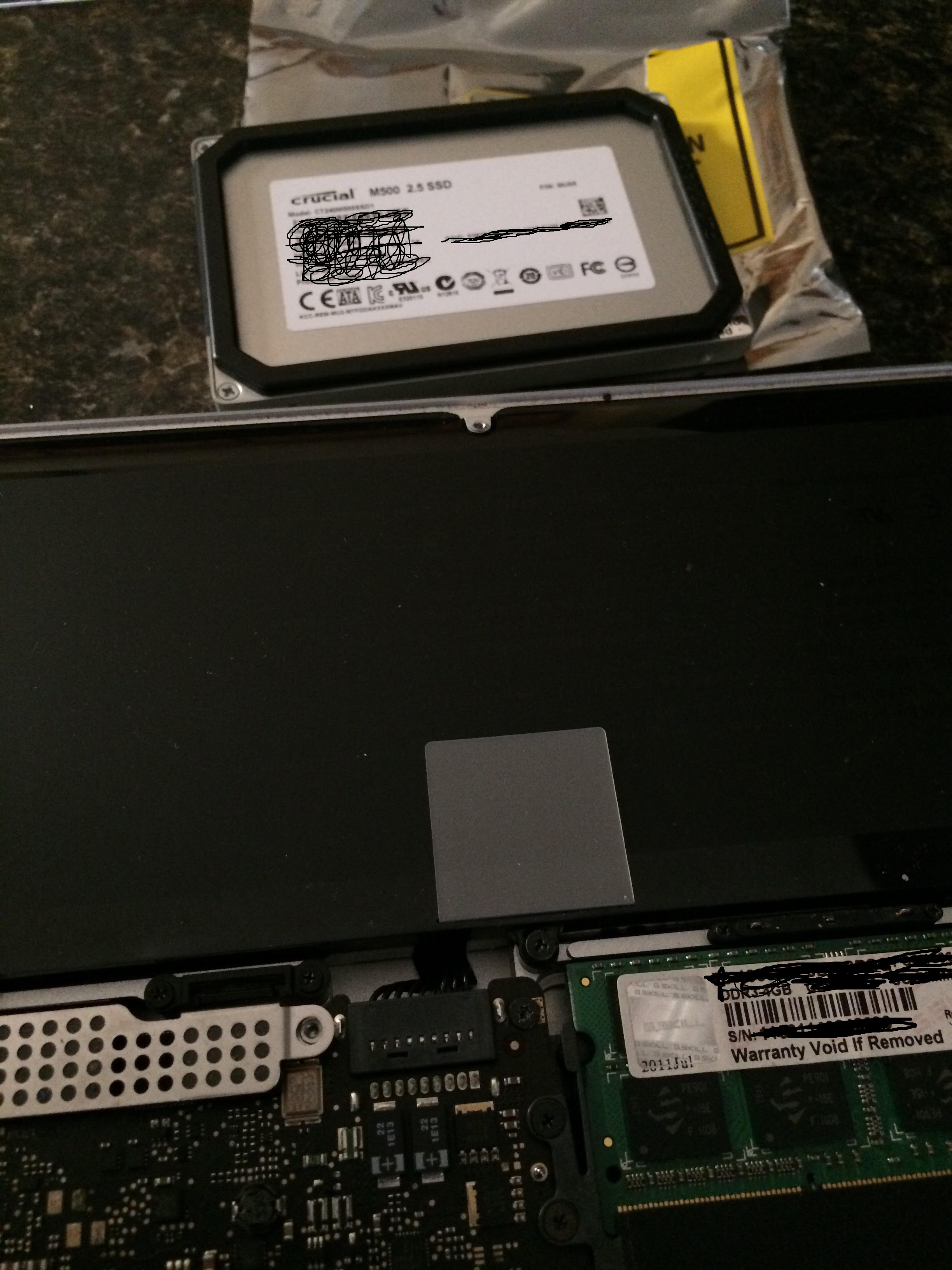

Update. They replaced the screen. I got he MBP home and began to switch the HD back to mine away from an extra. and i saw a screw missing... so taking back tomorrow and then hopefully ill be good.

That's good and bad news. I've seen MacBook Pro returned with none of the heatsink screws and springs attached. It was awful to see the amount of thermal paste they used.
