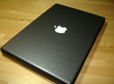

Not sure about manufacturing aspects of carbon fiber, but if carbon fiber more environmental friendly I can see apple can switch from plastic for future iPhones... hopefully it will be next generation.
I don't think you can just coat carbon fiber with aluminum, i think there are some problems associated with that.

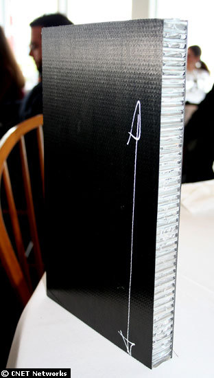

The way to achieve high strength with low weight is aluminum honeycomb sandwiched by carbon fiber. It's too thick for electronics casing, but works great for cars, aircraft and the like.
I might be wrong but from what I have understood Glare uses the fiber orientation for added strength, not honeycombing.
See for example here.
Each metal layer is between 0.2 - 0.5 mm thick. Since it is not suppose to be used in an airplane wing you might be able to reduce that even further.
This paper in material research states that all the layers make the Glare 1.8 mm thick.

You can simply PAINT carbon fiber, seriously. You can also give it a semi-clear color so that the carbon fiber shows through, and i've seen some carbon fiber stuff that has kevlar woven in for color, or colored material to create a different effect.
Though painting isn't easy, they used painted CF hoods on one of the special Corvette Z06s (Le Mans edition?) and it required a very special process for a low volume model. I would also think they might have concerns on painting a product like a phone or laptop where the device is exposed to more rough treatment than a car... in the sense that it is exposed to many different surfaces... will impact against them in many ways, durability of the paint might not be that great.
