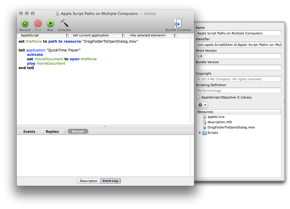

Look at the path to resource section here
Example :
Code:
set theMovie to path to resource "DragFolderToOpenDialog.mov"
tell application "QuickTime Player"
	activate
	set movieDocument to open theMovie
	play movieDocument
end tell
