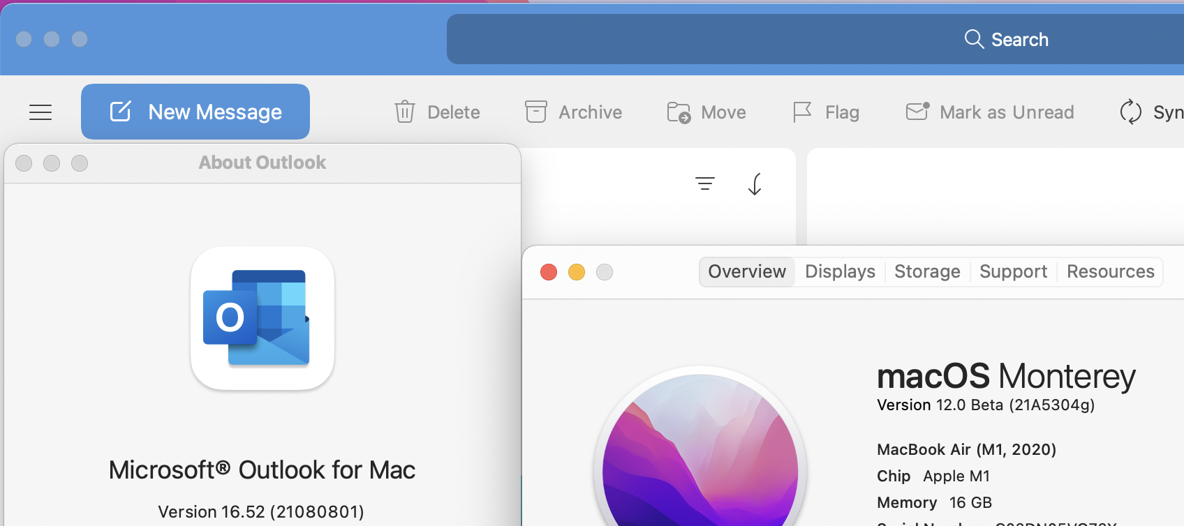

Outlook is working ok for me, I am not using the Outlook Beta version, running 16.52 on a M1 MBA.

Updated to Monterey 12.0 Beta (21A5304g) and Outlook 365 (from App Store) still works in "new Outlook" mode.
Killed Outlook for me too 16.52 keep freezing with the spinning wheel. I updated to the Beta Channel Version of Outlook (16.53) and it's working now. That other "New Style" of Outlook is not an option for me (It's horrible if you actually use Tasks)
