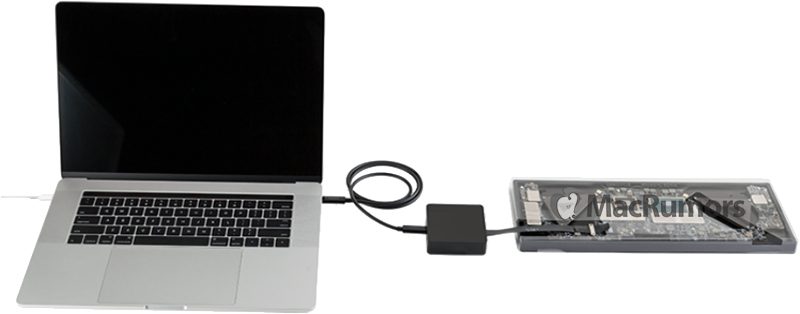

Apple has a special tool for 2016 and 2017 models of the MacBook Pro with Touch Bar that allows Genius Bars and Apple Authorized Service Providers to recover user data when the logic board fails, but the SSD is still intact.
The tool is essentially a little black box that is able to transfer data from a failed logic board to a functioning MacBook Pro. The box has a flex cable that connects to a data recovery port on the failed logic board, while the box and a functioning MacBook Pro are connected via USB-C to USB-C cable.
Apple's internal Customer Data Migration Tool

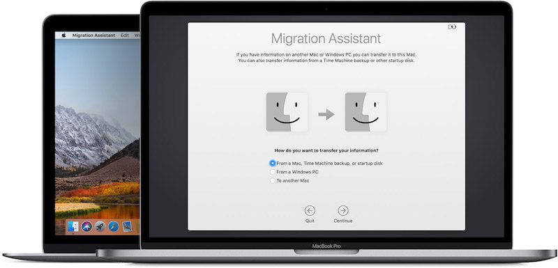

Once the logic board is placed into a special holder, and all cables are connected, technicians simply power on the functioning MacBook Pro, open Migration Assistant, and proceed with the standard steps for data transfer.
Customer Data Migration Tool connector on 2016 MacBook Pro logic board

Multiple sources claim that data cannot be recovered if the logic board has failed on a 2018 MacBook Pro. If the notebook is still functioning, data can be transferred to another Mac by booting the system in Target Disk Mode, and using Migration Assistant, which is the standard process that relies on Thunderbolt 3 ports.
