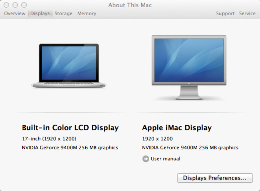

I took my 2009 24" LED Cinema Display in to apple this morning, they suggested that perhaps the display's logic board was damaged when they replaced the panel this week.
iMac appears in both the system profiler and system prefs>displays with no brightness scroll/Imac profiles, this appears on different machines connected to the display.
Before I took the display in I ran SwitchResX which showed the panel as: LM240WU6-SDA2 not coming up with much with that product # which is one number off the correct part #.
