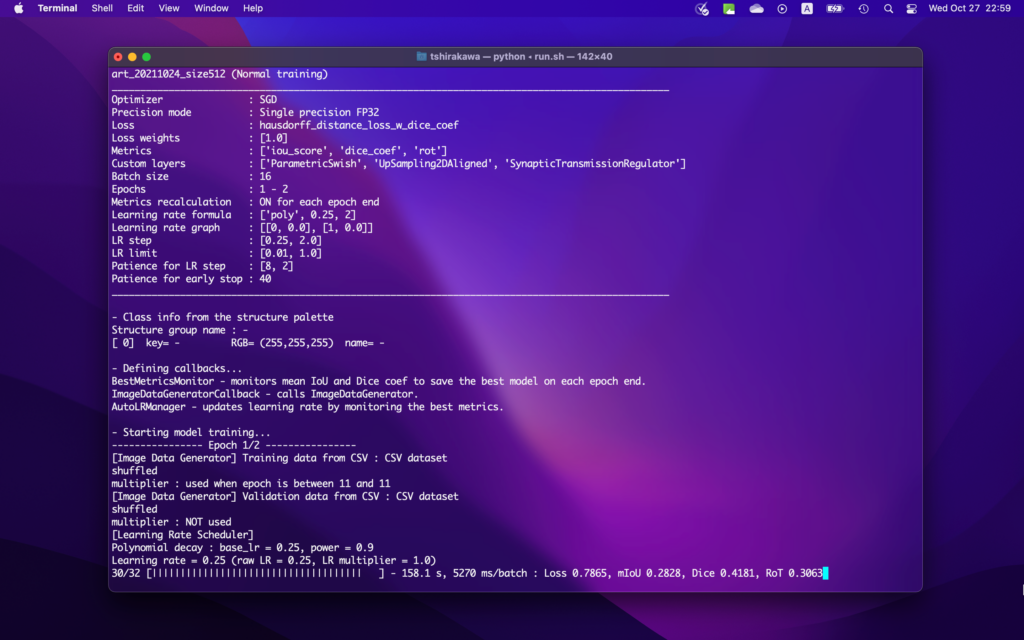

Hi. I tried a training task of image segmentation using TensorFlow/Keras on GPUs, Apple M1 and nVidia Quadro RTX6000. I also made an estimation of M1 Max (I don't have an M1 Max machine).
RTX6000 is 20-times faster than M1(not Max or Pro) SoC, when Automatic Mixed Precision is enabled in RTX...
I posted the various results in Medium.
