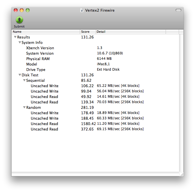

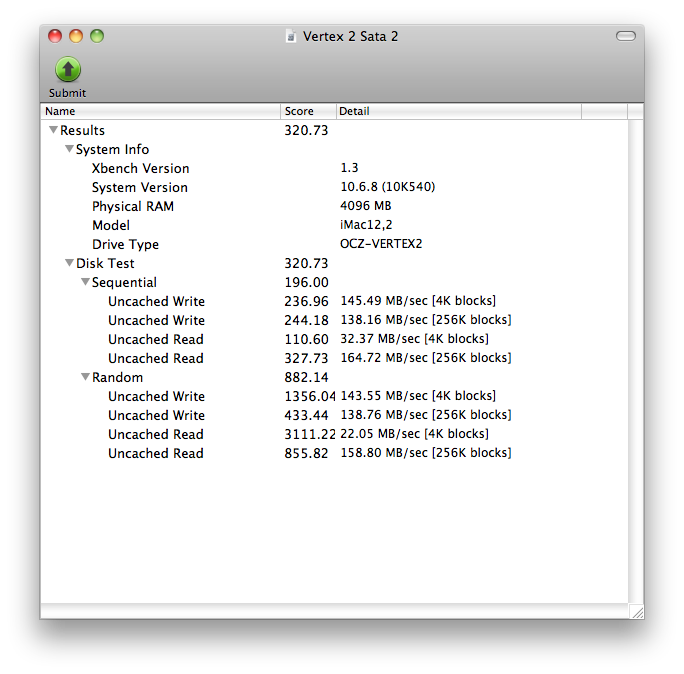

I bought a Vertex 2 for my 2011 iMac. Before installing it I used it in a Firewire 800 enclosure to try it out, starting from it and having all applications on it.
In the FW-enclosure speed is limited to 60 Mb/s sequential and 4k random read to 11 Mb/s. Inside the iMac sequential speed is above 200 Mb/s and 4k random read 22 Mb/s, so twice as fast at least.
In day to day operation, starting the computer, applications and during usage, I can't tell the difference whatsoever. Everything starts instantly no matter where the SSD is. System startup is probably a little faster internally but I don't "feel" the difference.
Thus my guess is that the Apple SSD will feel just as fast and perform only marginally slower in real world usage. I choose to install my 180 Gb SSD because of cost, it cost me less than 200 € instead of 600 € for Apple 256 Gb.

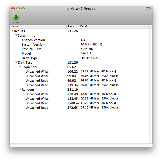

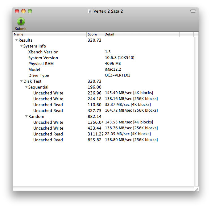

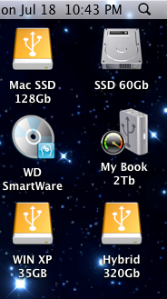

Hi,
wrong again, as you can see, I have also 3 external HDs, 1 of them being ANOTHER SSD,
and its as hot as the hybrid external next to it...
