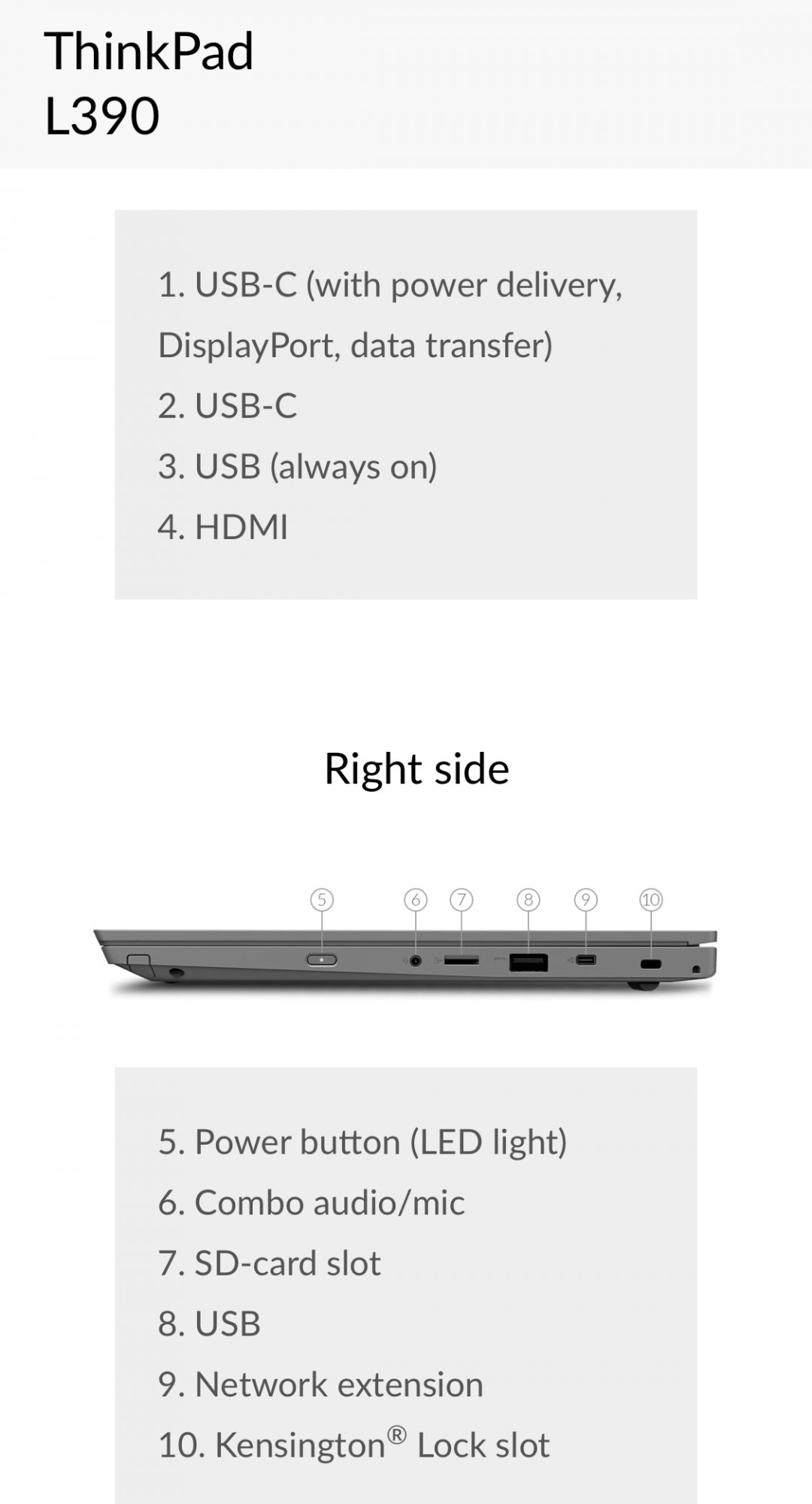

It’s a Lenovo Thinkpad L390
According to their website:
USB-C (with power delivery, DisplayPort, data transfer)
It should work, but likely not with the cable that ships with it. This cable and other USB-4 cables should work (technically also a USB-C 3.2 cable, but for the extra few $, I suggest “future proofing” your cable).
