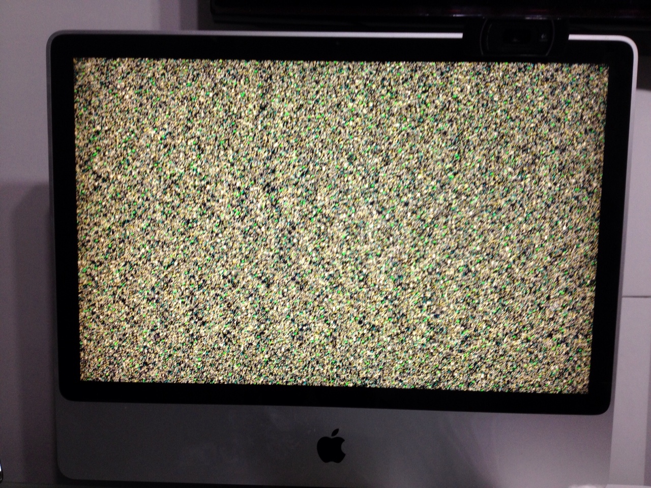

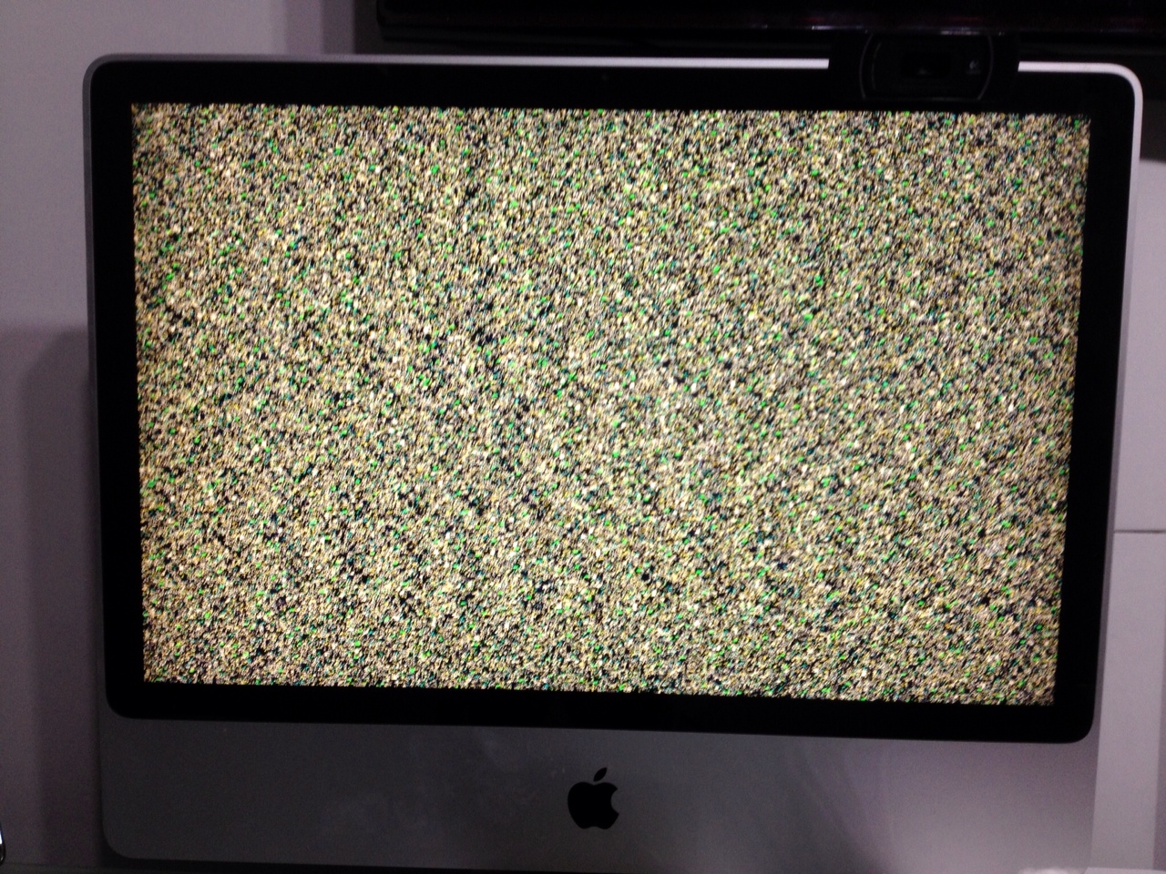

Maybe not, but they're sure P'ing me off lately. lol. Earlier i was lucky enough to get this.. 😡
That's not the HD, that's definitely a defective video card.
Don't even bother messing with/replacing the HD. It's wasting your time and money.
Go to the Apple Store. Bring that picture with you.
To check if its the hard disk, move the whole disk contents to an external drive, using the free Super Duper. And then boot from that external drive. Be aware that the drive's ccontents will be entirely deleted when you copy the disk data to the external drive. Its not a bad idea to back up anyway, before it goes to repair.
Also, check that the machine is not hot. That can upset a video card. Check that all the cooling gaps, top and bottom etc, are there. And download a fan and temperature reading program, such as smcFancontrol, to check your cooling fan speeds and your temperatures.
How could anyone, after looking at that screenshot, think it's anything else but video? What fault in processing, storage, or anything else would cause a classic display of static like that? Nothing. Static is simply a visual representation of signal noise, peaks show bright, valleys show dim. This problem DEFINITELY exists between (and including) his GPU and his screen.
