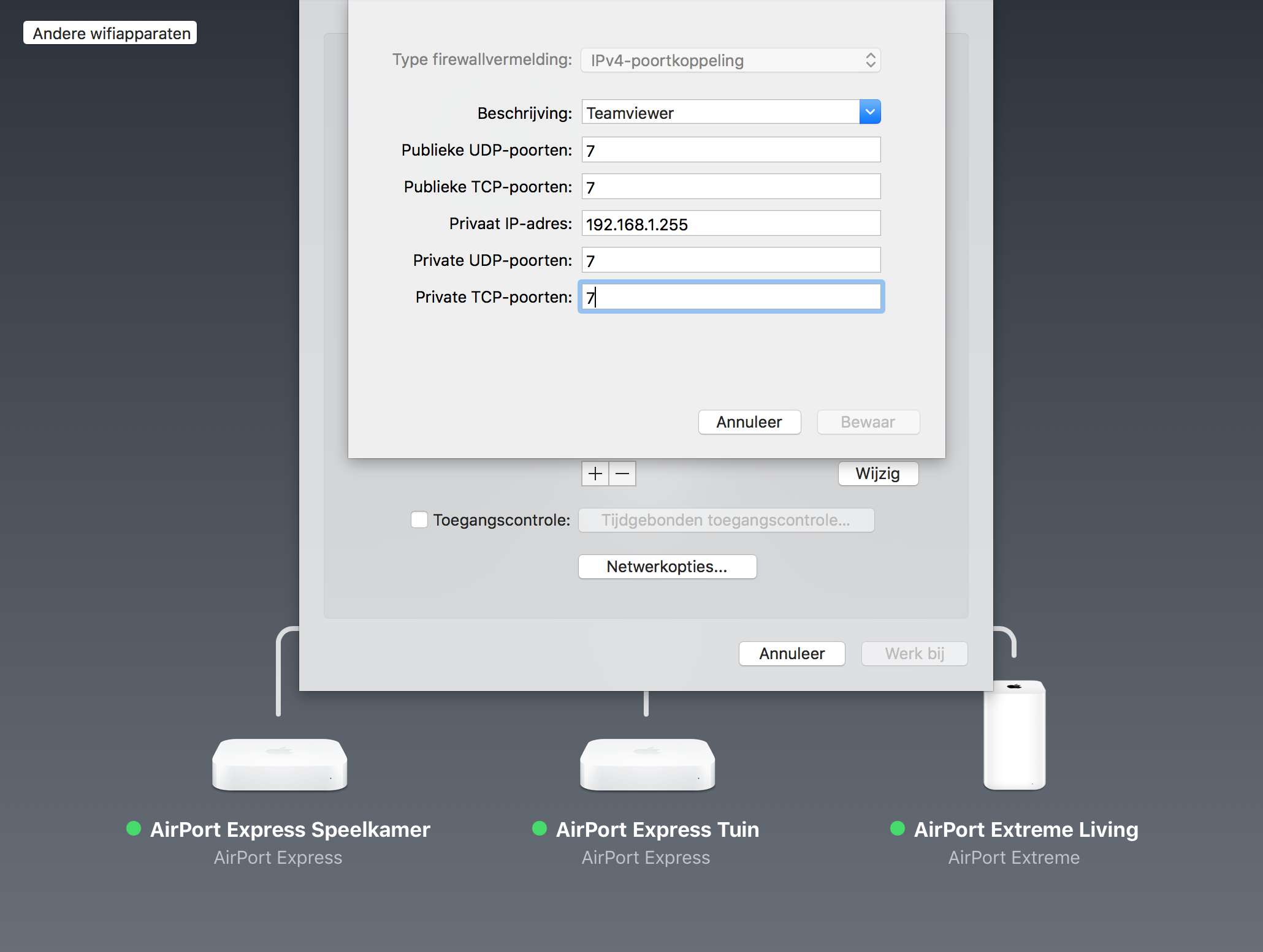

The second option isn't possible with my configuration. The broadcast address is 192.168.1.255. But when I fill in 192.168.1.255 as the private adsress, I can't confirm (it is gray - see the picture in annex). What am I doing wrong?
You have to enter a give device's IP address there; you can't use the broadcast address. So, if you want to forward the port for something to do with your PC, put your PC's IP address there.
I do that, and it works for 15 minutes. But, I have the impression that the Time Capsule forget that the specific mac-address (which I want to wake op) corresponds with the IP address (which I reserved by the DHCP reservation).
So, I found on the internet that a possible work around would be to use the broadcast address. When you forward the magic pakket to that, the broadcast address sends it to every machine in the network. But only the machine with the correct mac address would respond to it. Then you don't have the problem that the Time Capsule forgets the IP address.
