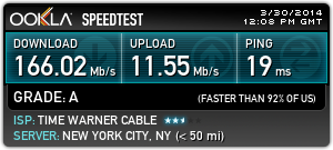

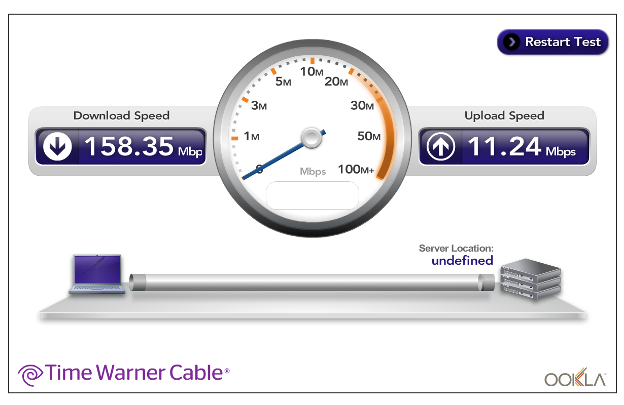

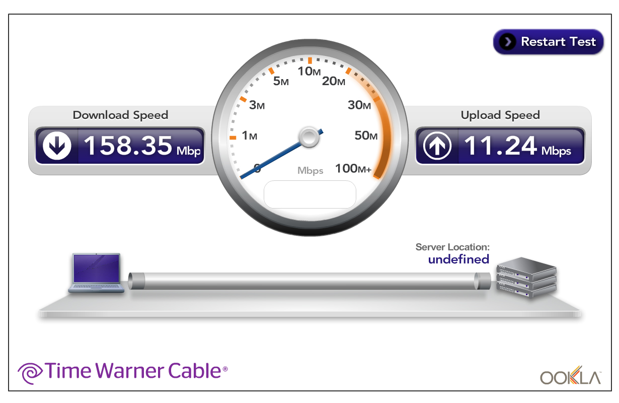

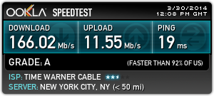

So I purchased the wrong router. Last week I bought the TP-Link TL-R470T+ which is 10/100. I need a Gigabit load balancer. I returned the router to Amazon and I have the TP-Link TL-ER5120 arriving tomorrow. The goal being to combine two cable modems to achieve +200Mbps down 11Mbps up with load balancing.
I setup the TP-Link TL-ER5120 load balancer.
1st WAN 100MB/5MB
2nd WAN 50MB/5MB
These are my speed test results.
